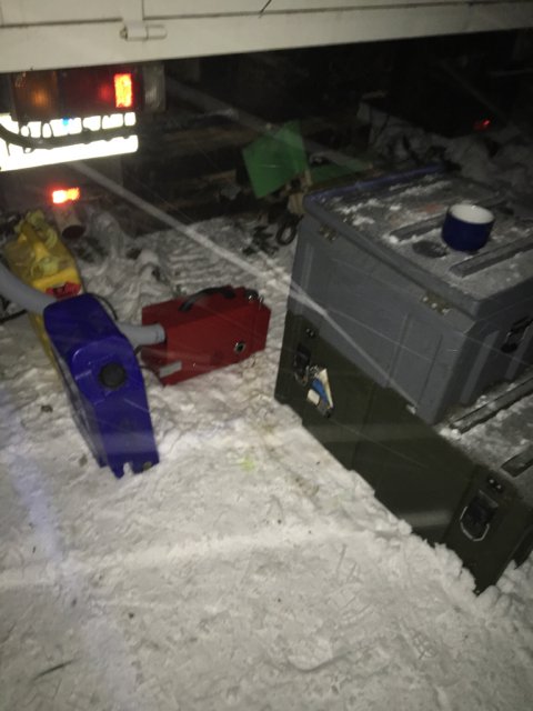

There is a slim possibility that my softy bedroom heater may double up and warm the tank below, lol :-) : http://www.nissanpatrol.com.au/forum...017/08/279.jpghttp://www.nissanpatrol.com.au/forum...017/08/280.jpgSerious concerns though for midway mounted steel lift pump though :-(
http://www.nissanpatrol.com.au/forum...017/08/281.jpg Zero snow on the whole tray canopy warmish area maybe?
