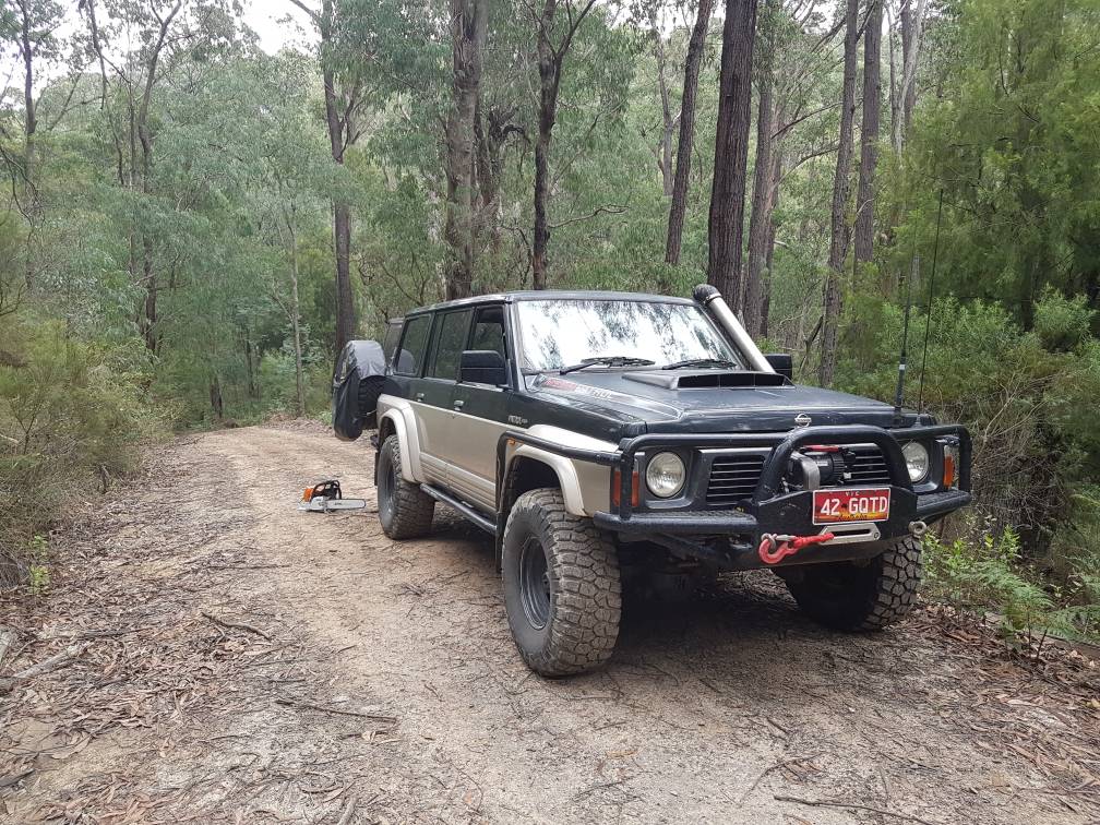

Took the roof rack off for the first time, looks heaps better without it. Didn't realise how bloody heavy they are! Then took it for a little local drive, looking for good firewood spots.

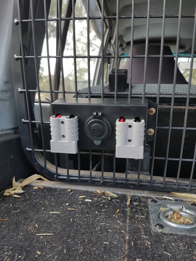

Replaced the dodgy cig lighter sockets i had in the cargo area with these babys. http://www.nissanpatrol.com.au/forum...017/04/117.jpg
