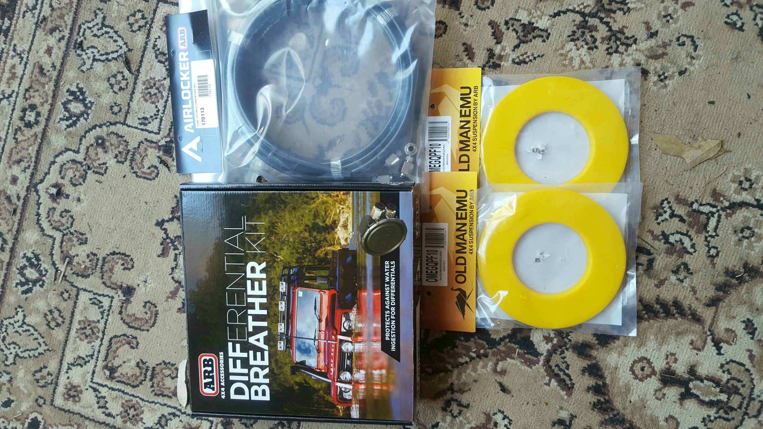

Coil spacers/insulators- you can get these for both top and bottom. The bottom ones are only thin as the coil is retained differently to the top. You dont want anymore than maybe 10mm on the bottom of the coil. Placing one at the bottom is more for noise reduction. Factory they only come with insulators on the top of the coil.
