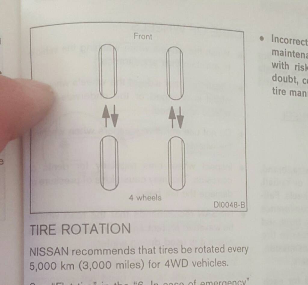

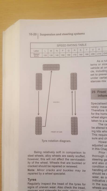

Gonna rotate the tyres as it's time. Is this the general rotation to follow on a 4x4 ...
http://www.nissanpatrol.com.au/forum...016/03/307.jpghttp://www.nissanpatrol.com.au/forum...016/03/308.jpg
Makes sense mate. I got 5 identrical rims and tires. And every manual I check shows something different.

I just move mine around the car in a clockwise pattern. Do this every 5000km. I netted nearly 100k out of the last set doing this.
All rotated, I'll stick to Matt's rotation every 4-5k from now. Front hubs have severe corrosion, once again shows the car has been dipped in the ocean plenty... Went out and got the rest of the oils but will run out of time today. Next weekend, which will also be time to re-flush the rear diff.
