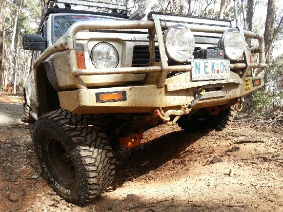

I have a lot to update but a bit busy at the moment but just wanted to mention that the rear bar I have made has stood up to its first real test..
At Brindabella while we were negotiating a really tough down hill rock ledges my rear bar landed hard on a rock ledge and came through unscathed..... my welding has held up so far!!!!!!
I am proud of myself....!!!

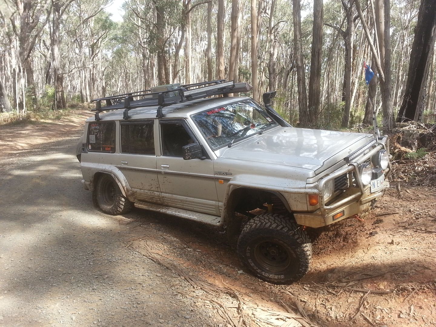

So how do you find the suspension offroad?
Suspension is brilliant... I am worried about not having the correct bump stops and need to get onto that soon.
I think Andy wants to change his set up partly from watching how much flex I get now.
Nothing troubles me specially with the front locker... I know in the past there were tracks we did that would have given me a real hard time and with the locker and the amount of suspension travel I get I need not drive like I stole it which in turn hopefully means less stuff breaking.
I have still not gone out with the 35's on where clearance might be an issue to see how all that goes.... soon I think!!!

Surprisingly I did not see Johnny flexed up much at all. It's like with his old setup he needed to flex his muscles, but now everybody knows he has them so he need not show off.
OME shocks with Dobinsons springs 4inch.
Tough dog Panhards, superior drag link, patrol docta lower control arms, extended sway bar connects,drop boxes... and other shit!!!

I just realised that those 2 photos are with 3 inch but with my new 4 inch shocks??
See if I can find a pic with all 4 inch...heh funny!!!!
Isn't it 3" springs with 25mm spacers or did we take them out ?? Can't remember......
