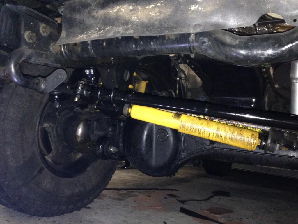

Drag link arrived today, just in time for the long weekend.
I think I have the ends sussed out with regards to which one is the gu tie rod end using the P/N off them, but is there a very simple way to check?

You can check the angle where it fits into the stub axle and i think the length is deferent between gq and gu not sure on the thread tho.

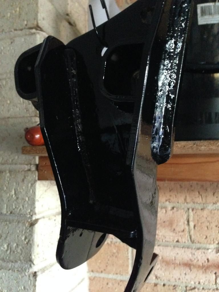

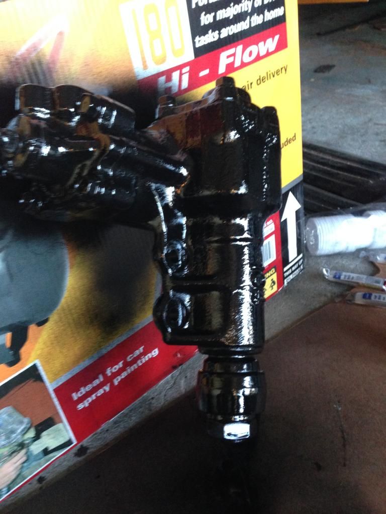

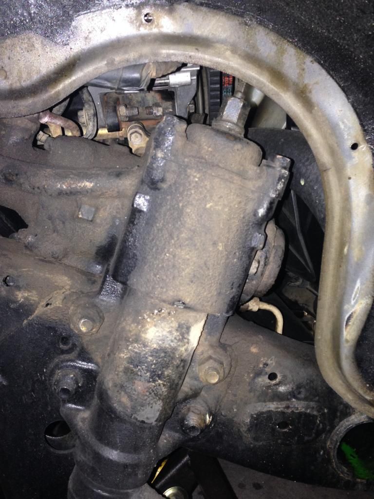

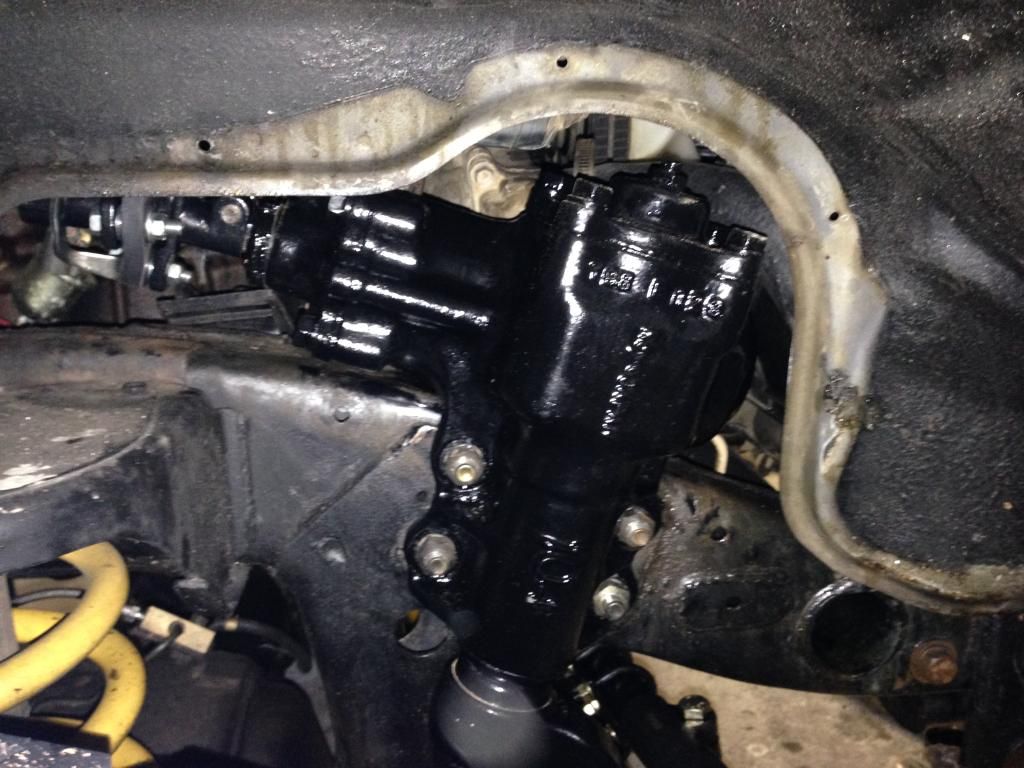

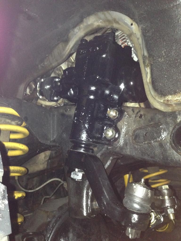

Wire brushed the bracket and steering box, degreased them, treated them with metal ready then coated them with some seriously glossy paint called Rust Not Epoxy Paint.
Will fit them in the next few days hopefully.
http://img.photobucket.com/albums/v9...54BDE3DBBE.jpg
http://img.photobucket.com/albums/v9...03E56E2FD7.jpg
http://img.photobucket.com/albums/v9...CB0EE80455.jpg
Old steering box vs new.

New drag link

Front main seal has made a bit of a mess of the front end. Corrosion proofing.

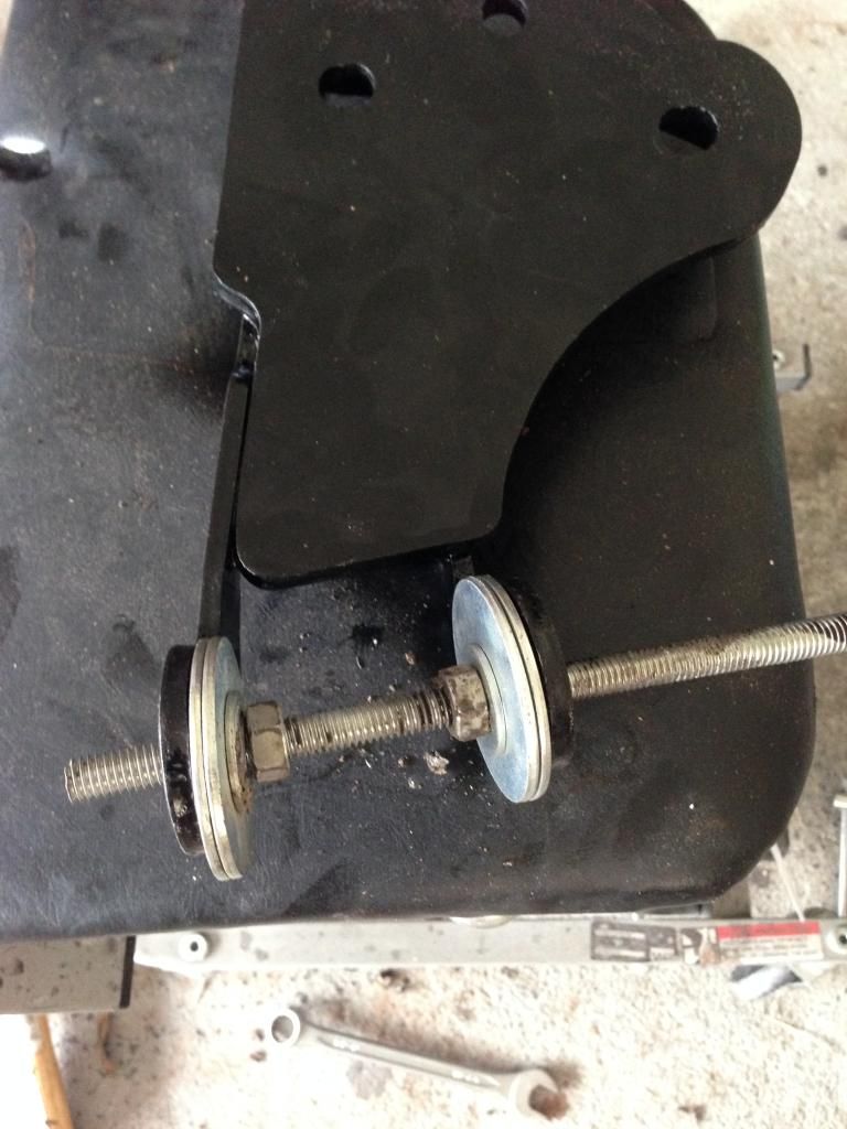

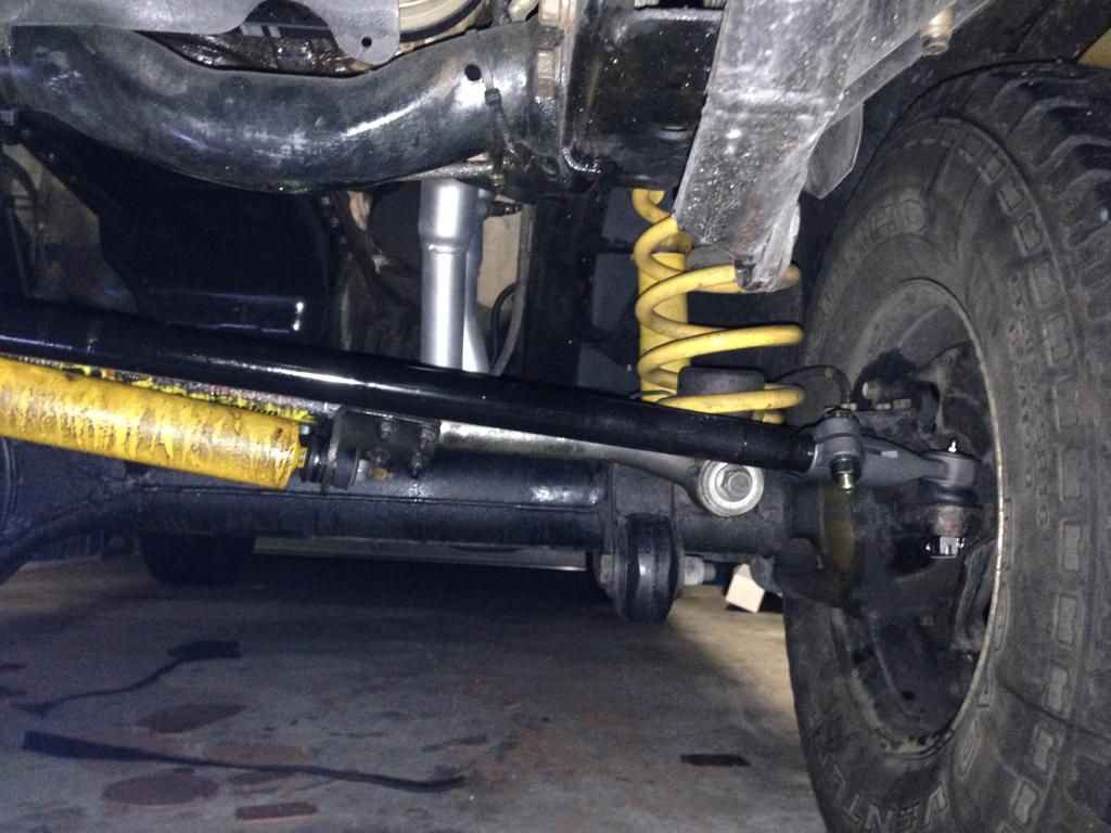

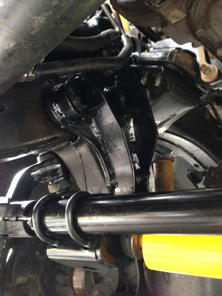

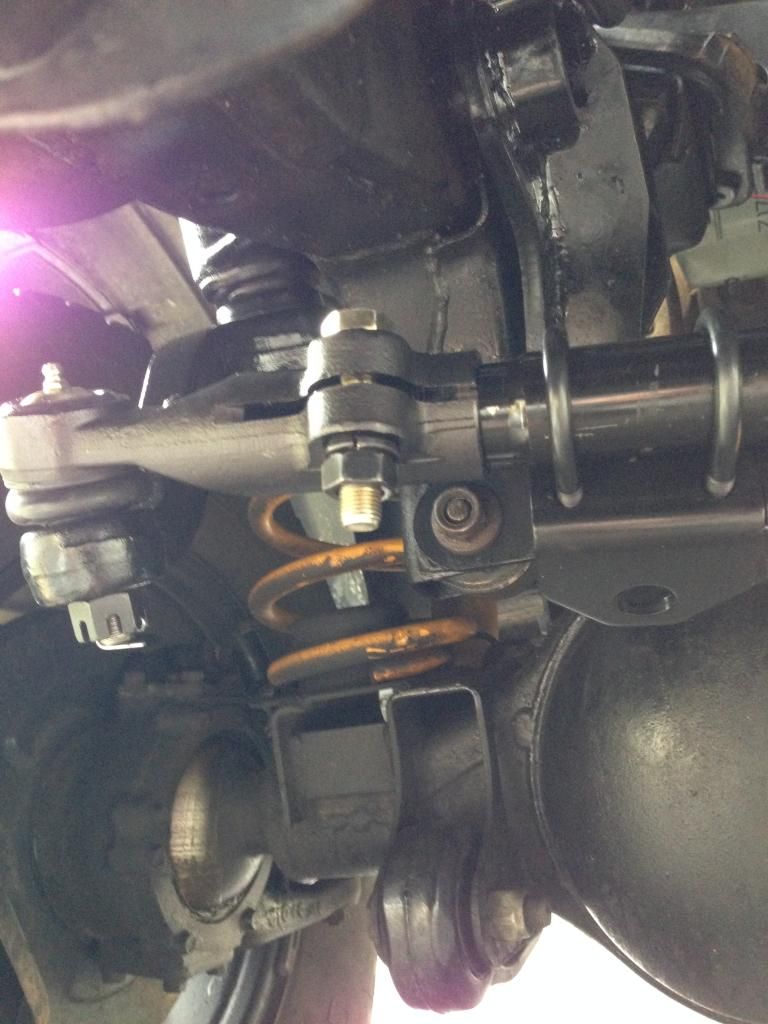

So I had dramas fitting the panhard mount brace. I believe it only fits on patrols with the old style mount which is thinner (I'm guessing). But a quick measure of the mount and I was able to easily adjust the brace to suit...
http://img.photobucket.com/albums/v9...AB05754299.jpg
Fitted
http://img.photobucket.com/albums/v9...014DD972B1.jpg
http://img.photobucket.com/albums/v9...3D6F16F1A9.jpg
http://img.photobucket.com/albums/v9...A4AACFA18F.jpg
I also adjusted the steering box, adjusted the drag link so the steering wheel is centered and made sure the damper is centered properly. Steering is nice and tight and very direct.

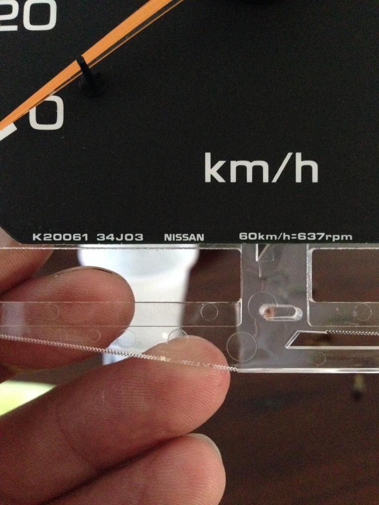

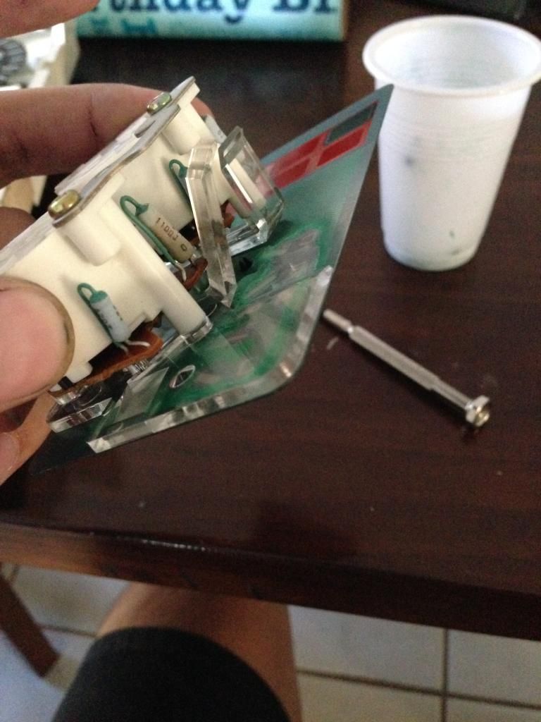

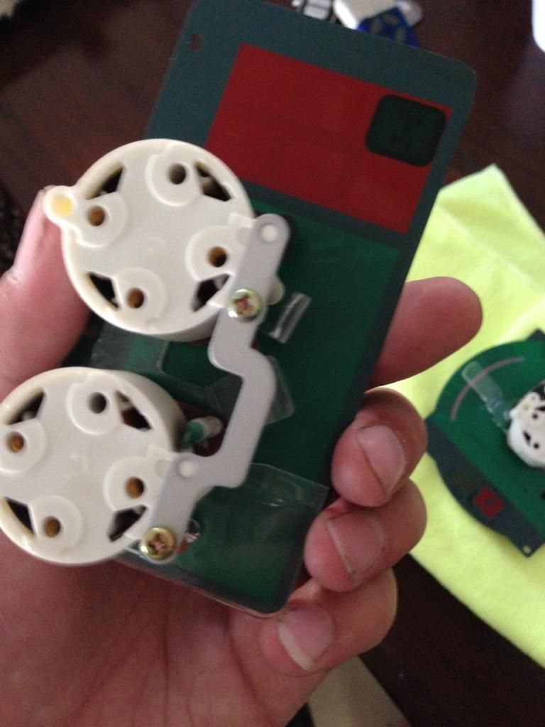

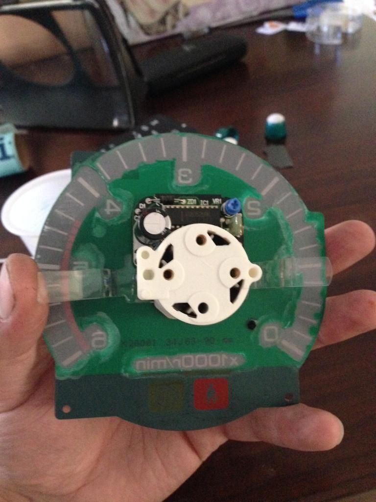

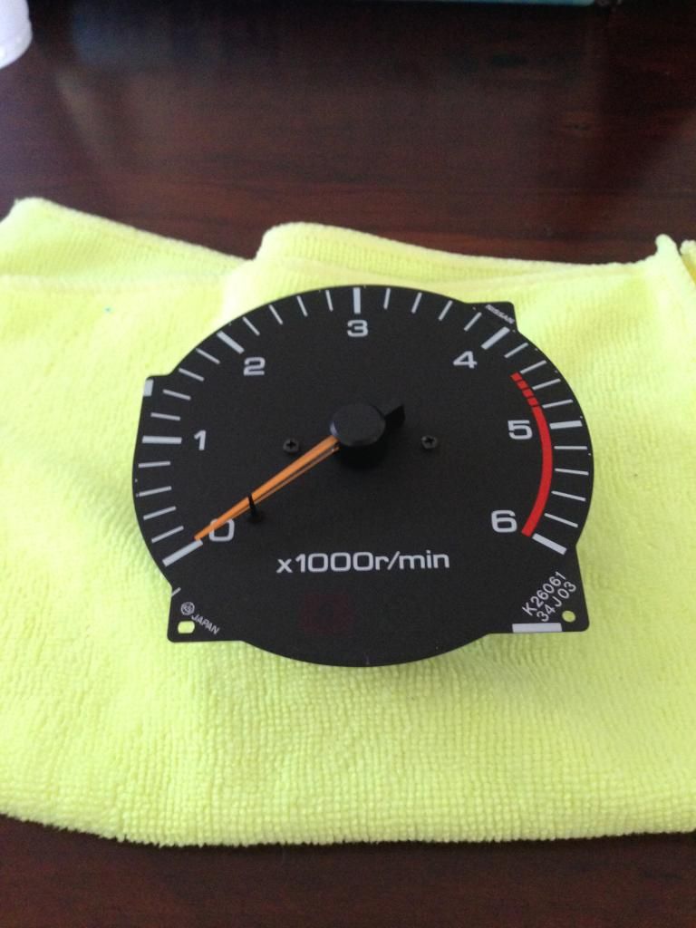

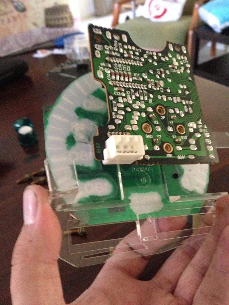

Played with the gauge cluster.
http://img.photobucket.com/albums/v9...6C5659CBDB.jpg
http://img.photobucket.com/albums/v9...30408E76B4.jpg
http://img.photobucket.com/albums/v9...03A189196C.jpg
http://img.photobucket.com/albums/v9...D0510522C8.jpg
Using my wife's nail polish remover and cotton tips I was able to remove the green tint.

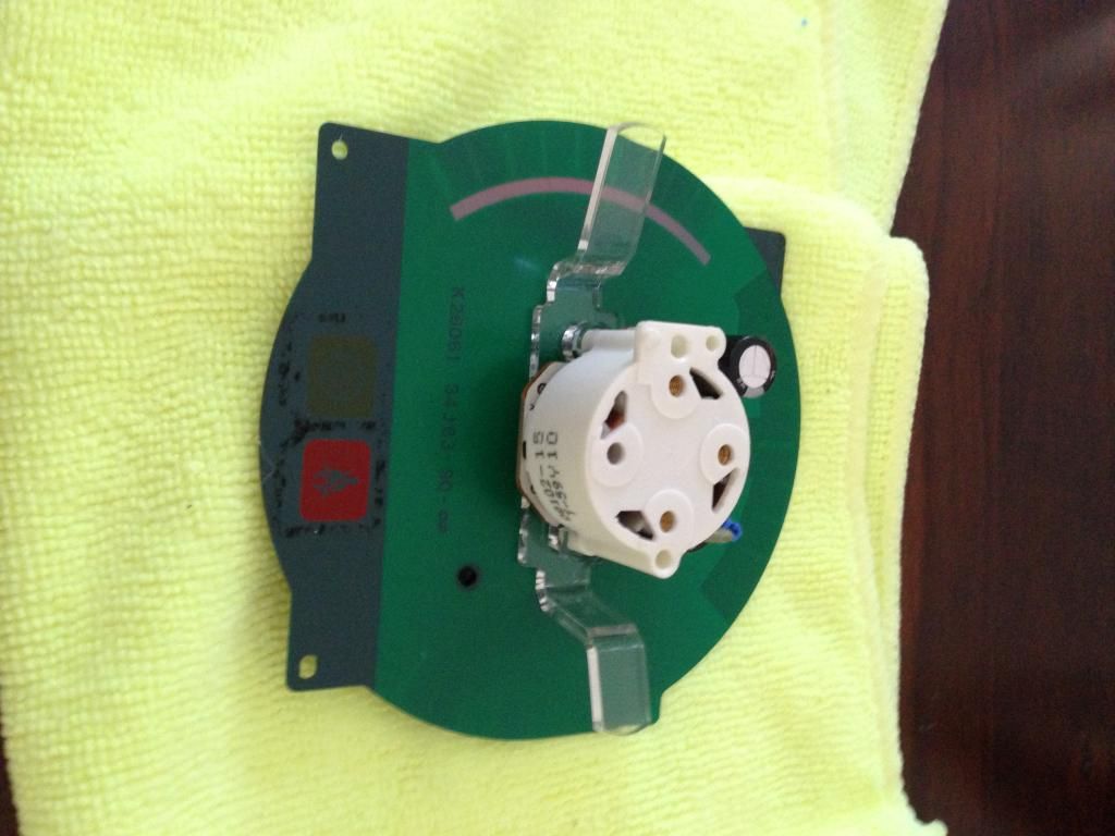

Interesting...
http://img.photobucket.com/albums/v9...F4657FDA36.jpg
You can see the symbols and the temp High got missed. The actual symbols are hard to get to so I will leave them, but the High will need to be sorted.
I also removed the green tinted covers that went over the lights themselves, but I think these played a part in dispersing the light evenly and you can see in the pic that it's uneven(looks worse in pic) so might put these back in and see if it adds any green to the light.

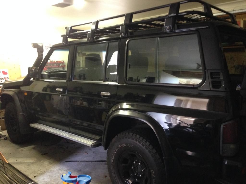

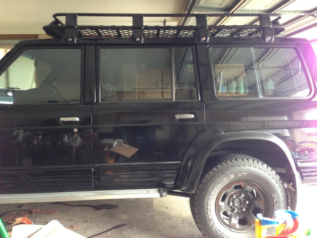

Patrol is sporting its roof rack again.
http://img.photobucket.com/albums/v9...558C31747C.jpg

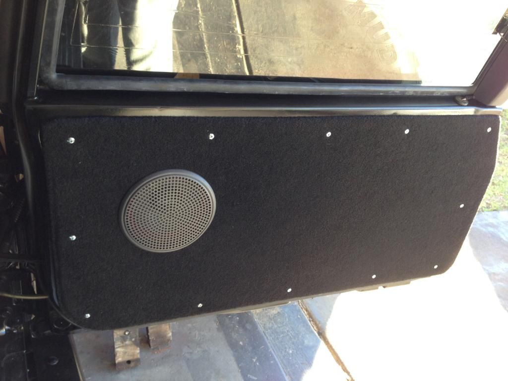

Put the large plastic what ever the hell they're called things back on the bottoms of the doors. I like em.
http://img.photobucket.com/albums/v9...AF818162FE.jpg

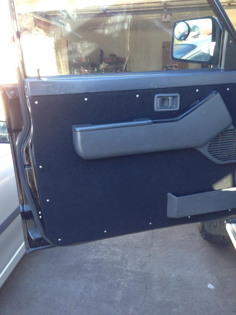

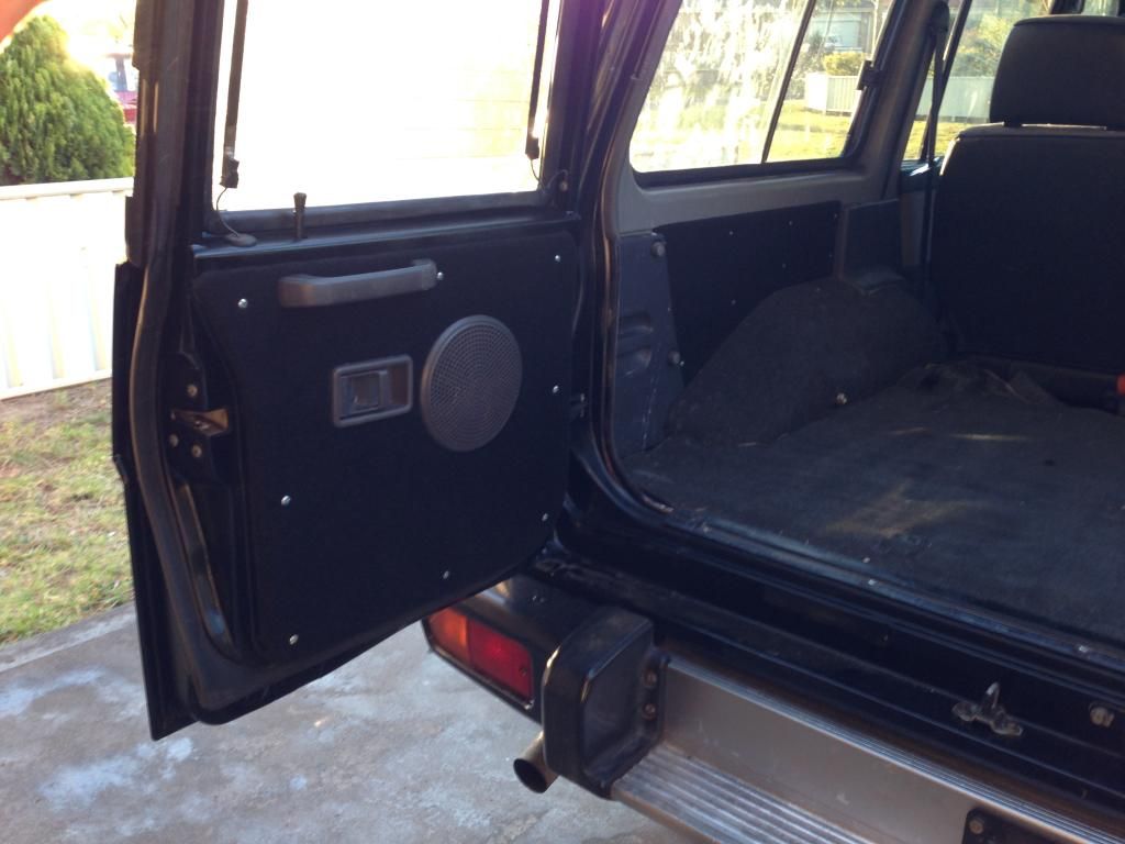

Passenger door done, large barn door done.
http://img.photobucket.com/albums/v9...0068CC23E0.jpg
http://img.photobucket.com/albums/v9...78FE29464B.jpg

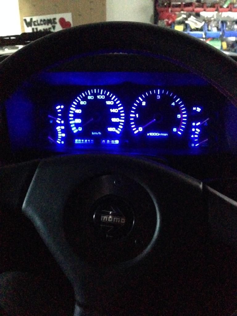

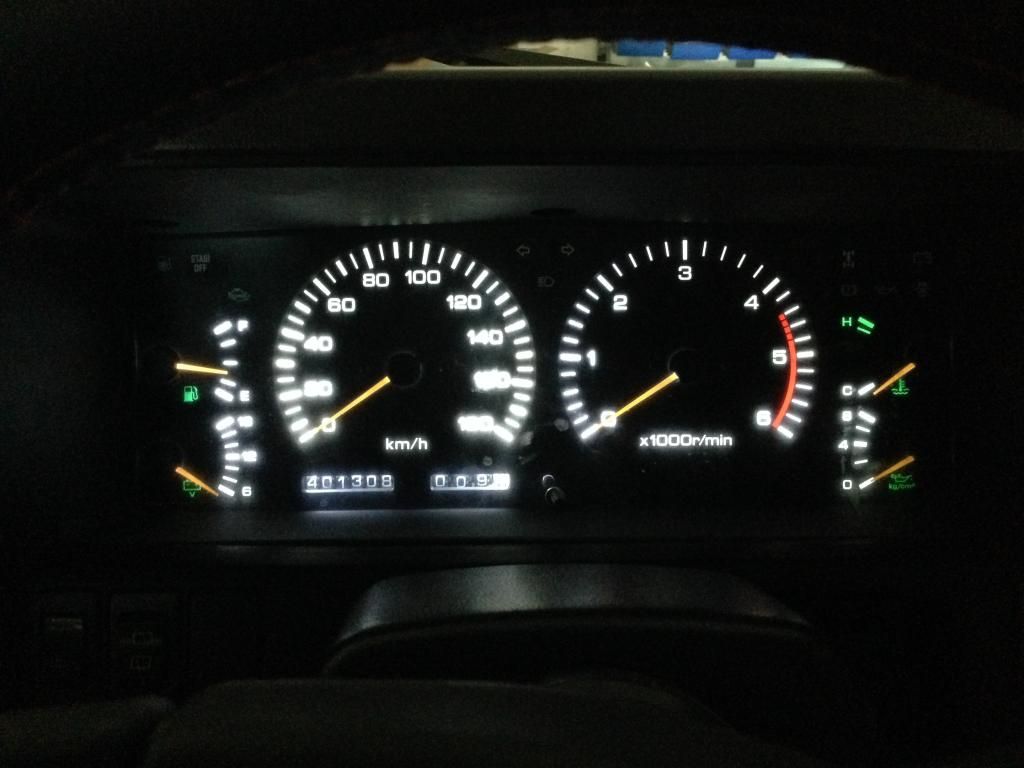

Playing with LEDs
http://img.photobucket.com/albums/v9...DA8DE5D9D6.jpg
Are you able to dim the leds, Parksy?
Yep dimmer switch works well with the LEDs.
So the leds just plug into the light socket, or have you had to convert them?
The dash back lights are just t10 globes. So grab some t10 LEDs and plug them straight in. If they don't light up, switch the polarity around and you should be good.

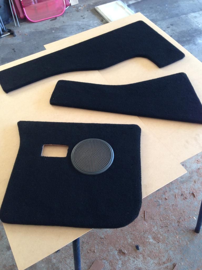

Did some more interior construction.
http://img.photobucket.com/albums/v9...4FE43AA8DF.jpg
http://img.photobucket.com/albums/v9...7CDFE4A7DC.jpg
http://img.photobucket.com/albums/v9...98FE6DD3C1.jpg
