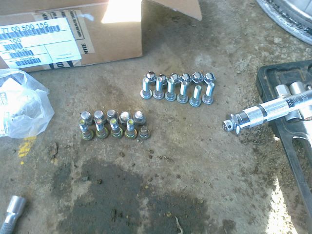

today i did buy all 24 new wheel nuts and six new screws on wheel that fall off.one screw did brake,and two where bend,but i will replace them all 6...

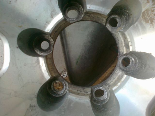

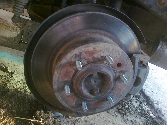

this is my lost wheel with eaten holes
http://www.nissanpatrol.com.au/forum...2012/12/52.jpg
http://www.nissanpatrol.com.au/forum...2012/12/53.jpg

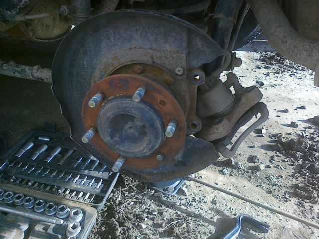

new parts
http://www.nissanpatrol.com.au/forum...2012/12/54.jpg
installed
http://www.nissanpatrol.com.au/forum...2012/12/55.jpg
tightned at 14Kgs

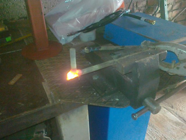

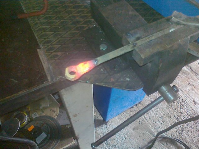

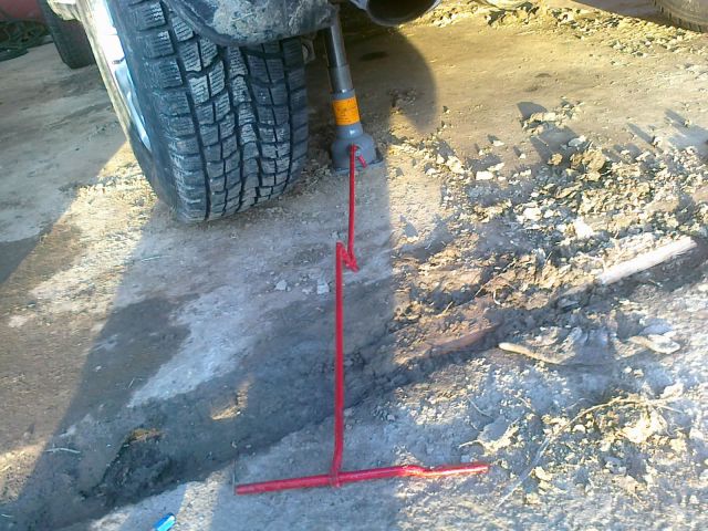

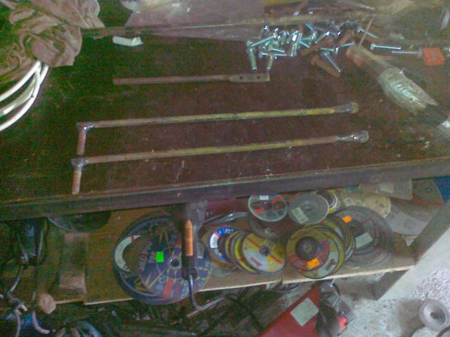

i also made new..what is the proper word..hand bars?originals i lost somewhere in bush..
http://www.nissanpatrol.com.au/forum...2012/12/57.jpg
http://www.nissanpatrol.com.au/forum...2012/12/58.jpg
http://www.nissanpatrol.com.au/forum...2012/12/59.jpg
this time red color,so that i see them better,and not forgot 'em
