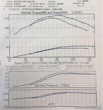

Little budget Holley lift pump finally installed yesterday Gents on ‘Old Grandpa Spec Ute’ and can’t thank ya’ll enough again[emoji120][emoji120][emoji106][emoji106]
Your tired injector pump advice must have been on the money as I’ve thankfully regained another half a gear to finally get back up over the top of the hills home in 4th again just holding dealer mini max 8psi Safari turbo just on [emoji322][emoji898][emoji106][emoji106]
So a quick history for myself too, same hill prior to replacing injectors was off turbo in 3rd and was worried that I might need to grab 2nd but just made it over.
Dyno tested after replacing injectors which clawed back half a gear yet had still dropped 12rwkw in 12 months since last run with then aggressive mud terrains/same diameter so in theory the loss was much higher found with now all terrains on.
At a best guess I’d estimate that you’ve thankfully got it back up over the 60rwkw mark and that’ll do us just fine for now Legends[emoji123] [emoji123][emoji106][emoji106]
EDIT: For honest clarity should’ve added that the last two days in our valley home have been the crispest/coldest air all season but as diesel helpful seasonally known that’s at best 1/2 of new little lift pumps increase thankfully found.
Most noticeable is returned speed of acceleration on the valley flats is almost back but still running a further half a cog uphills tired IP than 12 months ago.

Safari dealer whopping turbo tops 8psi snail trail as per above again:
http://www.nissanpatrol.com.au/forum...021/08/170.jpg
Poor old fella was once proper cooked (head replaced) before my time at the helm these days [emoji120][emoji106][emoji106]
