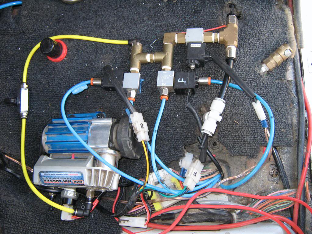

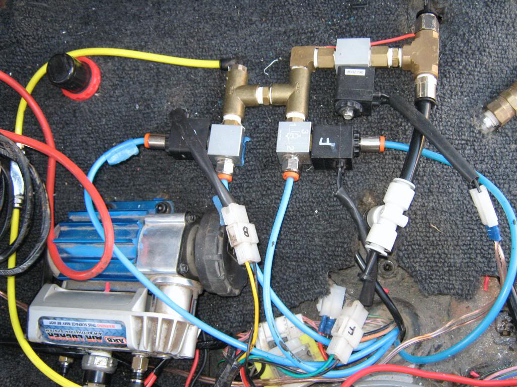

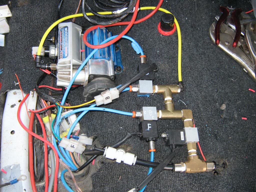

The air system i did while i was building it includes 2 fire extinguishers that i have no pic for but they are mounted under the rear drivers side seat.
The Big Boss compressor is mounted in a custom box on the rear drivers quarter and all the air lines are pvc pneumatics with push fittings.
http://nissanpatrol.com.au/images/St...g?t=1280304701
I used ARB diff lock solenoids switched at the centre console to operate the air system
you can see the red low pressure valve to the left side there. that is controlling a low pressure system to the Winch and Gear box to help keep the water out in a bog hole.
Excuse the labels, i have not got around to finishing that but i have the technology but not the time.

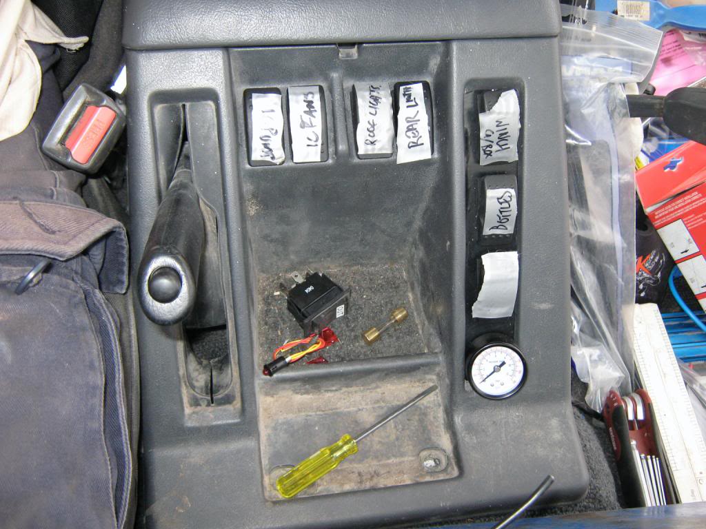

Just a quick one, whats the bottles switch for in that last pic?
Love the winch controls, well done!
The bottle switch is to isolate the storage bottles from the air system so when pumping up tyres or using lots of air somewhere i dont ahve to fill my bottles. When pumping up tyres i need to change my valve over to one that holds air when not in use so it will charge the bottles when i am moving tyres and then the bottle will help with a quick burst. Bt basically i am pumping 35s so 2 bottles or 5 odd litres of extra volume just slows things down.
And obviously they are in the back ground and are actually in the centre console, but look a bit strange in that pic...LOL. Check the pic higher for the switch in the console.
