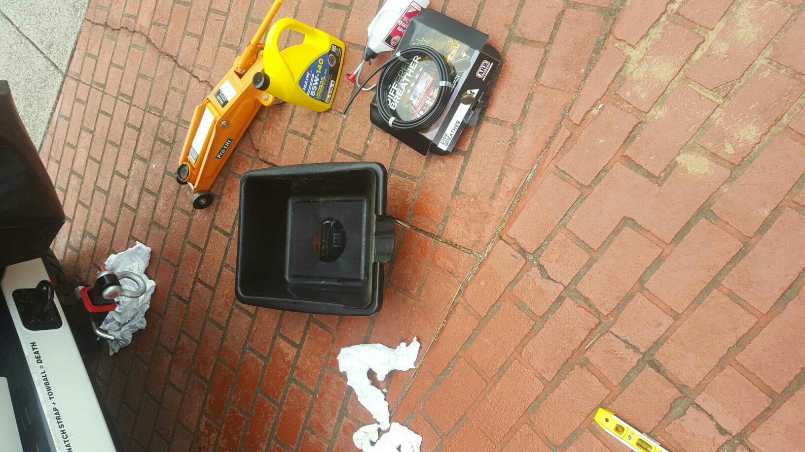

About to find out the state of milk shake in the diff http://www.nissanpatrol.com.au/forum...016/03/284.jpg
15 minutes in and the drain plug isn't playing nice ... Breaker bar bending , any more force and i'm worried I'll strip the square hole and then i'm really up shit creek.
