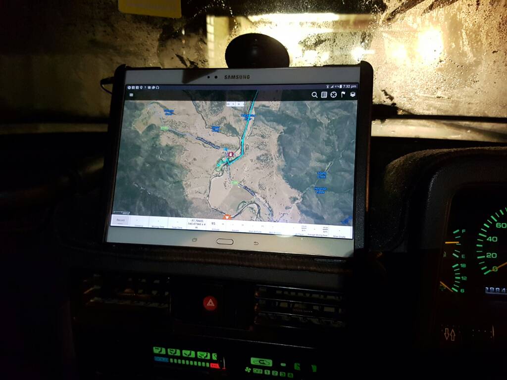

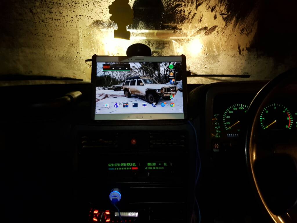

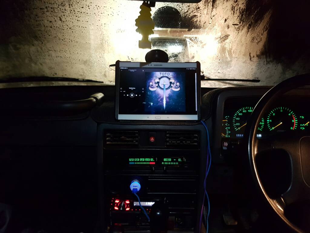

After seeing the tablet setup @Winnie had a Licola I grabbed myself a tablet & ram mount setup. Chucked in a 64gb SD card, downloaded the Hema maps & got a Telstra 4g data share sim card that links to my phone data.
Awesome setup! Can't wait to test it out properly. Also, it doesn't bloke my vision for those wondering.

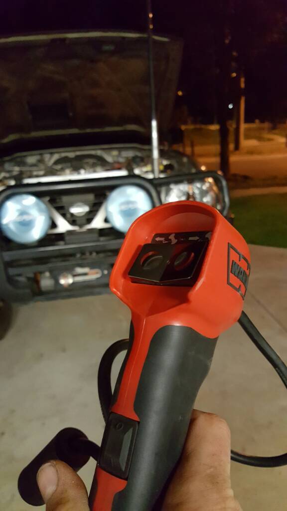

Anyway I drove over my warn winch control several months back now. Plus my winch has been intermittent at best so I picked up this remote cheap on ebay.
http://www.nissanpatrol.com.au/forum...016/08/147.jpg
Problem was its for a warn powerplant winch/compressor combo so the pin out was all wrong and it apparently has a thermal cutout. Well after scouring the web found a wiring diagram and eventually managed to suss out the correct pinout. Cut the old plug of my smashed controller and connected it to the new one. Works a bloody treat.
While I was at it I replaced my old 4 warn solenoids (most likely the intermittent issie) with an Albright solenoid.
