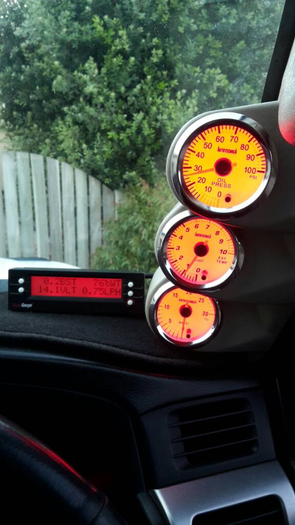

On an up note gauges are in and good..
Still yet to connect boost as I'm not sure what avenue I'm gunna take..
Thinking a barb tapped into the side of the intercooler front tank would be best. Catch pressure at the cool end..

Bloody hell.. pictures!!!
The gauges are not as orange as pictured. More red like the scangauge..
But I may swap to a duller colour for night driving..

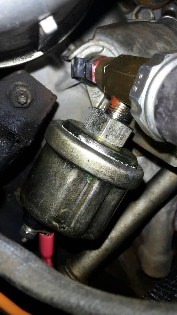

And the wicked oil T from vdo.
It's a barb one end and threaded the other and bottom..
