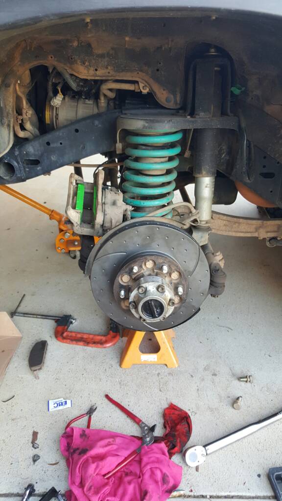

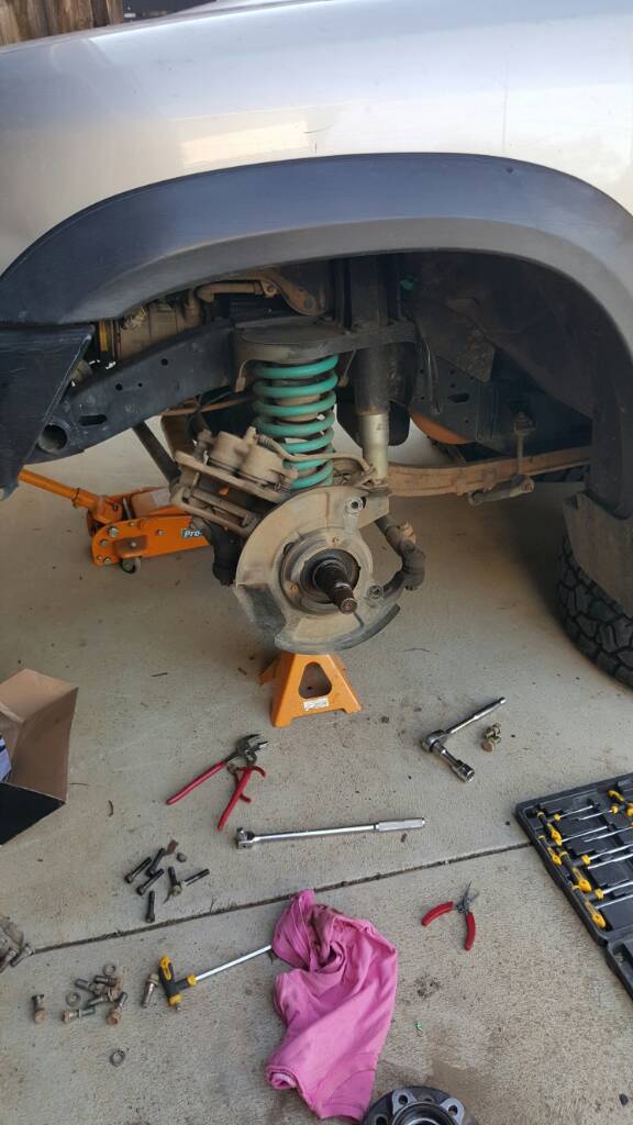

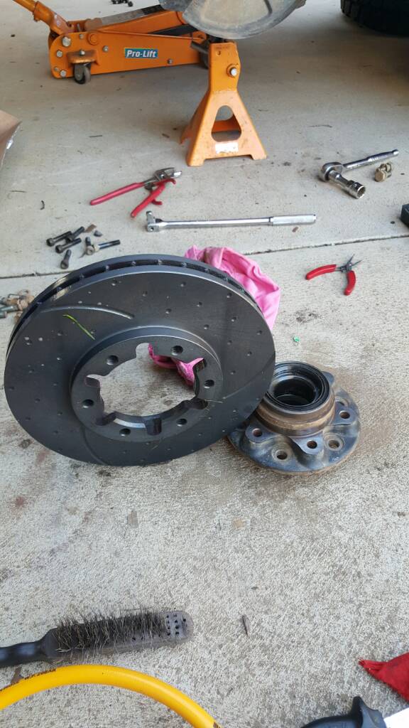

http://www.nissanpatrol.com.au/forum...016/05/107.jpghttp://www.nissanpatrol.com.au/forum...016/05/108.jpghttp://www.nissanpatrol.com.au/forum...016/05/109.jpg
And now the fronts are done.
