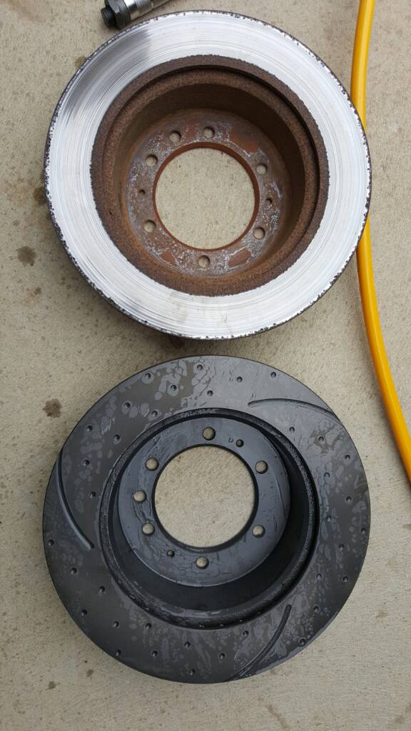

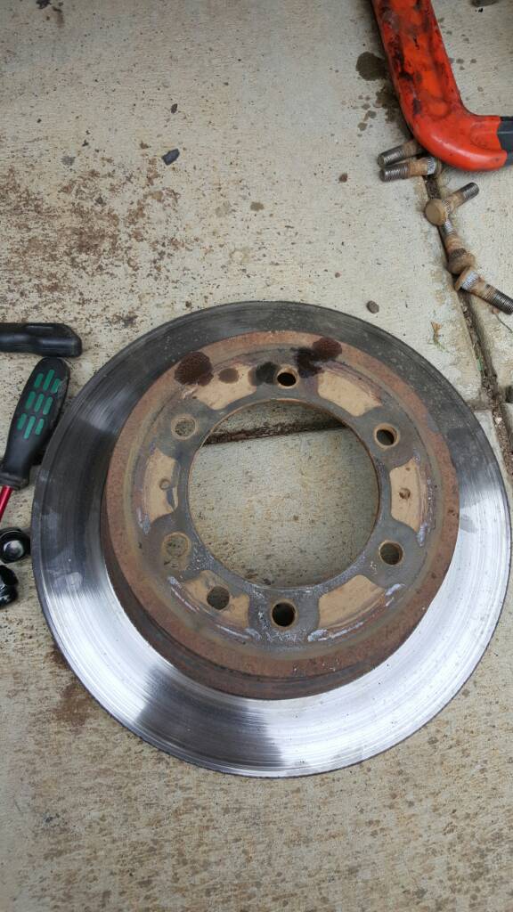

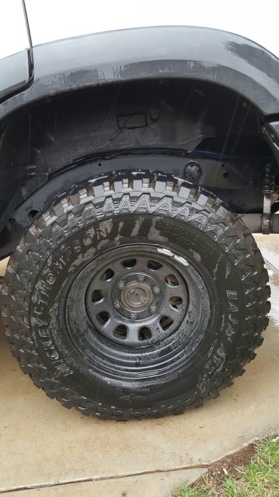

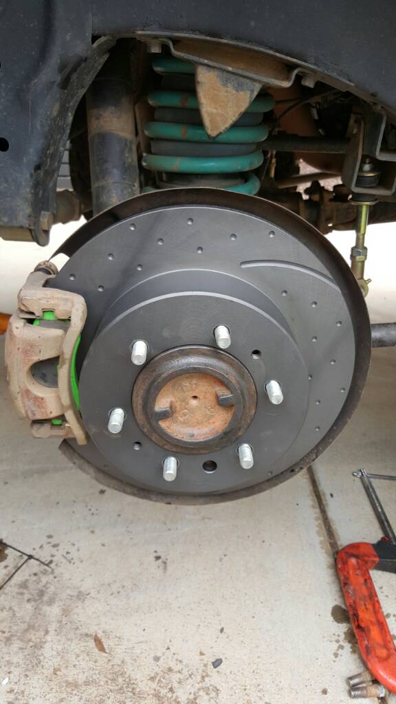

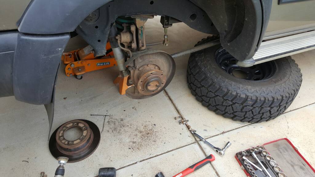

Old off...... New on. Good feeling knowing it's all fresh. Massive shout out to Mudski for the studs and nuts.
Tomorrow I might tackle the fronts if I get motivated and it isn't too wet.
Looks great! What brand?

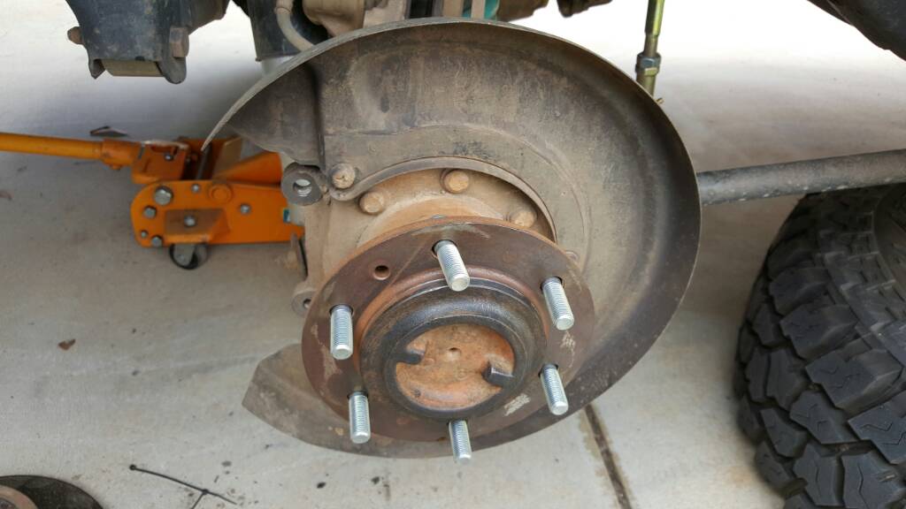

How did you go about changing the studs?

They are all on nice and solid now mate. Haha. Damn factory alloys. Rear studs are easy you can do them without removing brake disc, easier though if you are replacing the disc. Simply hit them with a mallet and they pop out the back insert new one and do up nut. http://www.nissanpatrol.com.au/forum...2016/05/75.jpg
