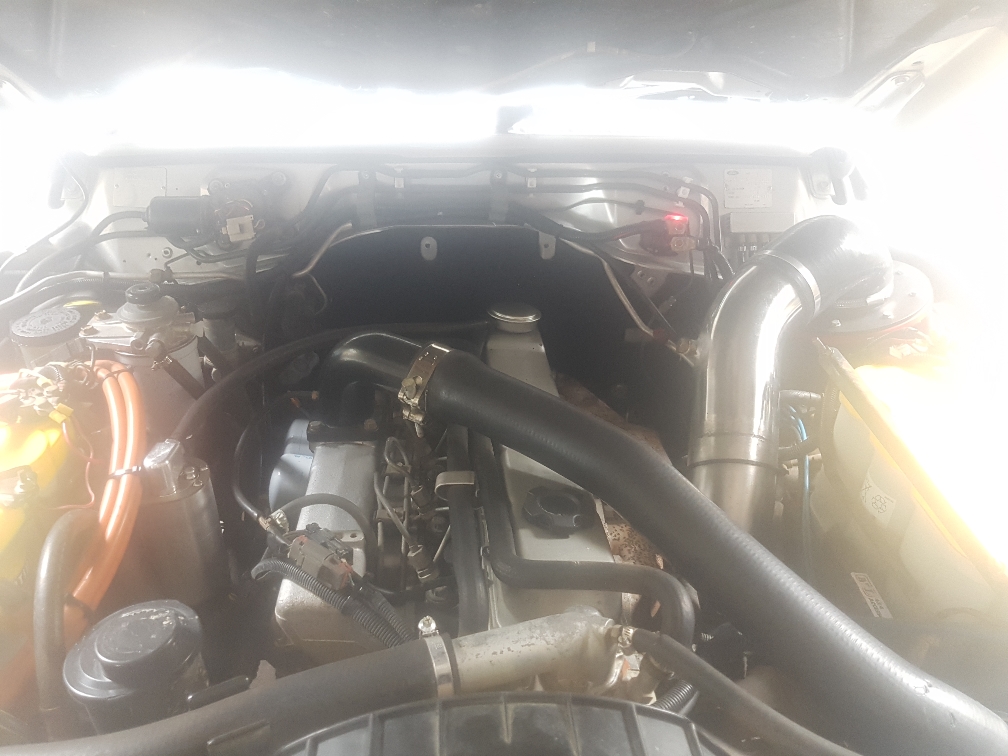

So ended up taking into YV 4WD got oil cooler and breather leaks all fixed and motor clean as now could at dinner off it lol. . . Yep, very happy to pay rather than bother with that job, sometimes just not worth it. . .

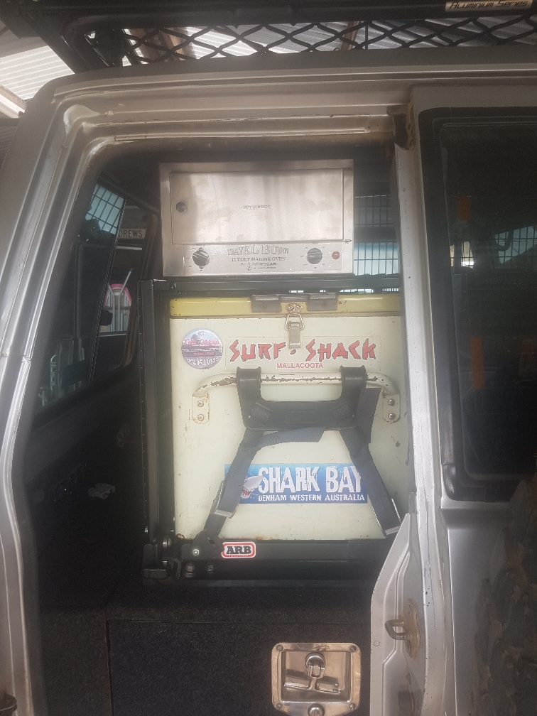

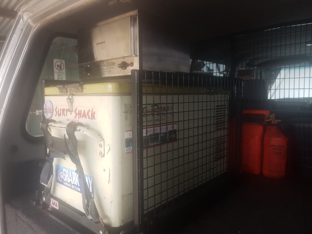

In the meantime rustled up a cage for the fridge with room for travel buddy up top, got it powder coated along with gear stick which came up awesome [emoji106][emoji106]

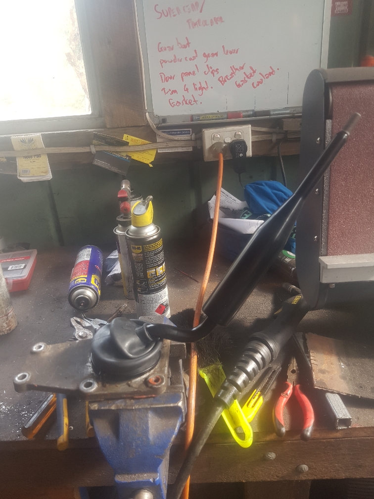

Also replaced rubber boot ontop of gearbox, as although wasn't that old was knackered. . All good now lol . .

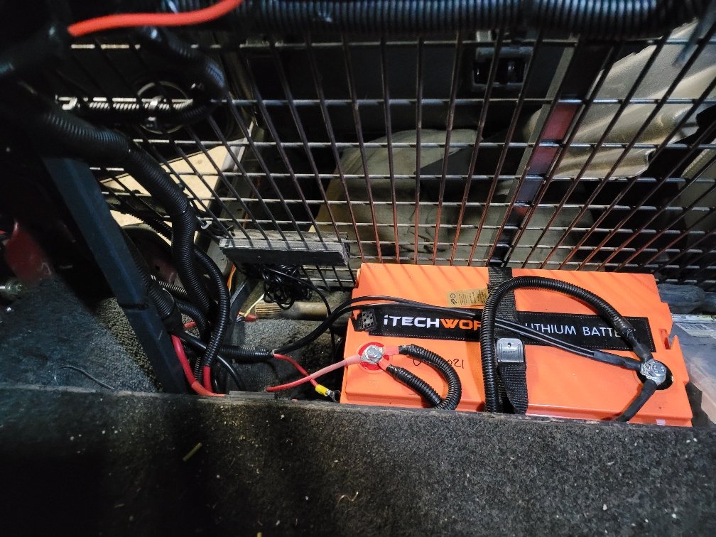

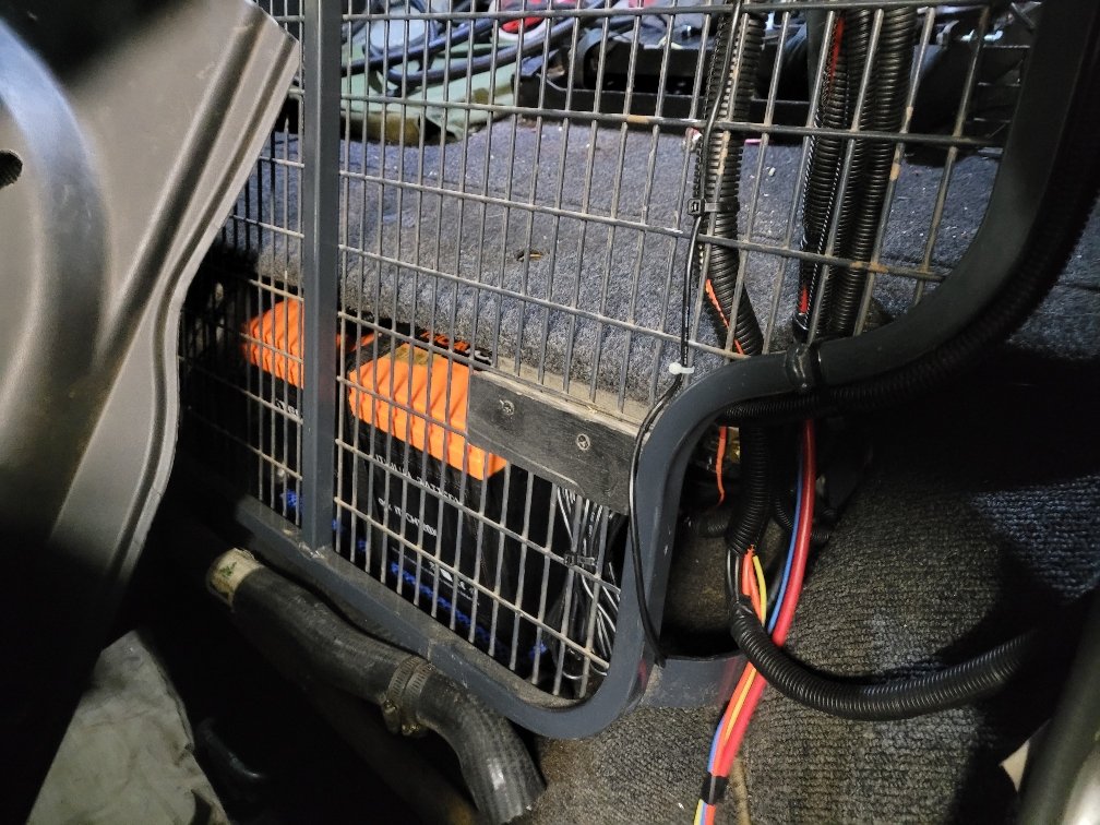

Finally got the lithium installed and pretty much all wired up in the back. . Sits pretty prefect in little hidey hole behind rear drawers. .

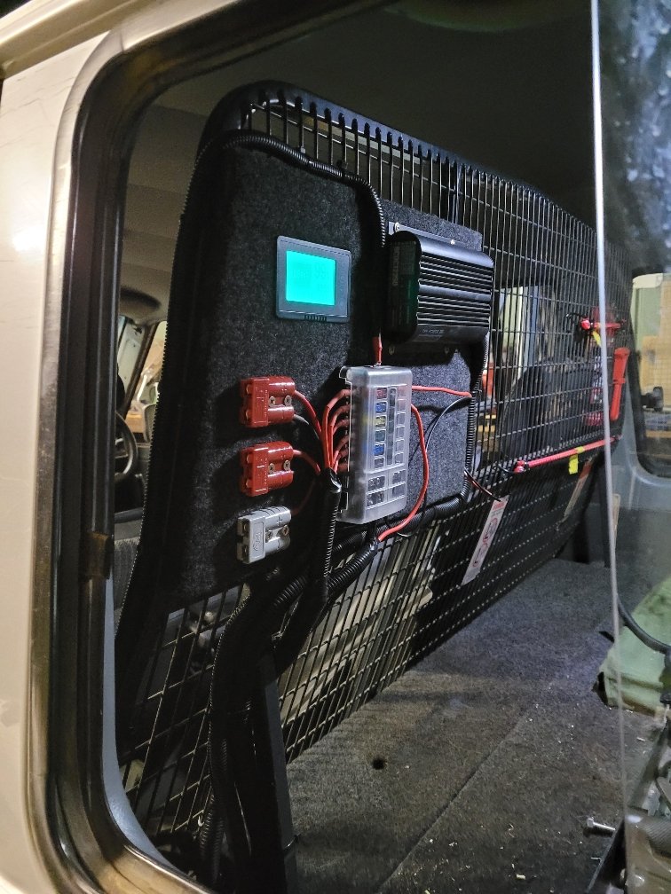

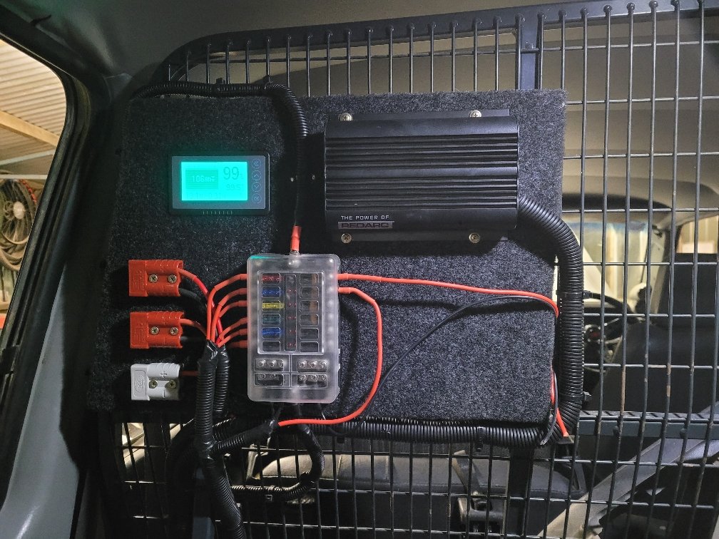

Mounted redarc 25amp bcdc charger, fuse box and Ando inlets for solar and 240 charger plus an outlet on back of cargo barrier. . She's petty much all wired up so much better having a central fuse box rather a million in line fuses coming off battery and not knowing which is which lol. . Also put in cheap shunt & monitor seems to work well so far. .

Look good Ross. Jaycar sell LED fuses that show instantly which circuit is blown, bloody cheap and saves pulling fuses out willy nilly. i have upgraded all mine, best thing i did for a while. No dear either. If you buy them off ebay they are 10 times dearer.
Oh bloody fancy!! Me likey a lot, well done Rossco.

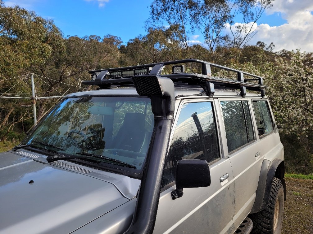

Bit more lockdown love on the old girl, wiring, wiring seems like it never ends lol. . . New light bar on roof seeing as ran power up there. . .

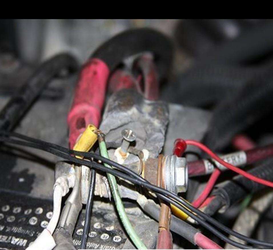

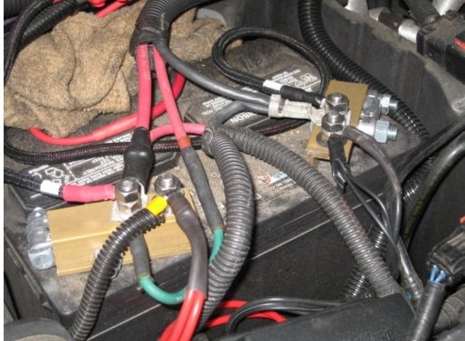

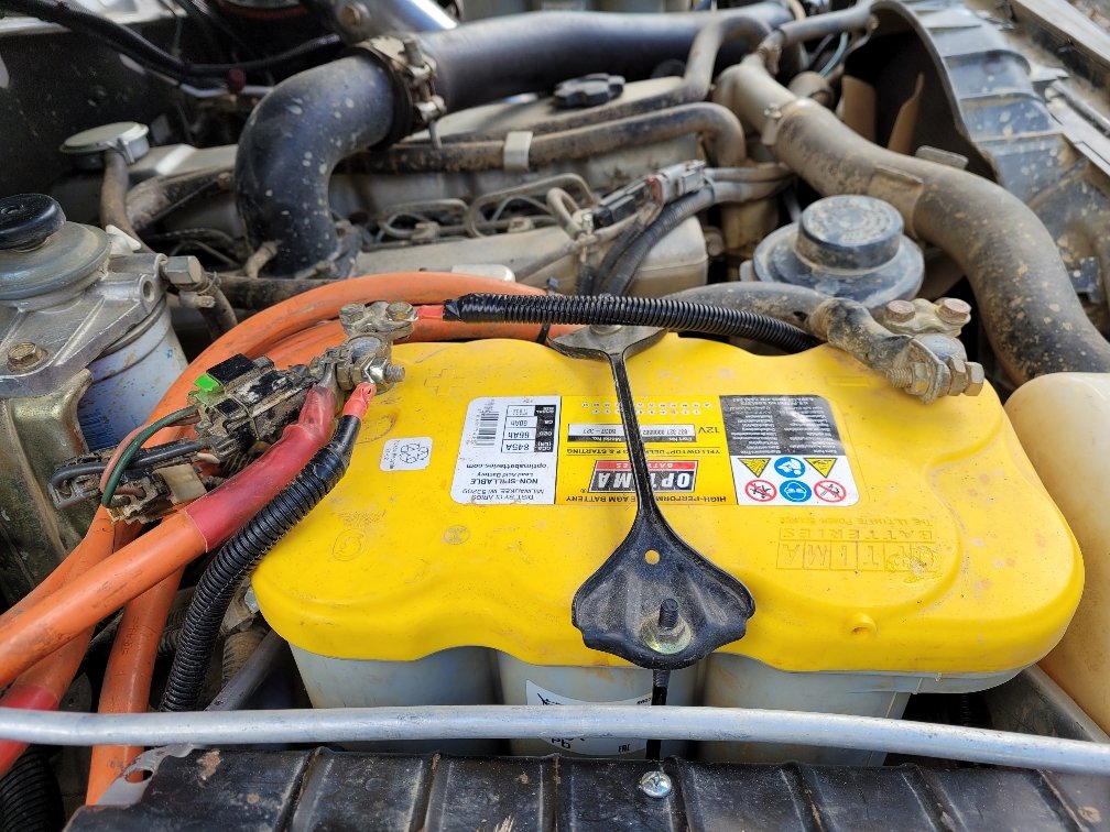

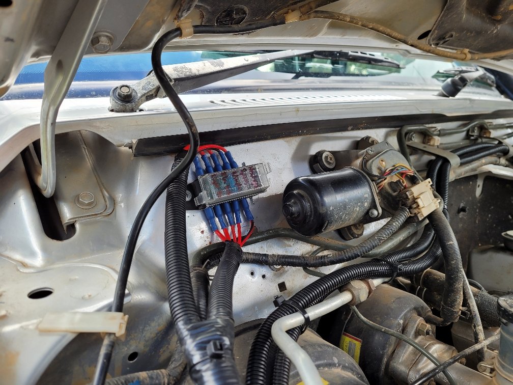

Tidied up main battery and ran little fuse block off terminal post with midi fuse hidden under relay cover . . Should have got a before pic bit for dramatic purposes was something like this. .
http://www.nissanpatrol.com.au/forum...2021/10/50.jpg
Not quite as bad as this but close maybe. .

To this much better [emoji846] . . .

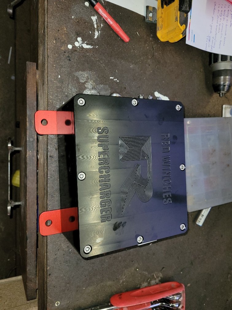

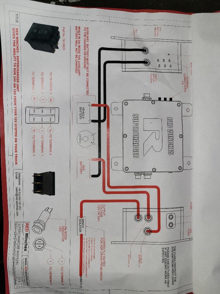

Now second optima not hooked up to anything so ready to hook up redwinch supercharger for some 24V goodness [emoji106][emoji106]. . .
