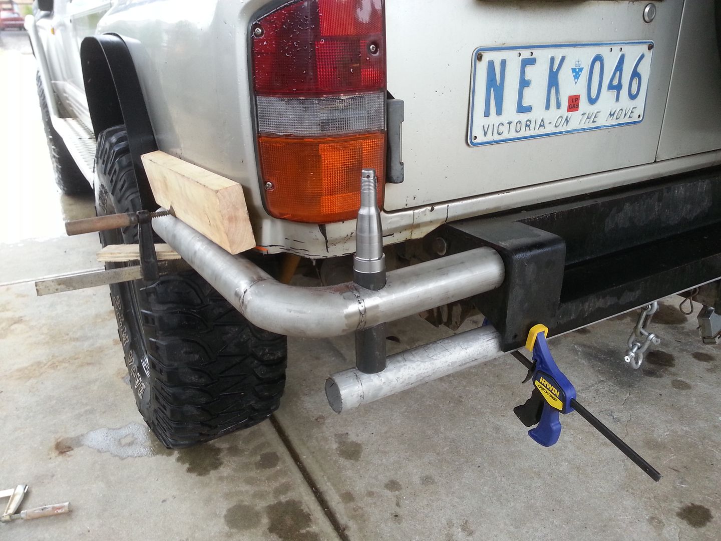

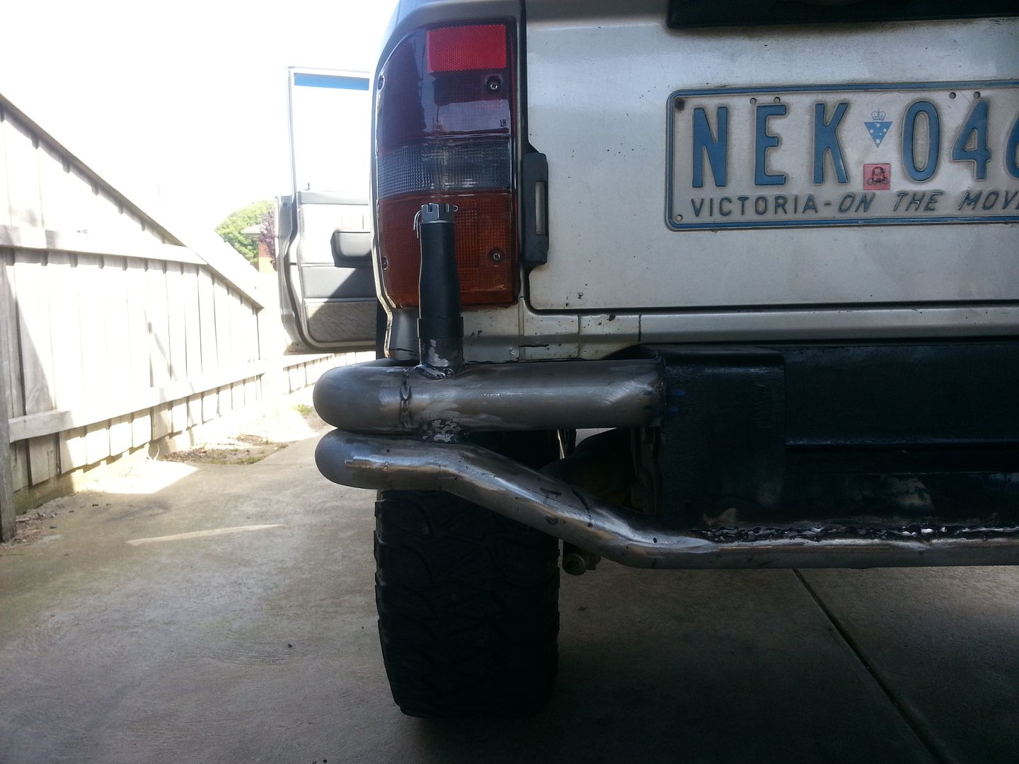

Got rained out today so got home and did a bit more bar work.... did not take a pic but the lower bar now bends up straight after coming off the step.
http://i184.photobucket.com/albums/x...ps0714c227.jpg
http://i184.photobucket.com/albums/x...psb92e437d.jpg
mate, i dont mean to be picky but that clamp is gonna get hooked up on heaps of sh!t out on the tracks. Maybe get a smaller one or cut that one down?
and the blue clamp seriously reduces your departure angle....

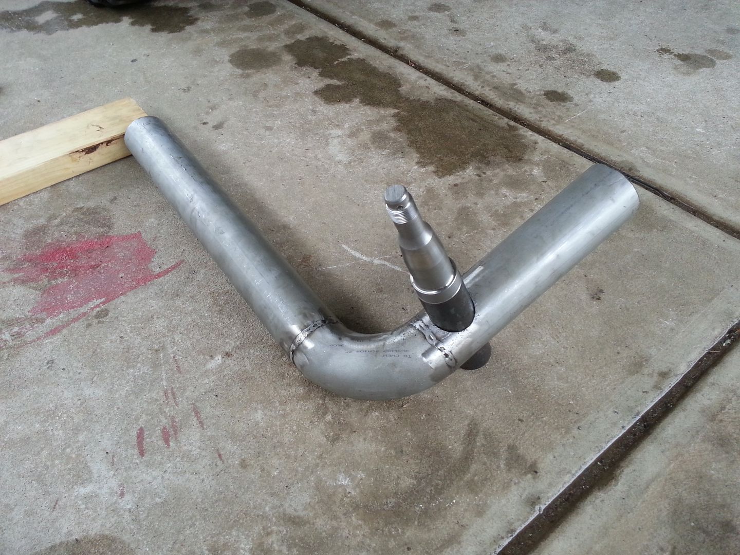

I have one issue and not sure how to tackle it and that is the main step in the middle has a bend in it the length along the bottom where the inch and a half pipe is running along.
My plan was top join this the whole length but it will not bend??? what should I do?? I will take a pic tomorrow of what I mean..

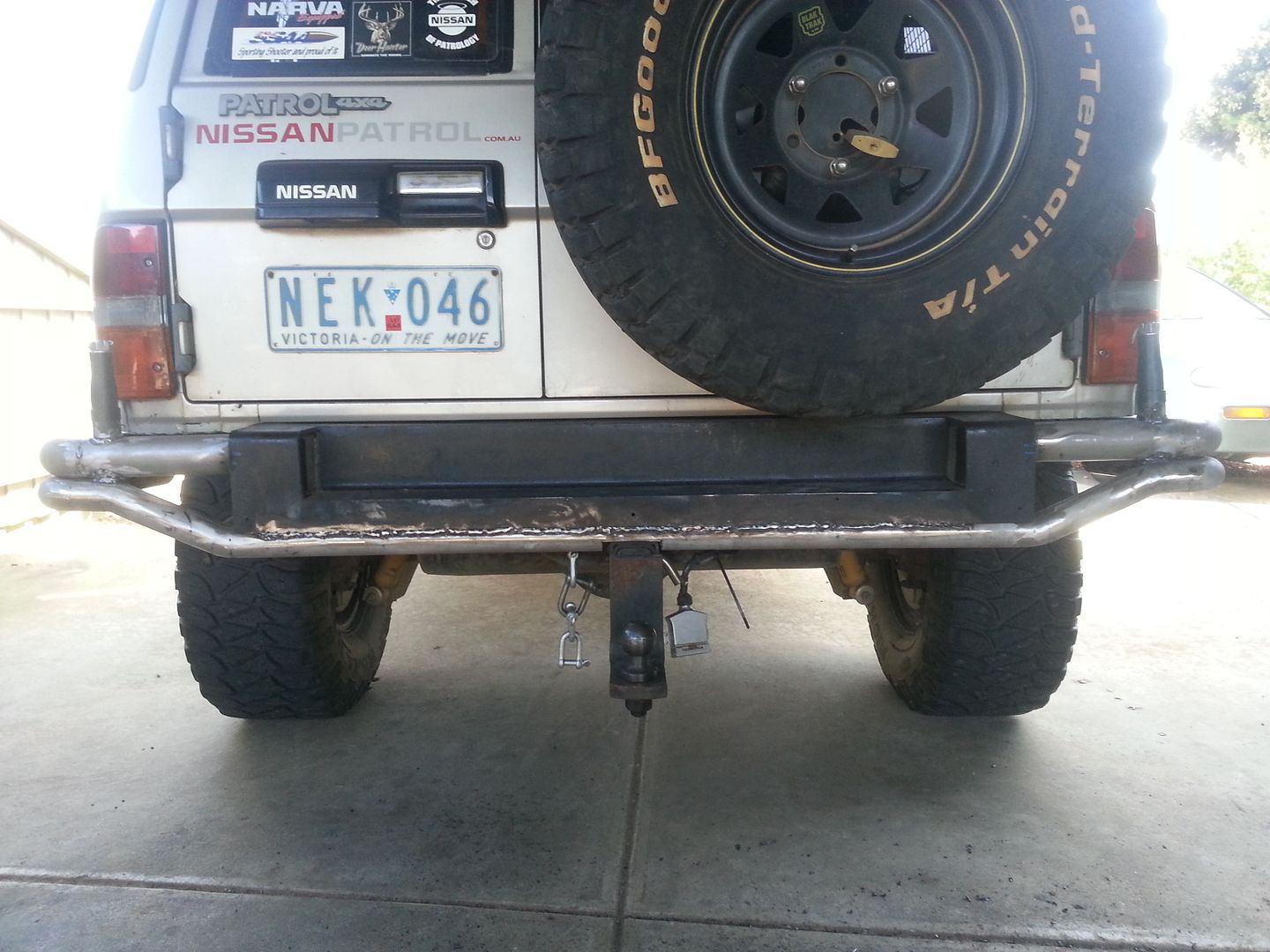

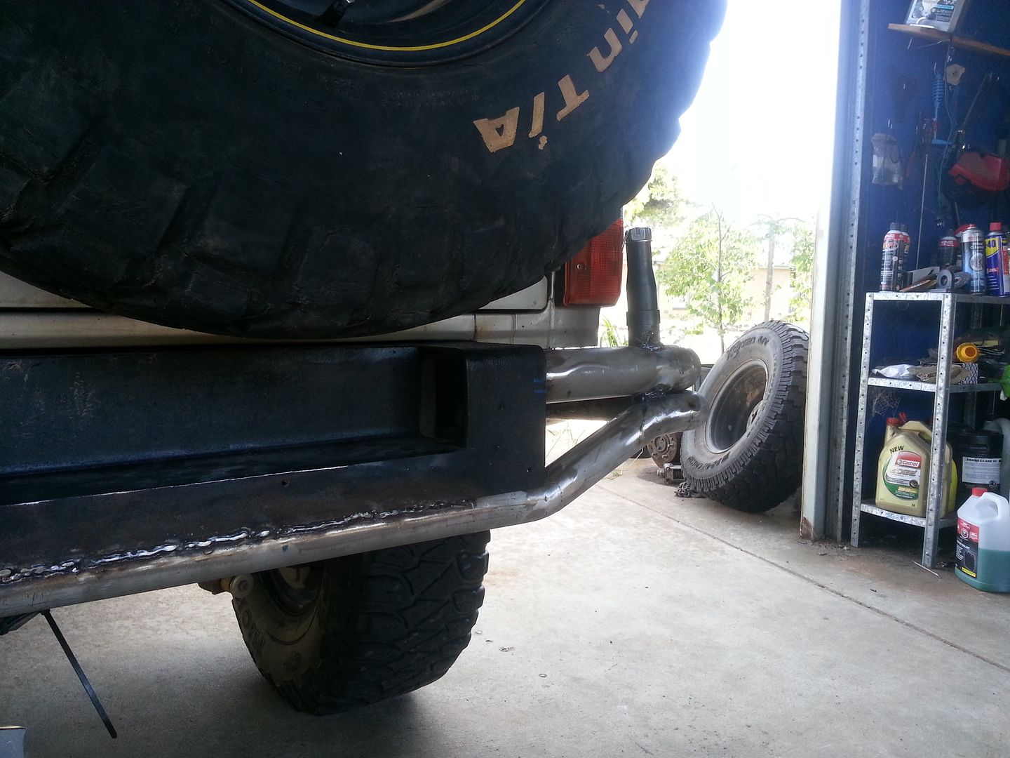

Flat out with work but any spare moment building this rear bar...
Still have a lot more welding and bracing plus grinding back to do but overall I am bloody happy for a person who has never made anything even close to this before...

Looking good mate, well done
Good work, so where are the rear lights gonna go?

I think I will make the jerry can holder first and worry about the wheel carrier when I have free time....
are you gonna brace the tubes somehow to stop them from being pushed inwards when you wack something???...................... whats for dinner, any left overs? I'm hungry

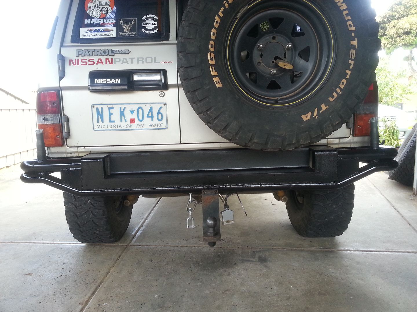

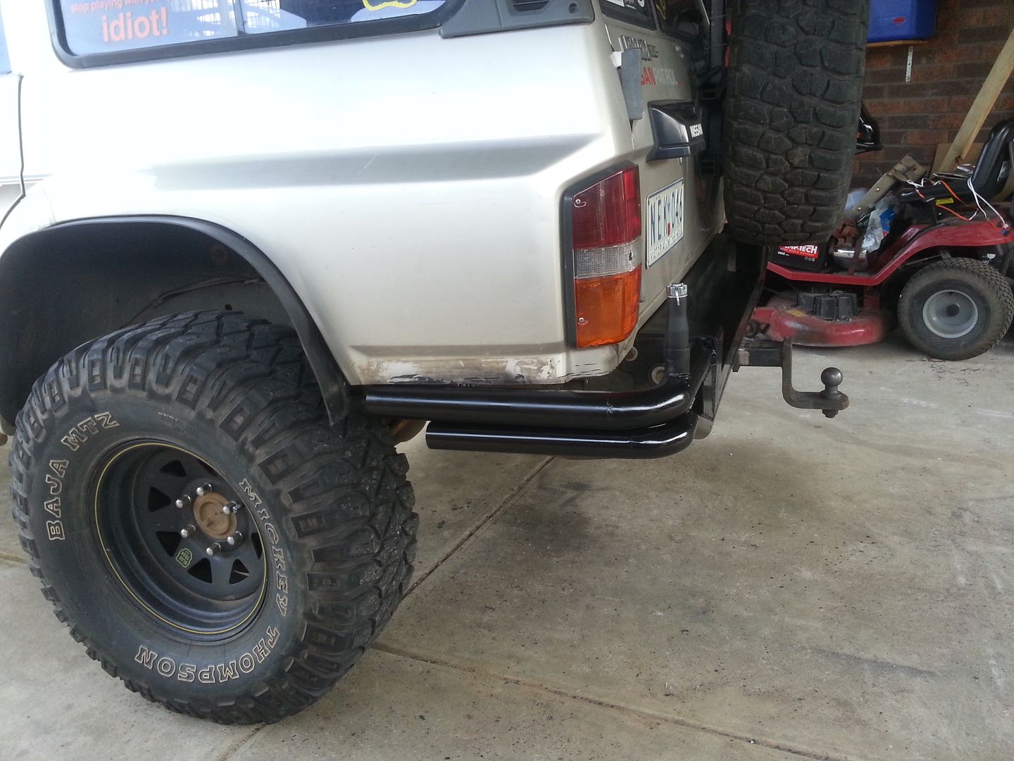

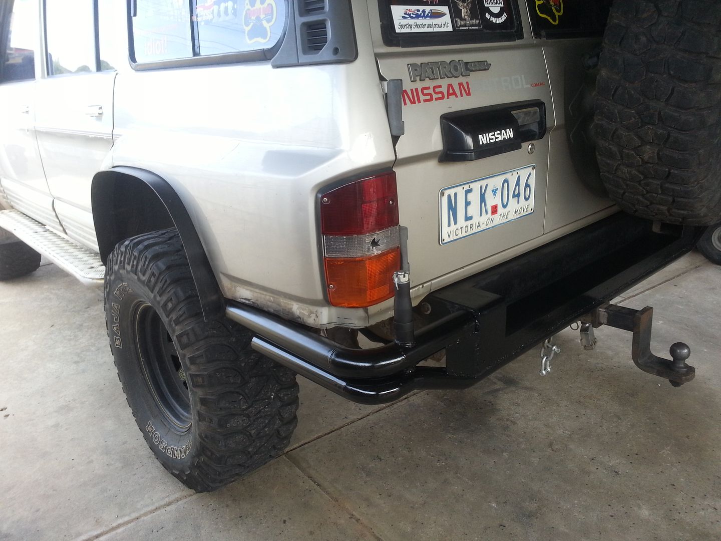

Finished the bar for now the other day... I need to add the lights which arrived today and the swing away for the jerry cans.
I will take the bar back off next month and get George to go over everything and tidy up all the welds but for my first ever build of this type I am happy.
I just gave it a quick few coats until it gets blasted and powder coated.

Good job man. Looked better with the clamps though. And probably would have been better if you had a LoKKa in the front diff :) hahahahhahahahaha
you could use some 4mm x 50mm flat to frame your tail lights and protect them at the same time.
looking at welds might be better to bog them then paint them
But seriously nice bar Johnny boy.... now what's in your jocks?

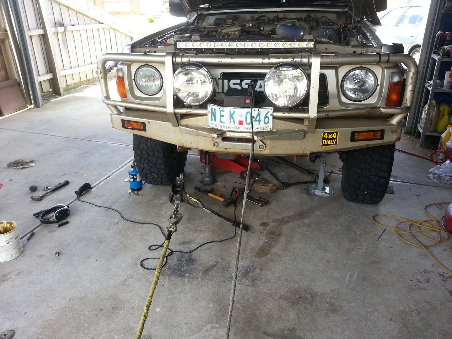

Well today I finally got around to replacing my radius arms and fitting drop boxes and what I thought would be a couple of hours turned into many!!!
First thing was one of the bolts for the arms would not come out... it had seized into the sleeve and after much time wasted I found I had some spare bolts from the donor car so I cut the bugger in 2 peices.
My old arms were not in good condition and the castor correction bushes were stuffed.
After that drama everything else came out relatively easy and then I set up all the gear for the install.
I had a set of radius arms I got ages ago from a GU and after an easy install of the drop boxes I started the task of fitting the new arms, this got hard..!!

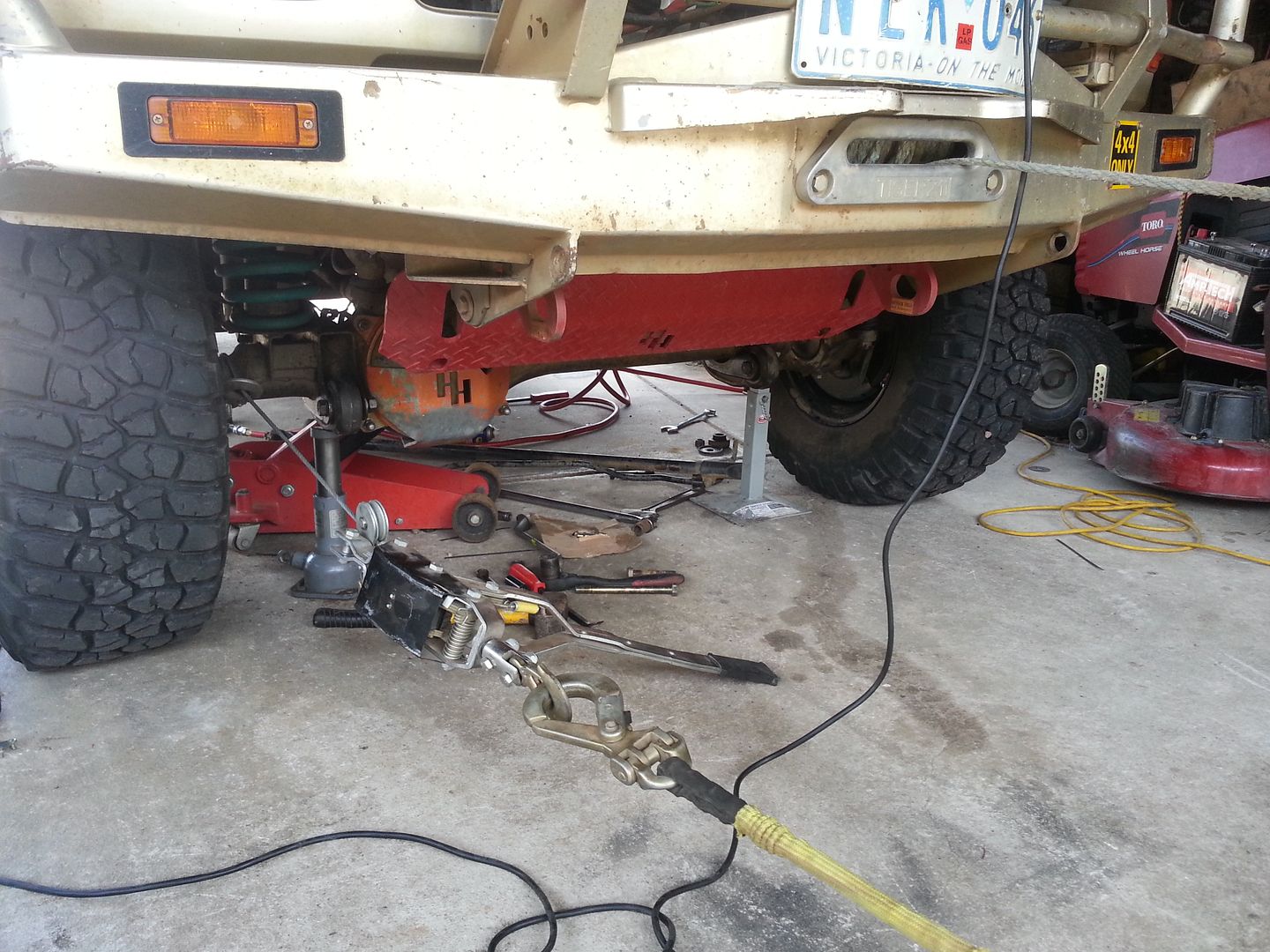

I had 3 jacks and all to manipulate the diff as it was miles off from where the castor bushes had it lined up, I got one side in ok but the other was a lot tougher.
I found once I put the main jack onto the front shaft where it comes out the diff it twisted the diff into place but it still needed to come forward and 4-5cm so I ran my winch off my garage and back to the diff and used that to pull the diff forward.. couple of little tweeks and it was in!!! yeeeeee!!!
