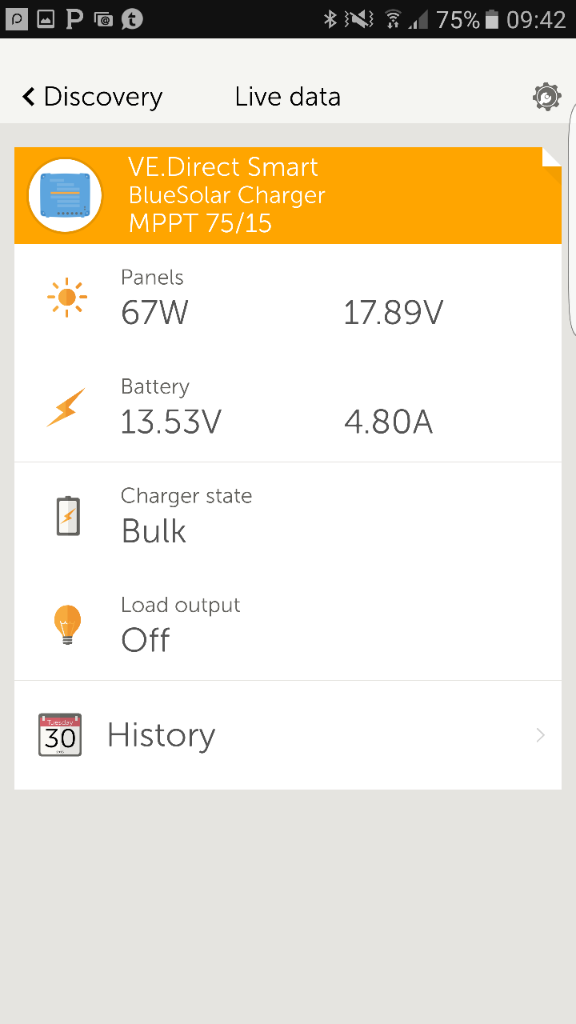

Wow I was going to get a victron any way but I guess now I'll be getting the Bluetooth dongle too. Looks like a great bit of kit

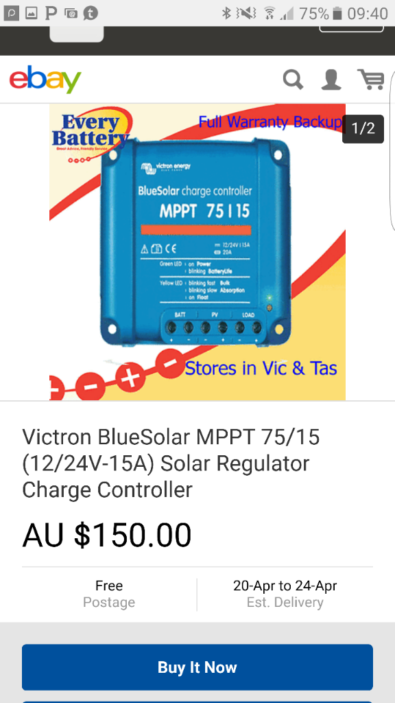

http://www.ebay.com.au/itm/VICTRON-B...26.m2548.l4275
@sooty_10
One MPPT, one PWM. http://www.nissanpatrol.com.au/forum...017/04/116.jpg

Because most regulators are not water proof and I'm limited for where I can mount any regulator I like the idea of the app , so I can mount the reg on cargo barrier behind fridge and still know what it's doing .

No need for confusion! Previously I recommended a cheaper Victron on the basis that it was good value & from a manufacturer with a reputation for quality. This reg that Sooty posted is from the same manufacturer but a step up in regard to being MPPT (which would be genuine MPPT, not just letters on the outside of the case) & more so because of it's ability for remote monitoring on a phone (for additional cost). Also the previous one I recommended was a bit small for the 200w of panel(s) you mentioned. This one is the next size up (15 amp instead of 10 amp) & would cope with up to 250w pane(s). If you want to keep costs down restricting yourself to 170w panel(s) & are happy to have no monitoring the previous Victron reg would be a reasonable choice.
