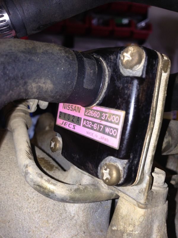

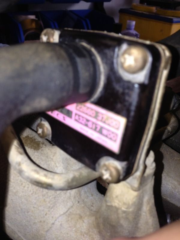

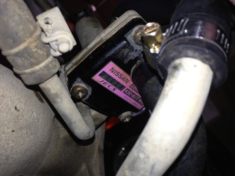

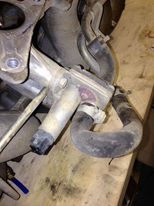

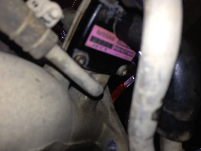

Urgent pic req
Hi I have just got all the efi gear back and found a set of pipes and hoses with a sensor attached that obviously fits up under the inlet manifold. I have taken many pics whilst dismantling but missed this section so could someone point a camera up under the inlet manifold and snap a few pics to help me out ASAP.
If you need pics of where the two hoses plumb to, I'll run out and grab a couple when I can. Hopefully you have an electrical plug without a home floating around.
That's the piece, pic of where the pipes go would see me finish the refit, thanks Parksy.
