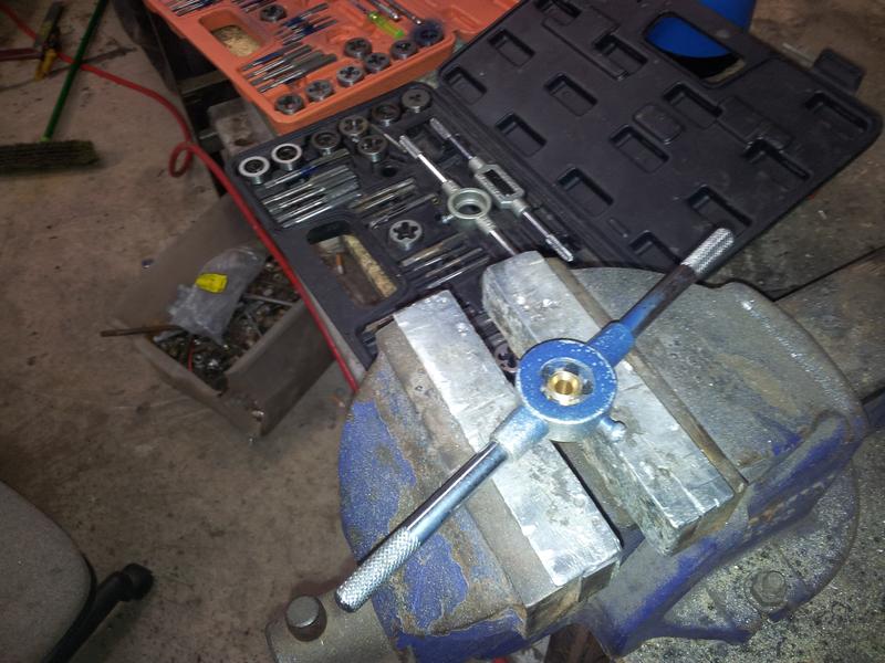

Hey Silent,
Can I ask what fitting you started with to put into the end of the compressor? I'm guessing 1/4 bsp? Then what did you cut it to, to get it to fit?
I'm trying to do something similar and put a pressure valve off a tee piece and couldn't find anything to fit. Grr

@ Srex idealy you want a non return valve and may be an air manifold to fit the pressure valve to
Cheers mate, I have seen the manifolds but only in npt. I need to be able to get out of the compressor first, either npt or bsp to be able to attach one. I've already been to a couple of fitting shops including Enzed and it's not a common thread which is annoying.

@ strex I think looking at the compressor they have used a bolt thread from the head through the handle to
the nitto fitting,,,,, either 10mm x 1.25 or 8mm x 1.25,,,,,,,,, Sounds right to me.
Are you mounting it as well ,if so Id remove the handle, but thats just me.lol
https://www.valvesonline.com.au/references/threads/
