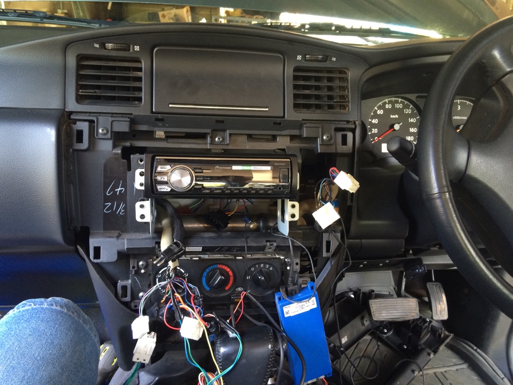

Finally finished the stereo upgrade today. Pioneer head unit, JBL component speakers and a reverse camera - a real bitch to get the camera installed.
Attachment 63622
Attachment 63623
Attachment 63624

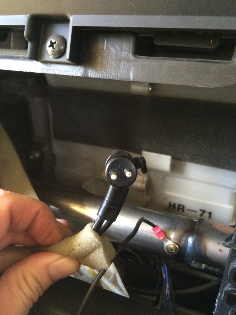

Aerpro do a full range of plug 'n play looms for all different head units and all different vehicle combo's - have a look at your local supercheap / autobahn etc. I used them recently on my head unit upgrade and made everything go that much easier.
Just make sure you also pick up a double antenna (Nissan end) to single plug adaptor depending on your head unit requirements
http://www.nissanpatrol.com.au/forum...2016/01/43.jpg
http://www.nissanpatrol.com.au/forum...2016/01/44.jpg
Hi - I got this connector from ebay so did not have to make any mods.
