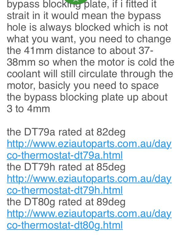

Varying 82-85-89C tests with blocking bypass once opening that may assist @mudski too.

http://www.nissanpatrol.com.au/forum...018/11/157.jpg
Thinking we might start off giving an 82C one a go this summer in the Mrs GU TD42T after reading that blokes trials, worth a cheap crack at them all really.
