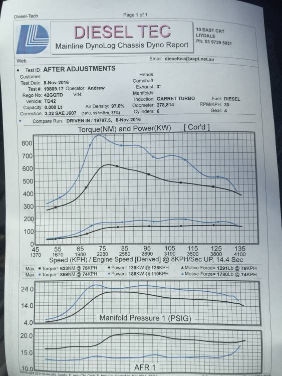

Looks sweet to my curvaceous gut graphs Mark mate! What are you chasing for exactly mate?
Hey Markie, bugger your not happy with it numbers look very good but not so good to drive yeah? What about swapping out just the compressor side of turbo to something smaller that spools a bit quicker? Would of hoped jpc got it spot on in the first place i spose?
Drop her into Low Range 1st and climb TD42T steady @ 2,100.3142 Pythagorous exactly[emoji106][emoji106]
Big exhaust wheels
Noted he has increased fuel low down from AFR 17 to 14:1 in an attempt to get boost, do you notice more smoke low down?
Those figures are good though must say, but do understand your like for more low down. Long for torque like that mid range and now I see why you like to move a long.
Mark, read your post again, why it is blowing less smoke (tune)? Have near no knowledge with waste gate design turbo but with my VNT high flowed Garrett, it was initially a bit laggy low down and to get it to spool/boost earlier, was either to give it more fuel low down or to keep the veins closed longer by reducing the actuator rod length so less vacuum to lift the actuator lever to hit the stop to keeps the veins closed longer to get the turbo to spin up faster low down. Interested to learn here,

This is my dyno tuned by him, 12mm pump and gtx2863
You are getting a higher output, eventually. If it were me I'd put up with it for a couple of years cos I'm sure it is still good to drive. Then go with the Borgwarner. I'm not a huge fan of the power delivery from the Garretts, it's like wait, wait, wait then all of a sudden it comes on hard.
The BW builds up more gradually and comes on full song earlier.
