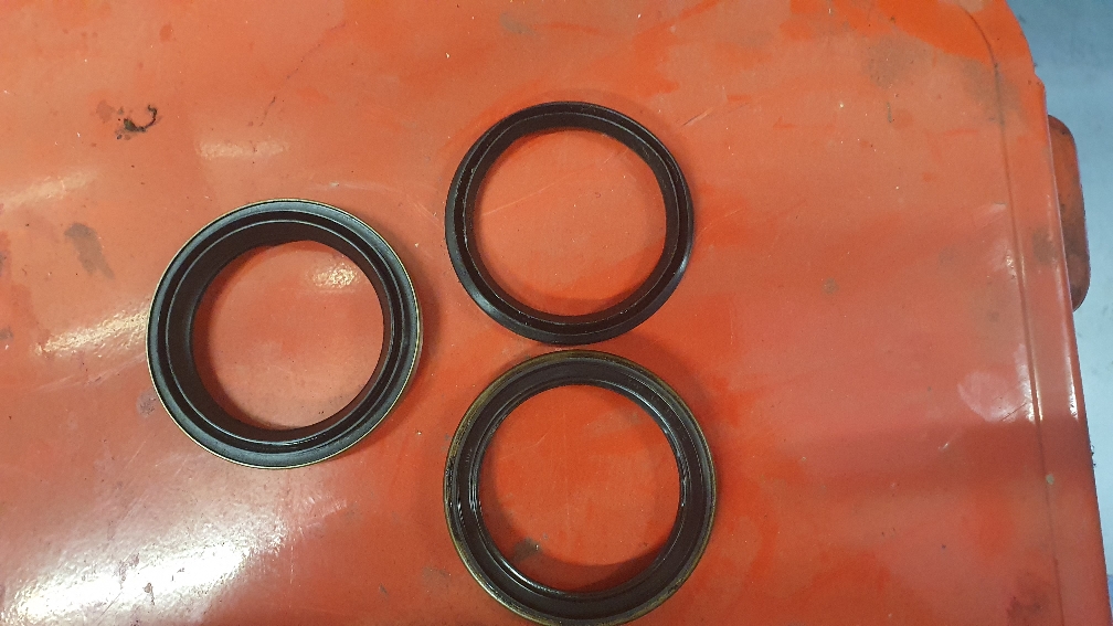

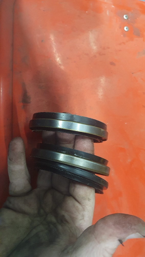

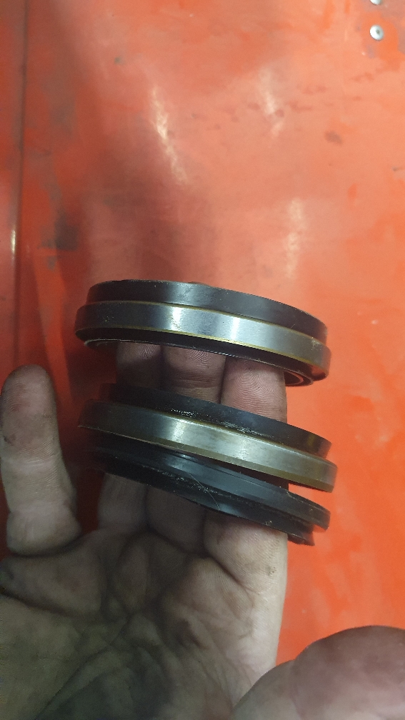

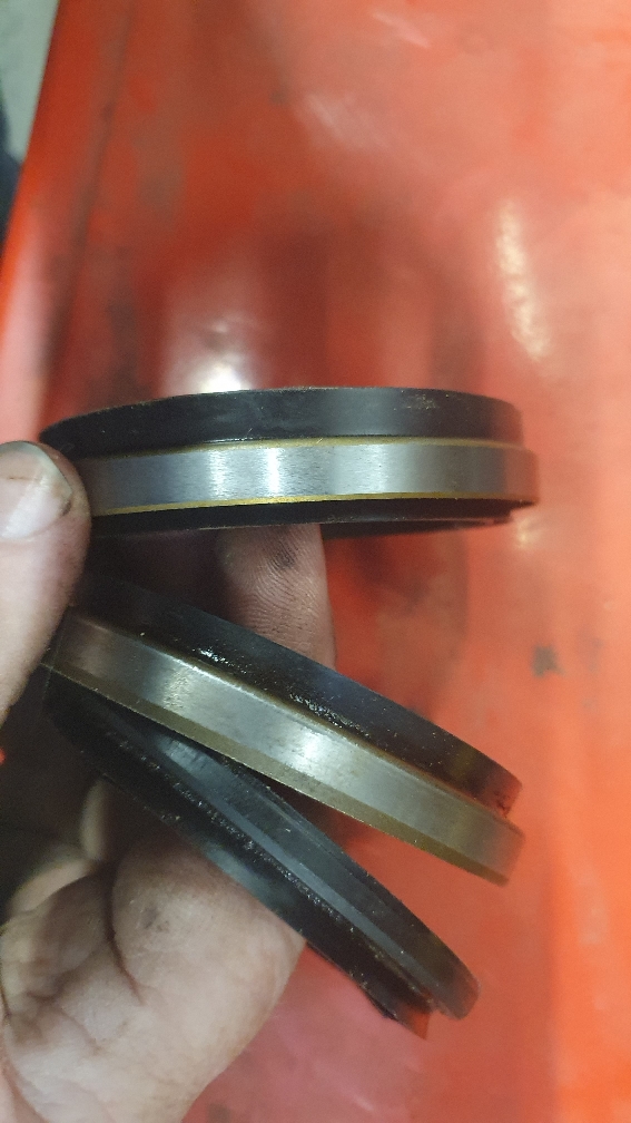

So I thought I would add these pics to this thread. Currently doing front wheel bearings only on the GUIV. I bought the bearings from the 4WD Shed off ebay. They came with a seal too.
The back seal gets destroyed when removing so was keen to get them too. Well this is the seal that turned up.....
It seems that at some point some smart bloke have merged to 2 seals needed into 1!!
http://www.nissanpatrol.com.au/forum...021/04/255.jpg
http://www.nissanpatrol.com.au/forum...021/04/256.jpg
http://www.nissanpatrol.com.au/forum...021/04/257.jpg
http://www.nissanpatrol.com.au/forum...021/04/258.jpg
The new seal may well be 2 seals conveniently pressed into each other but I'm not going to risk splitting them for the sake of confirming its 1 or 2. This is an upgrade.
