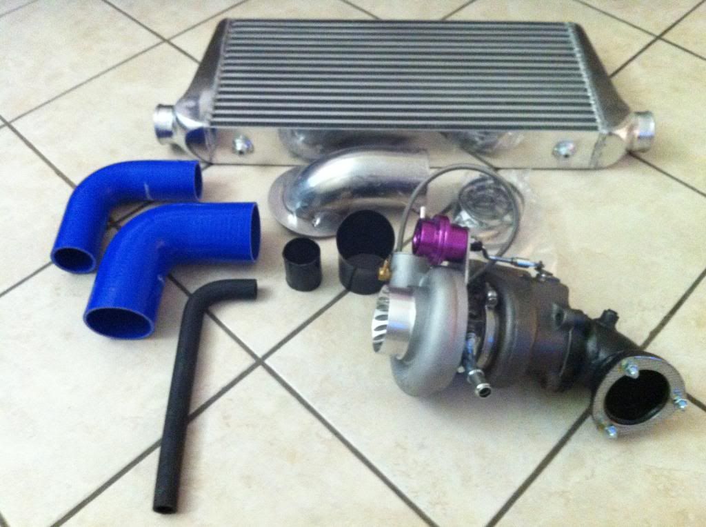

So as I said here is a pic of the cooler. I also forgot to mention that I have a moulded vinyl floor and resomat underlay also to go into the car when I eventually get time.

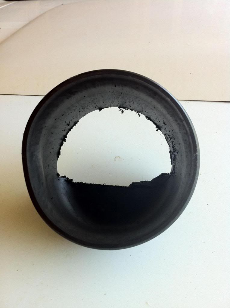

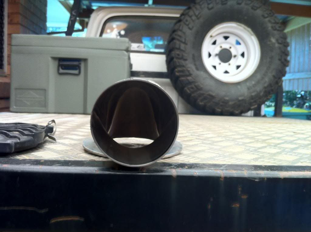

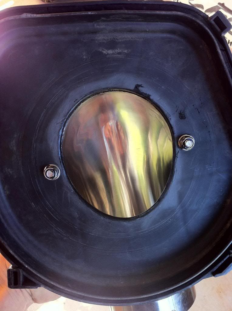

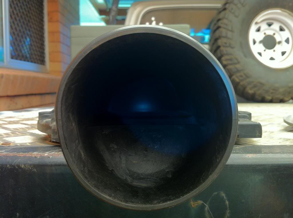

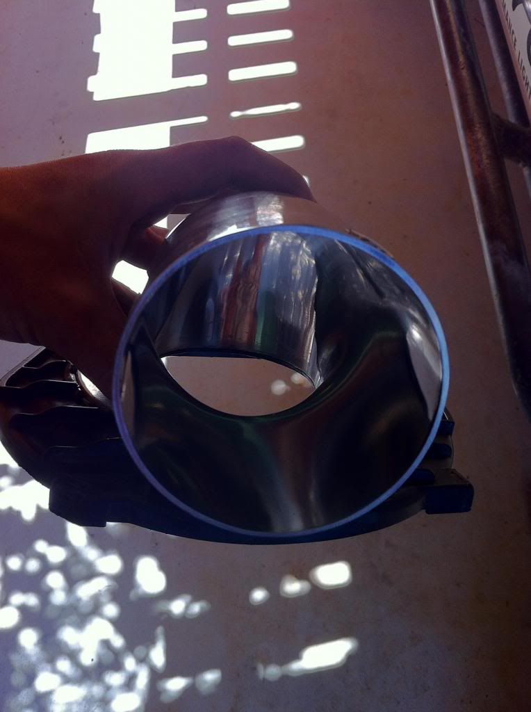

Ok so I have started the work on the GU. Its a little difficult as I need to keep it mobile so its gonna take sometime. I was hoping to get the airbox lid modification and turbo installed today but I need the car this arv and have just finished the air box mod. So here are the pics of before and after with the airbox lid. You can see how restrictive the factory setup is.
Factory Airbox Lid
http://i1248.photobucket.com/albums/...y/IMG_1303.jpg
High Flow Lid
http://i1248.photobucket.com/albums/...y/IMG_1305.jpg
Factory Lid
http://i1248.photobucket.com/albums/...y/IMG_1307.jpg
High Flow Lid
http://i1248.photobucket.com/albums/...y/IMG_1309.jpg
Old Factory setup removed. Its easy to see the restriction here.
http://i1248.photobucket.com/albums/...y/IMG_1311.jpg
Here it is all fitted up. Looks Much better and should help the bigger turbo breath a bit better over what was in place from factory.
http://i1248.photobucket.com/albums/...y/IMG_1315.jpg
http://i1248.photobucket.com/albums/...y/IMG_1317.jpg

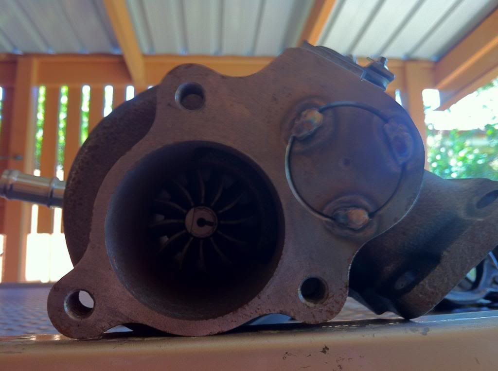

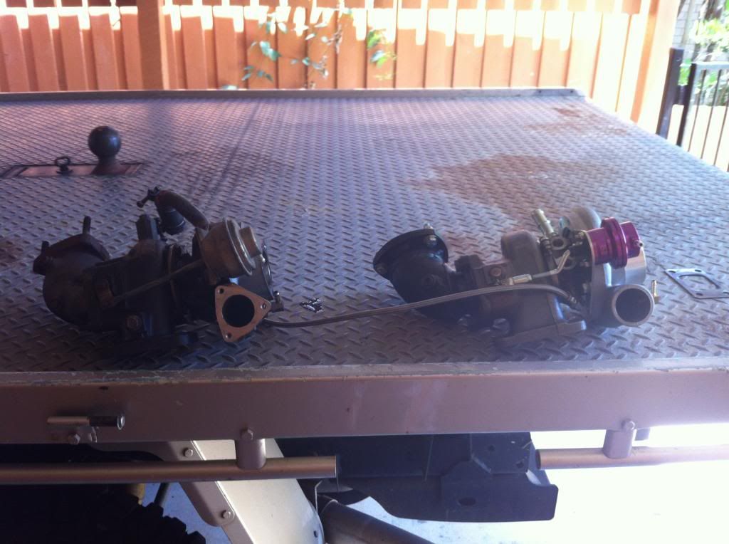

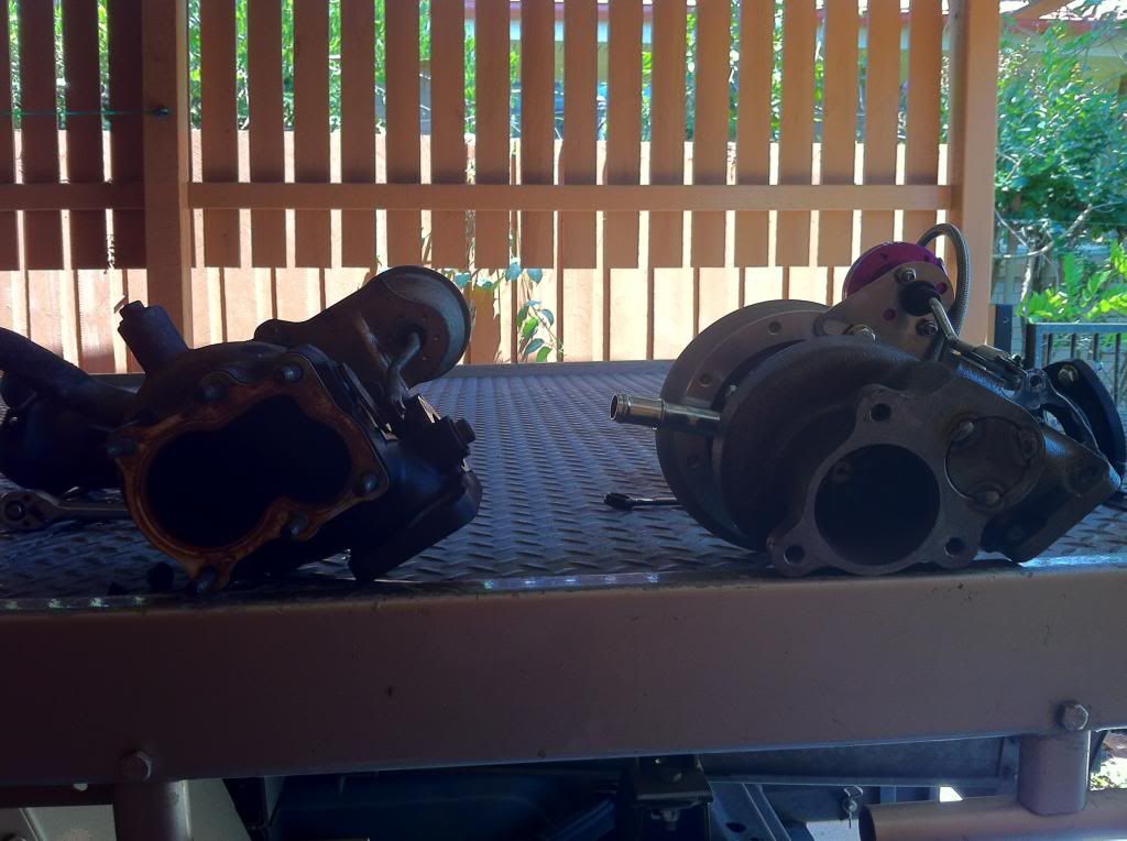

First pic is the old turbo next to the new one. You can see here why a lot of people dont modify the compressor side. The suction side is limited by the 3 bolt flange and so is the charge side.
http://i1248.photobucket.com/albums/...y/IMG_1328.jpg
This is the charge side differences.
http://i1248.photobucket.com/albums/...y/IMG_1330.jpg
Exhaust Side
http://i1248.photobucket.com/albums/...y/IMG_1333.jpg
New turbo Turbine Housing
http://i1248.photobucket.com/albums/...y/IMG_1335.jpg

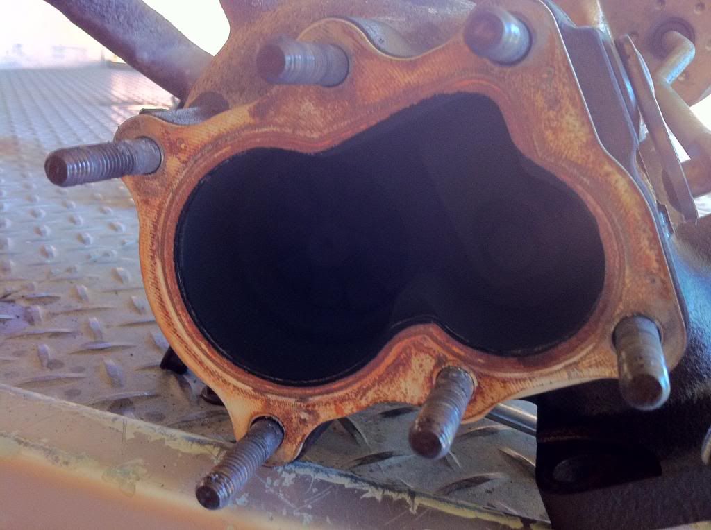

Old Turbine Housing
http://i1248.photobucket.com/albums/...y/IMG_1337.jpg
