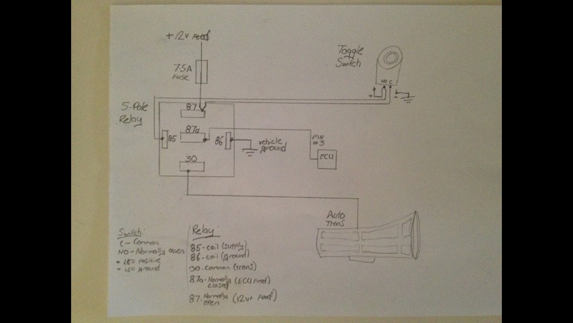

http://www.nissanpatrol.com.au/forum...016/01/230.jpg

Ours is a daily. Only use the manual lockup when towing. Other times you'd never know it was there.
In my system I used all the safety options Chazz discussed earlier, and have had no problems once I got it set up.
The mistake I made in fitting it even healed itself. I switched two wires and fed 12 volts into the TCM where I was meant to get 12v out of it.
Big Fletch also did a diagram

I wouldn't use a single relay system like the one in the picture above. If you accidentally turned it on while in park or neutral, you may fry your auto.
