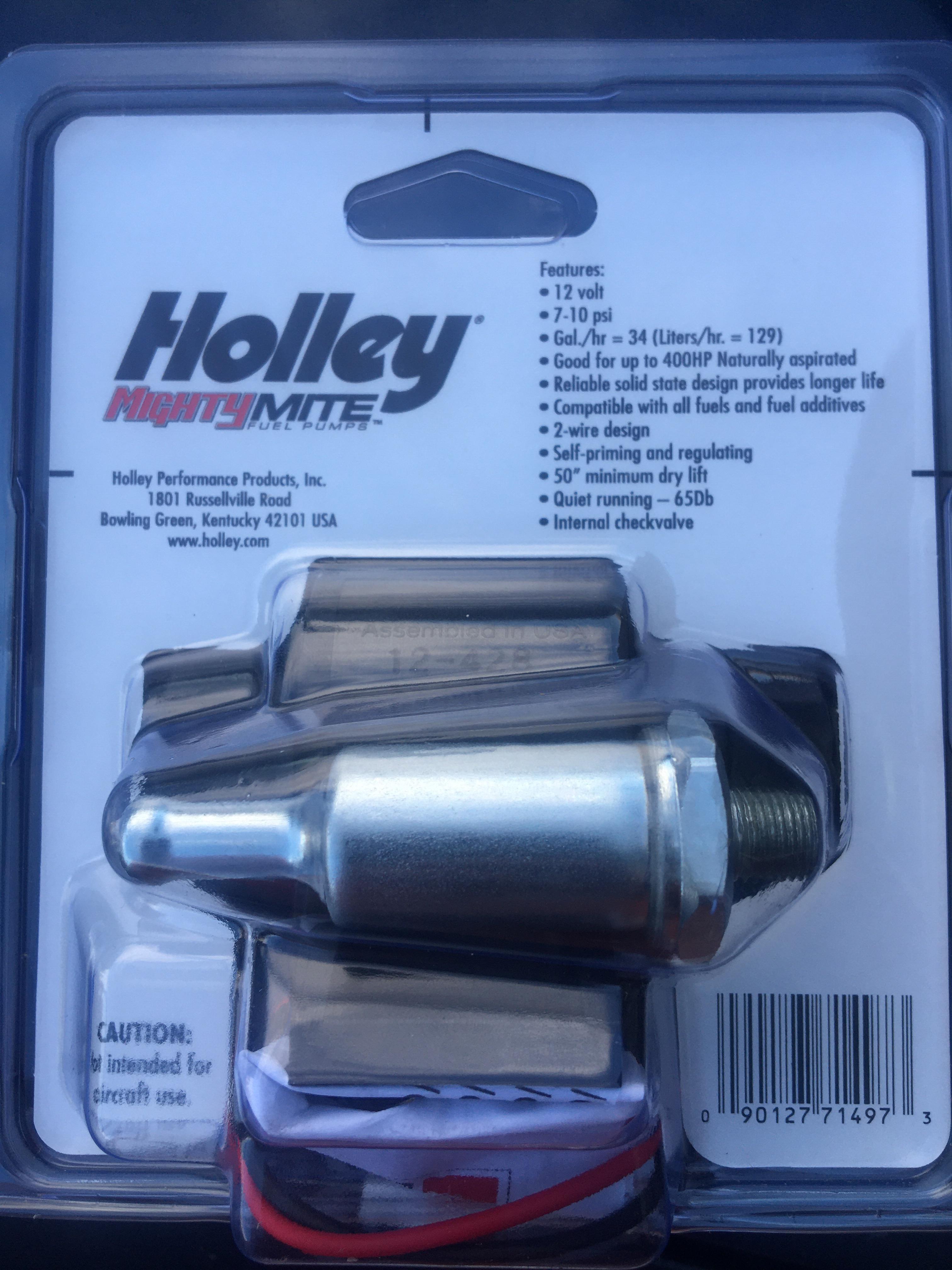

Ended up purchasing the biggest of the 3 models Holley Mighty Mite (12-428) with 7-10psi /34 Gal./hr capability Gasoline/Diesel. Has vacuum pull through ability if it fails and was $88 inc GST, hope it holds up but warranty said given [emoji1696][emoji120]

How much did VPW sting you for that? interesting too, the 4600 is 100gph and the Holley is 34. But the Carter has 1-2 (circa) psi less. Wonder if this makes any difference to ye'old TD42?
$88 inc GST Mudski Mate and I’m only hoping for it to take some pressure off the poor old IP for this trip. Just need it to get me there and back and I’ll look to getting IP rebuilt when coin permits [emoji1696][emoji120]
