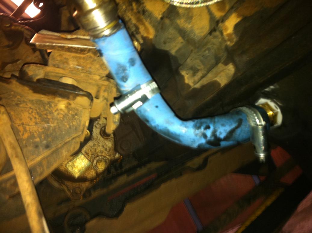

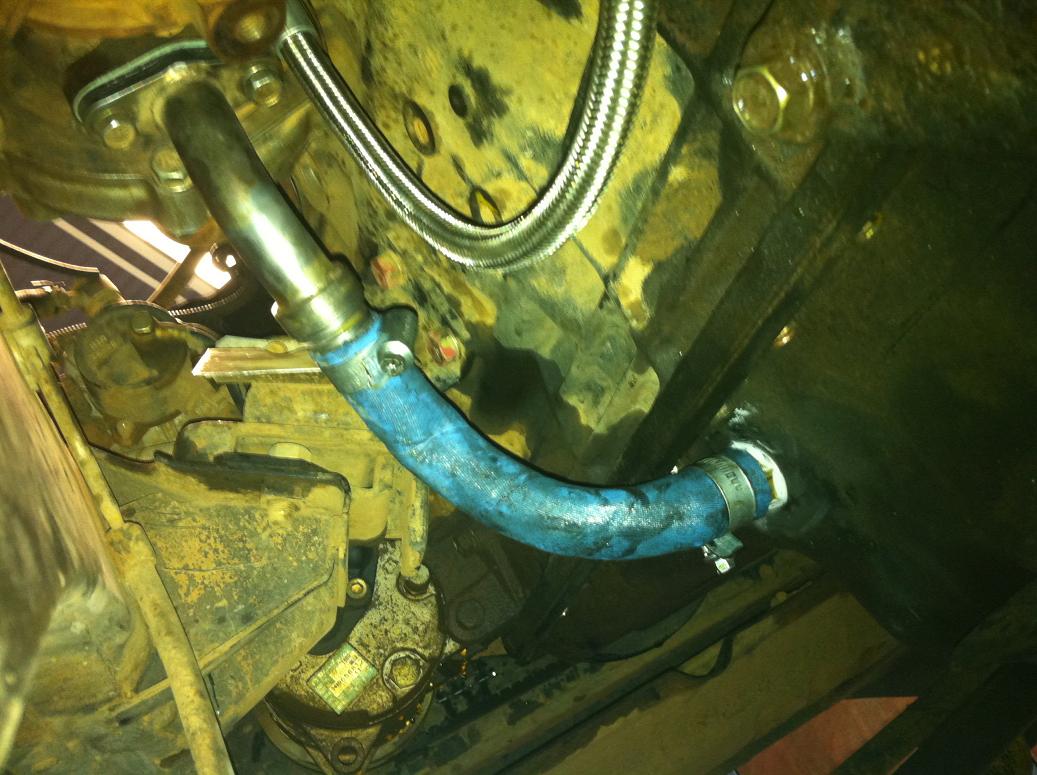

Below is the oil drain pipe hose going from the turbo to the sump (Sump plug threaded already). notice how the hose is kinked which will restrict oil draining. Apparently there is a proper hose that is pre bent for this....You may have to go direct to Nissan to get a hose that is pre bent on 45 degree angles or you can Macgyver style as per the other pics further down.
http://www.nissanpatrol.com.au/forum...2011/08/60.jpg

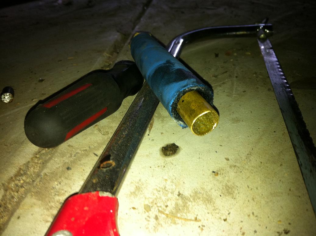

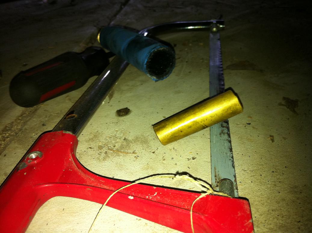

Simply cut a small length of copper pipe....Spend some time sanding the sharp edges off so it does not pierce the rubber hose...
http://www.nissanpatrol.com.au/forum...2011/08/61.jpg
Now, insert that into the OIL drain hose to stop it kinking...Ensure you slide the copper pipe to the exact spot the kink will be using a screw driver.
http://www.nissanpatrol.com.au/forum...2011/08/62.jpg
See below....MUCH BETTER!!!!
http://www.nissanpatrol.com.au/forum...2011/08/63.jpg

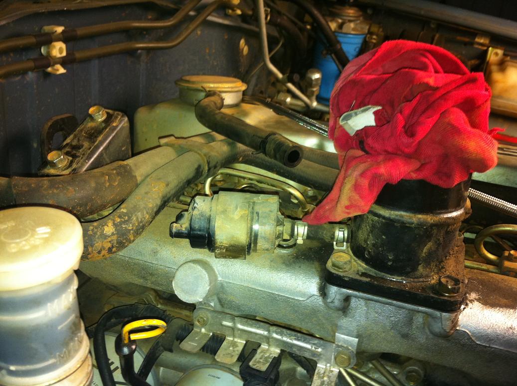

What is this???
What is that filter thing that runs into the inlet manifold flange????
I asked some pretty knowledgeable Patrol owners today and no one knew...
http://www.nissanpatrol.com.au/forum...2011/08/64.jpg

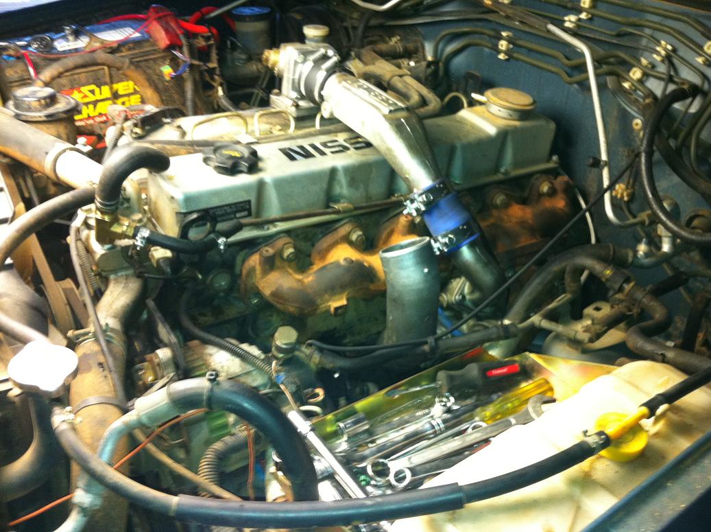

Bolted the turbo up, put all the oil and water lines in and ready for the air filter assembly and 3" exhaust...Coming soon!
http://www.nissanpatrol.com.au/forum...2011/08/65.jpg
