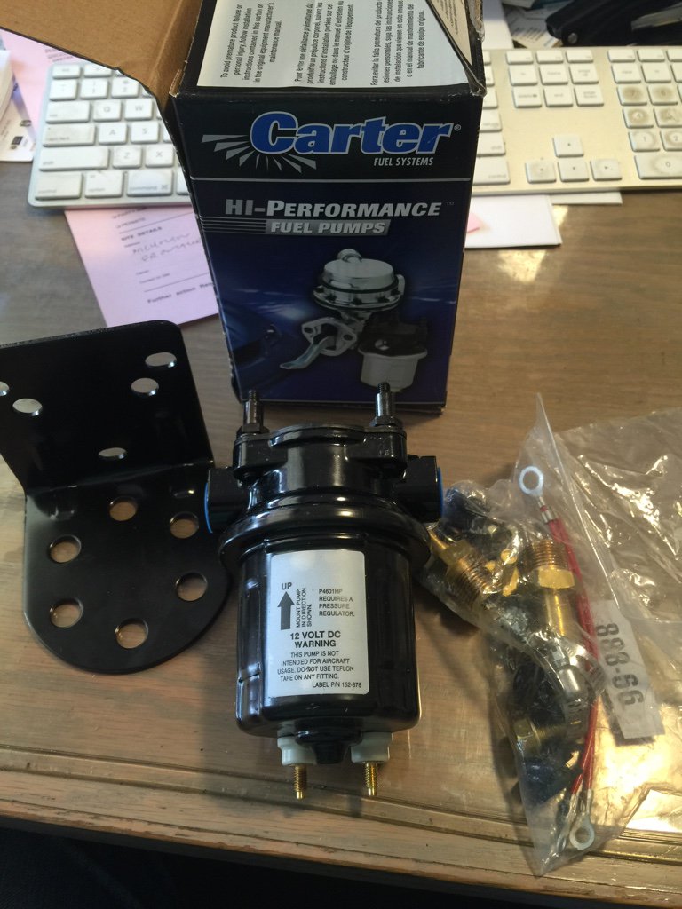

So I ordered a Carter 4601 pump off eBay on Tuesday and it arrived today.

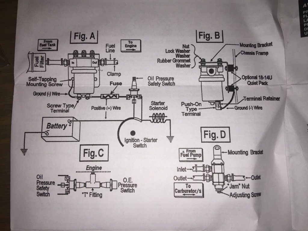

@nissannewby can you confirm I need to take the power from the oil pressure switch on the drivers side of the motor? Or can I take this from anywhere?
http://www.nissanpatrol.com.au/forum...2016/11/26.jpg
Cheers guys.
Its a seperate pressure switch according to those drawings.
I'd be using the pressure switch to switch a relay, not the pump. Separate power and control
I haven't wired mine yet but will just switch a relay via ignition. That was Mat's suggestion too.
