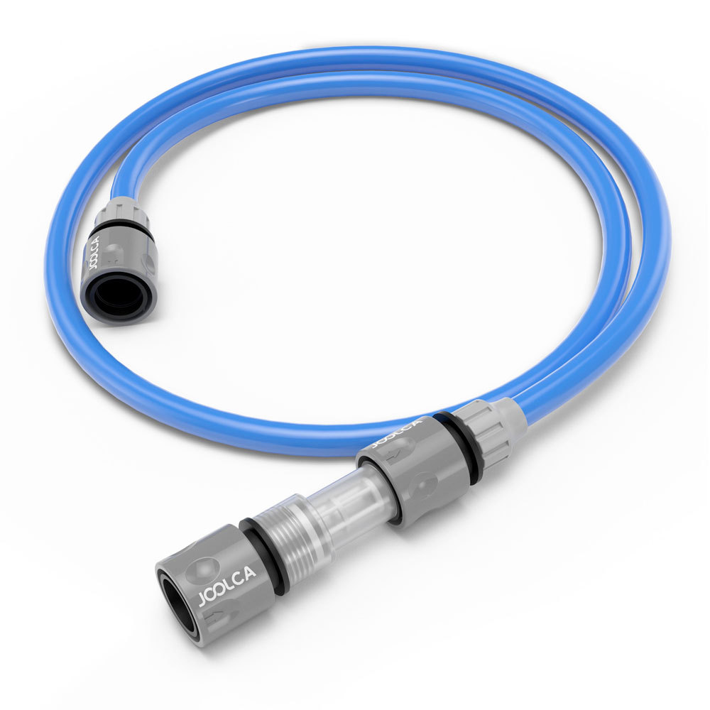

http://www.joolca.com.au/screen-filter
Attachment 68277
