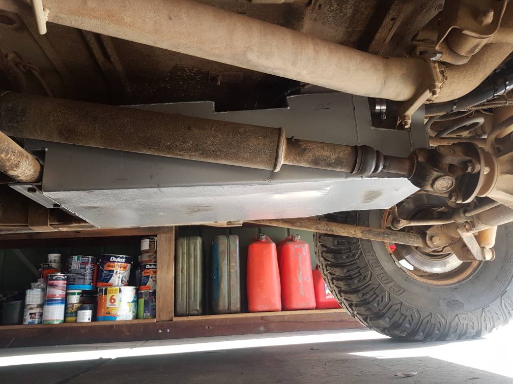

Bit of an update but finally picked up the old GQ the other day from Cornells. Tanks nice and clean and glad to get the sub one professionally cleaned and sealed as was rusty from the days it was a belly tank on dual fuel and probably sat with a dribble of petrol in it most its life, so guess that's a positive to come out of this lol. Also got the injectors tested, were spraying ok but a fair difference in opening pressure so they're sorted now too.

Filled up the main and noticed the bloody thing leaking when I got back so will get them to have a look at that when i get this pump on and back for a tune, some things are never easy lol! . . .

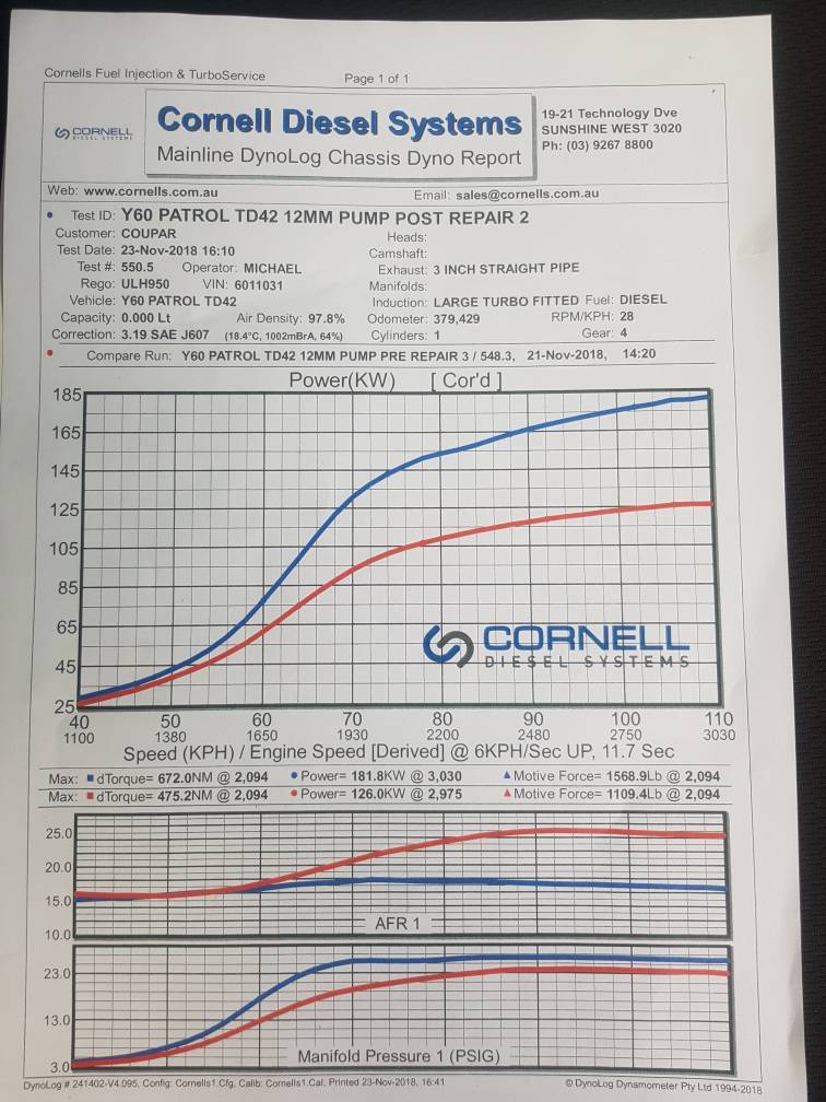

Picked up the old bannga from Cornells and far out pretty happy lol. Fair increase in power & torque, more than i expected as i thought they were going to err well on the safe side of things! Anyway it's under 700nm which I'm happy with safety wise (just!) definitely don't want to go any further but has more potential to give. Low down pull is a Maaaaaasive increase to what it was and has erased any doubts I had that that was the way it was and was normal, response and pull from idle is frick'n awesome! ! Anyway just been driving it like a grandma so far but it's sooooo much more driveable now, can just cruise and it munches up hills with ease. So far egts and temp been very low. . .http://www.nissanpatrol.com.au/forum...018/11/183.jpg

Good outcome Rossco, did they resolve the fuel tank leak or have you sorted that out?

Thats a great result mate. What did they have tonsay about it? Where they familiar with the BW? Is that comparison run your run on day one using the other pump? That is nearlly embarassing if thats the best old mate could get from his own pump!!!
