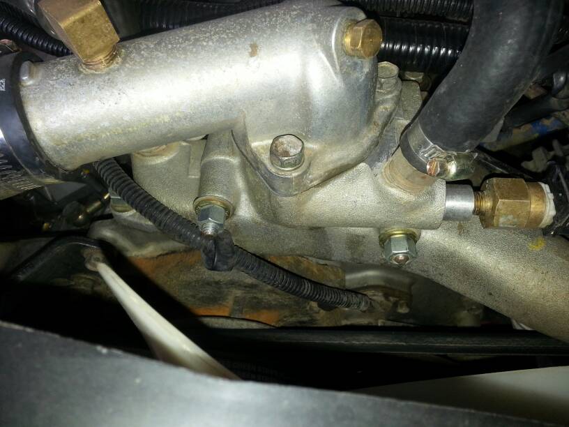

http://www.nissanpatrol.com.au/forum...id=63643&stc=1http://www.nissanpatrol.com.au/forum...id=63644&stc=1
I was just looking at mine and i have studs on the lower housing...
http://www.nissanpatrol.com.au/forum...2016/01/57.jpg
