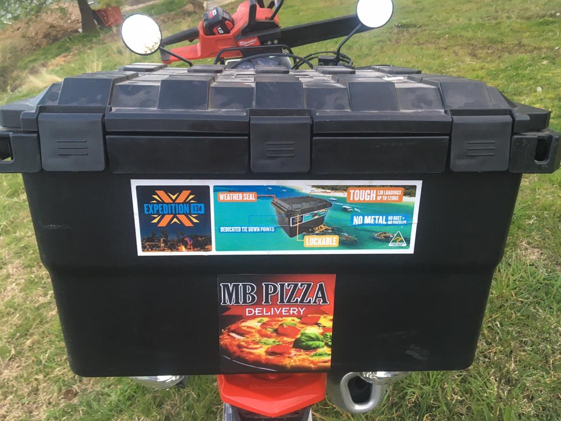

Found a fun way to make a few extra after hours delivery dollars thanks to Expedition 134 :-)

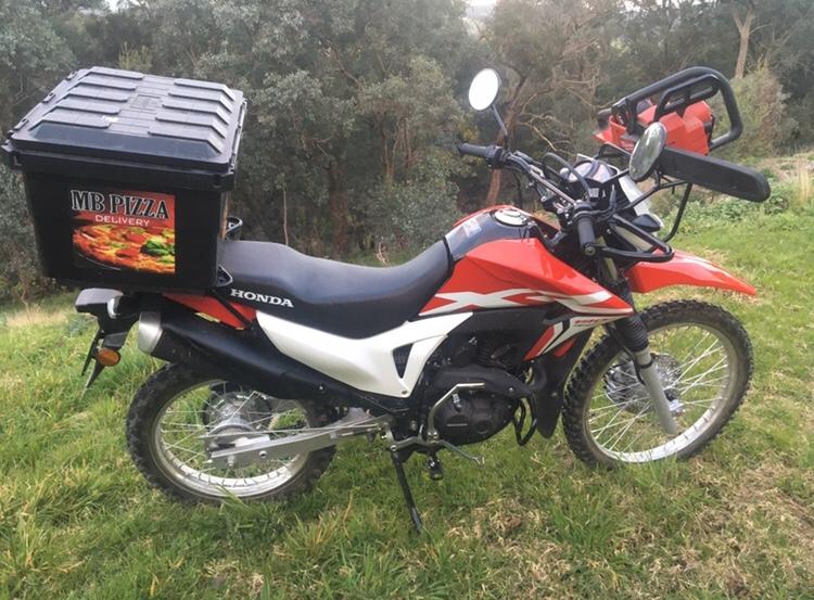

Honestly can’t wait for the release of Ben’s new Slimline model to come for handle bar dessert cartage needs throughout the hills [emoji106][emoji106]

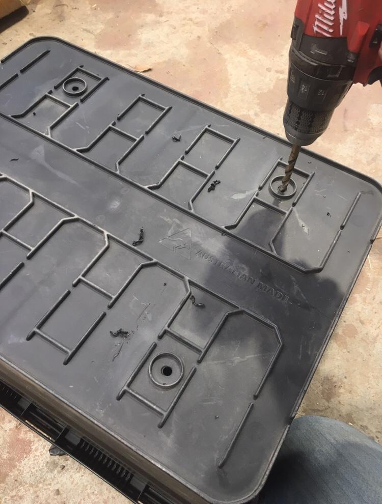

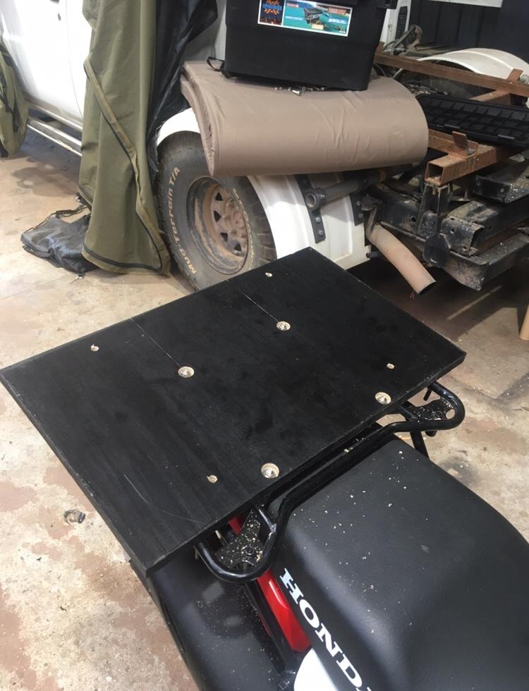

Wow! Good one mate. Looks solid on there. How did you mount it? Did you use the re-inforced drill points or did they not line up with where you needed the holes?
Just an easy agricultural adapter plate out of some formply floating around the shed mate :-)

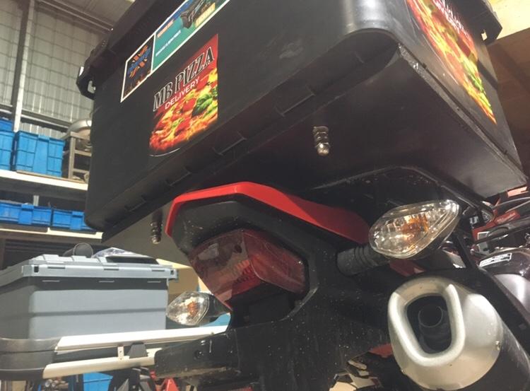

Did you use a large washer on the inside of the box? we put that Circle there so a large washer would pull down against it and spread the load directly through to the surface below the box. Shouldn't split the box that way and hopefully it retains its weather seal and has a solid mounting to boot.
Haven’t as yet mate but do intend to under the already large cup heads once I’m allowed back into Bunnings next year hopefully :-)
