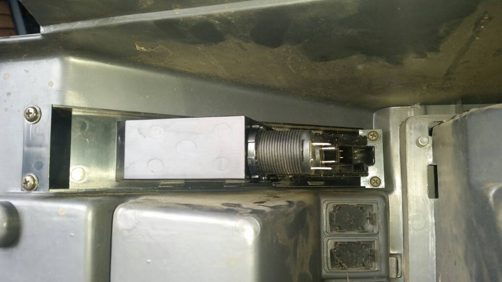

Have you looked at them from the back? There are four screw holes, would be a heaps better mounting option and look heaps better.
I'll take a pic of the back tonight for you.

The way I was going to do it you didnt need to tear half your patrol
apart to fit it. KIS
Thats got angles on it eh Winnie, if that was the case I'd need to make it from 1mm aluminium
not sure that would work looking at that pic.
