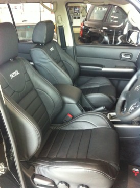

New seats in the next month or two, and then the turbo and exhaust upgrade ... these seats that were posted up the other day would be a treat, but costly through Mr Nissan no doubt ...

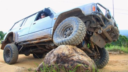

Thinking super flex arms down the track also to give the front end more flex so it sits flatter (photo below shows what I mean - heaps in the rear, but the front just not moving as well as I'd like just yet) - front not flexing as well means car on angle ... not to my liking ...

so yeah, it's definitely getting there, but not where I want it just yet. Without a doubt it's not far off (next 12 months or so) being de-registered and being towed out to locations for a play (but that means I get to buy a street friendly GU!!).

And what post was those seats I wanna know how much they cost?
Not in yet mate - just gotta find the time!! I checked out those seats, but reckon I'll have to call Nissan as I could find nothing online. They are supremely nice looking ...
The ordinal post was a new members rig - a current model/brand spanker and it's lurverly!!!!
