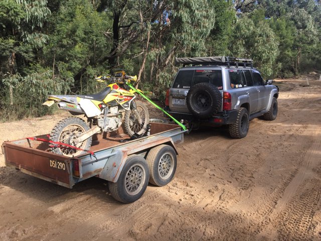

Just a little update, I have not made any changes to the car but drove it today Towing a tandem with a motorbike onboard for a ride in the bush.
A good testing ground for me is the Geelong ring Rd. It has a number of epic hill climbs that used to see me go down to 4th early and even grab 3rd on occasion to control EGT temps off the chart. Today I traveled the road in both direction with the trailer, both ways has a huge hill.
I held 5th @ 105km/h the whole way and caught myself speeding at 115km/h a couple of times. Just so relaxed.
http://www.nissanpatrol.com.au/forum...017/06/184.jpg
