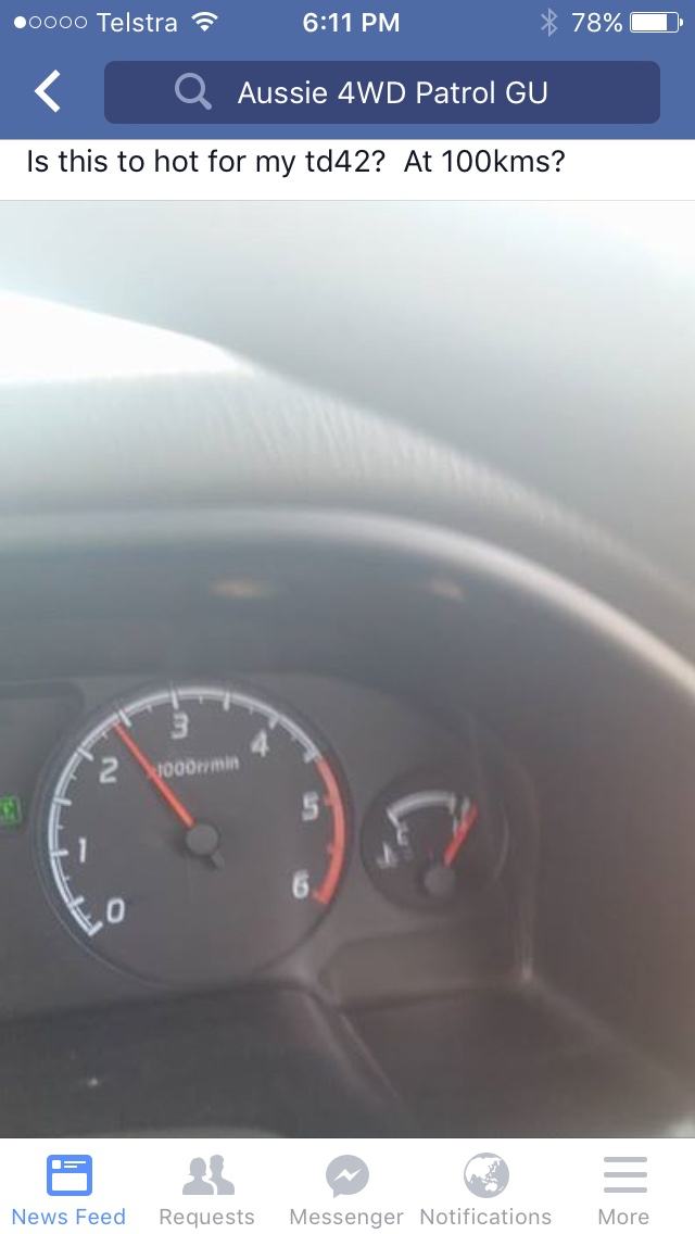

At least you're in a better position than this guy.... Sometimes gotta wonder
http://www.nissanpatrol.com.au/forum...2016/01/13.jpg
Haha, yeah saw that guy earlier, can't be good for it.

The guy said the light was stuck on....
Can I respond here to a thread on another forum? Lol
Sure can... Haha
