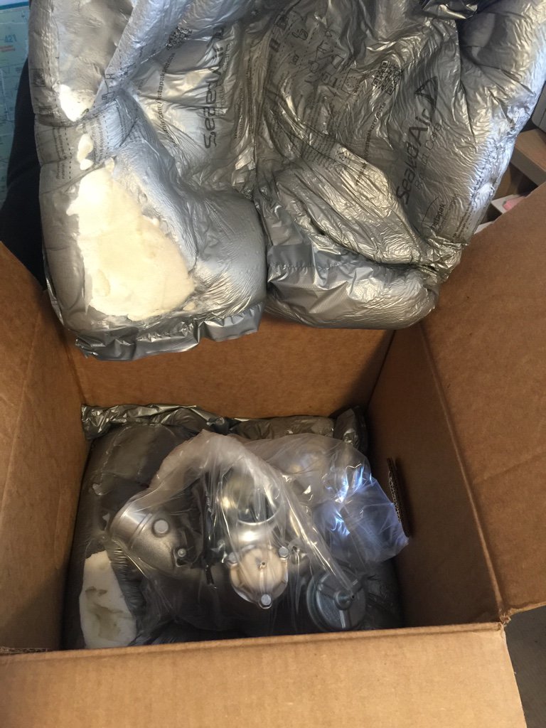

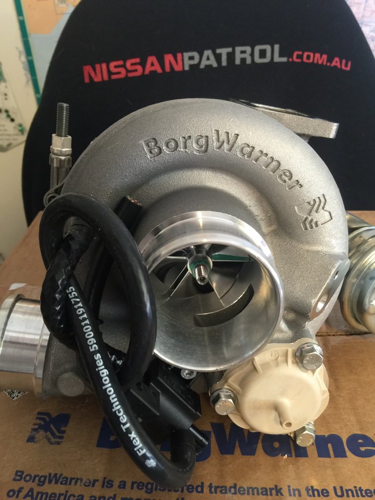

It's bloody big mate! Looks wicked!
http://www.nissanpatrol.com.au/forum...016/11/134.jpg
http://www.nissanpatrol.com.au/forum...016/11/135.jpg
Box inside a box I think for plain wrapping to limit customs duties maybe?

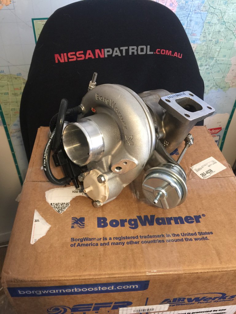

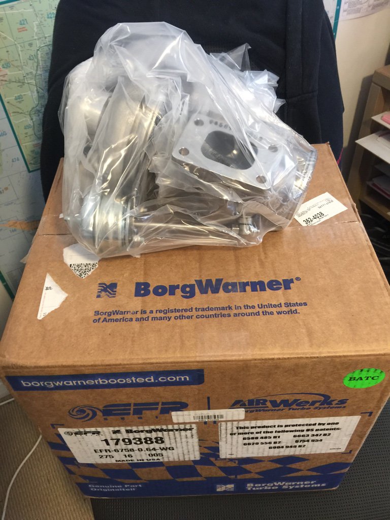

I like it a lot!! Beast of a thing mate.
That'll look good on me Scott Bonner lawnmower
Its actually quite small. I have the next frame size up on mine it makes that one look like a toy.

Have another Borg Warner EFR6758 coming for a 06 GU IV up here. Also retaining the standard pump for now but have a nice big w2a unit going on.
