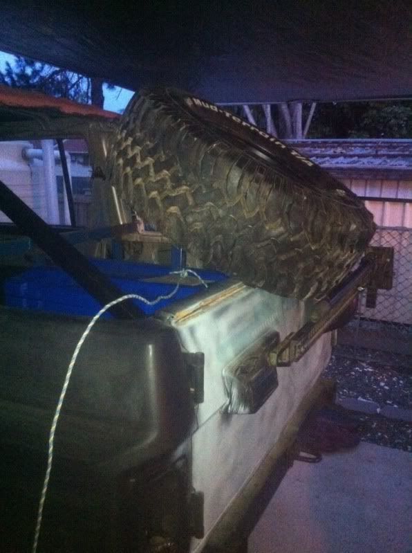

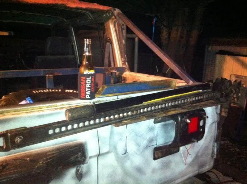

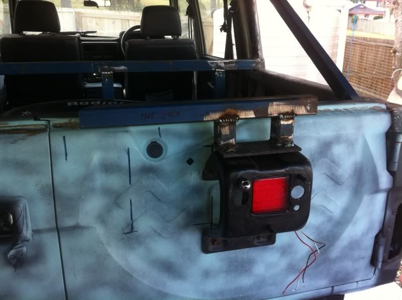

Well a few Friday arvo beers and the forum stubbie cooler keeping the beers at chilled temp. So a few mods for tomorrow. The original wheel carrie will hold my hight light jack, and will house a rear work light, 2 water carriers. All removable so I can put the spare back when on the touring trips
yep, definitely liking that chop very muchly, top effort there mate......... looks the goods

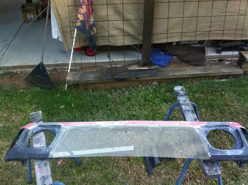

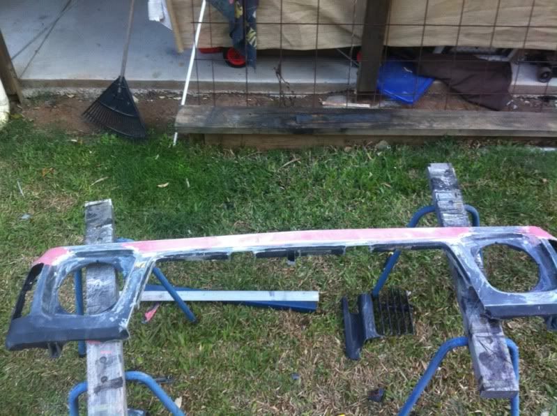

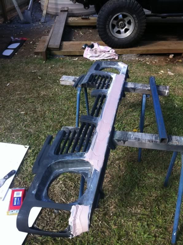

Stream lined the front grill. Puttied up all the grooves for something different again and meshed up the middle. paint the grill black when I do the rest of the car.

Thatll look tuff as mate

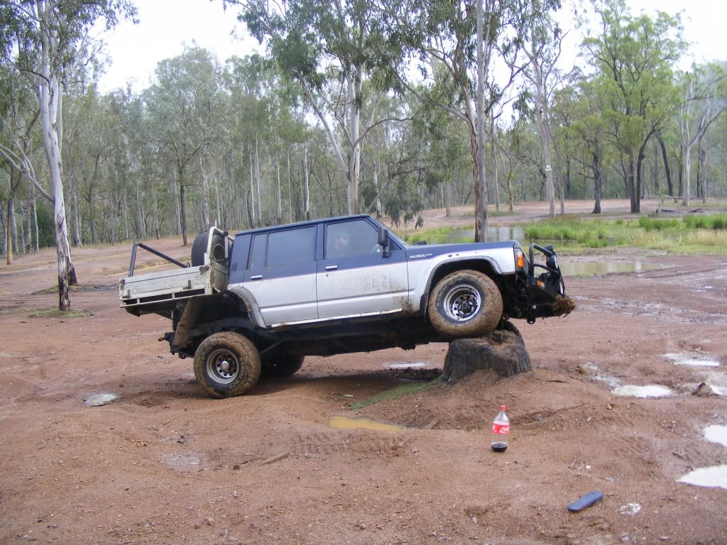

Cheers Yort, Nothing wrong with your beast, see your flexed up on the Famous Stump up at LCMP.... Keep out of that pig pen mate, a quick splash in that play area and your paint will start stripping..

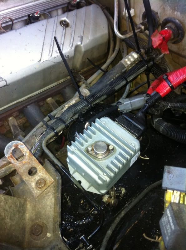

Put my mechanic skills to work and found the problem to the gq.
http://i223.photobucket.com/albums/d...y/2242ba0e.jpg
Ignition module went, as there really expensive I did a exchange change over for a rebuilt one.
Plug it in. Started the gq and it kicked in. The mighty 3" straight through exhaust opened with a bang. Not knowing my staffy pup was under the car. He shit himself and bolted and jumped for joy it was only a $190 fix.

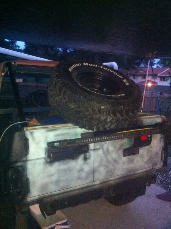

going to turn my double door into one...make a Bracket off the rear door for spare wheel and finish it with a comp style wheel lock nut... This way I can still use the original wheel mount when I go on longer trips.
The wheel will sit right onto the high lift jack and act as the main support.
