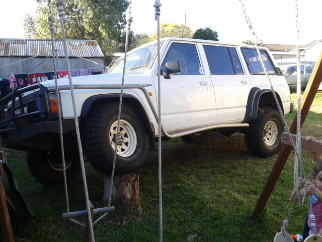

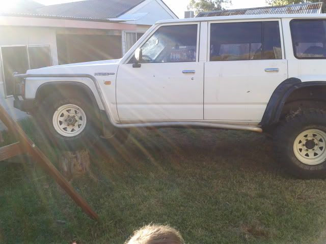

Anyways heres some pic with the new 33s.

Just taking the rear seat and the usual carry around chains straps etc was enough to lift the rear on mine quite a bit.
Doesn't take much.
Mine sits that high loaded with toolbox with all my chains straps, jacks etc in it.
