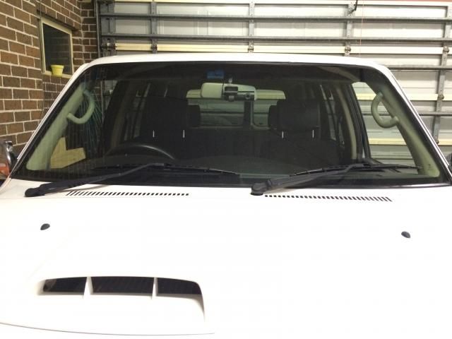

While I was installing my overhead switches I ran all the wiring for the dash cam, it just fits behind the mirror. I'm contemplating painting the back of the mirror a dark grey to hide the camera a bit.

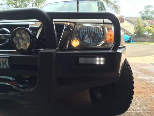

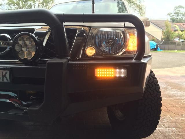

While I was at it I also threw in a set of LED parker/Blinkers (LED Autolamps 175AW). I had these on my previous ute and they were fantastic. No more filling up with mud and rusting.
http://i1083.photobucket.com/albums/...ps12c07a72.jpg
http://i1083.photobucket.com/albums/...ps10c14508.jpg
http://i1083.photobucket.com/albums/...pscbc148e3.jpg

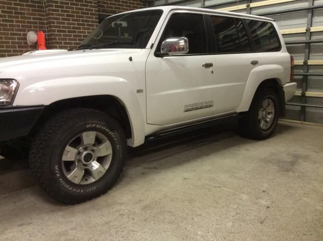

Thanks Skip, it's starting to come along. I'm starting to look at suspension packages atm. Current thinking is 3" lift (not too high, not too low), Superior springs and Profender adjustable remote res shocks. Then to bolt a set of 35's onto it.
An Opposite Lock Slim Line (Windcheater) roof rack and 40" Aurora light bar might slip in there along the way too. I'm thinking maybe a 2m rack as opposed to a 2.2m rack is better as it keeps the light bar back a bit from the top of the screen....

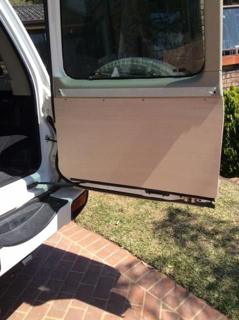

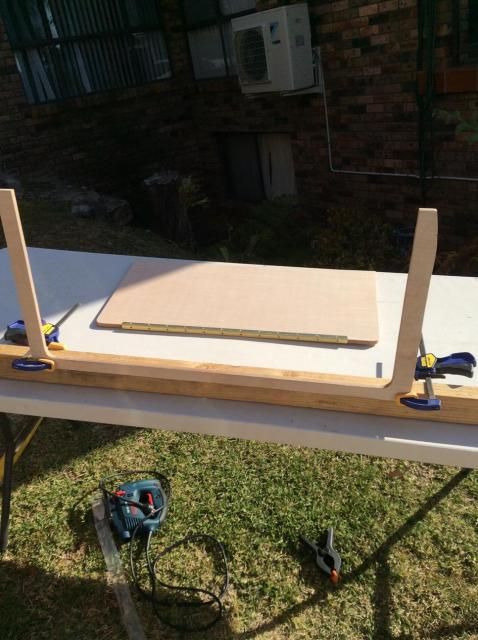

Started building my barn door table on the long weekend
The replacement door card (6mm Marine ply)
http://i1083.photobucket.com/albums/...psdc3294c7.jpg
and the table (12mm Marine ply), a few screws and some glue then ready for a coat of paint.
http://i1083.photobucket.com/albums/...ps34b7f5d5.jpg

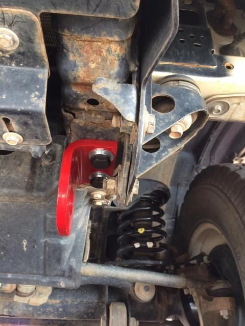

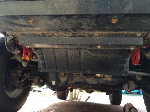

Well slowly getting the new bus ready, today I installed some front recovery points (not that I'll need them :cool:)
http://i1083.photobucket.com/albums/...ps3ccebda6.jpg
http://i1083.photobucket.com/albums/...psc704d79f.jpg

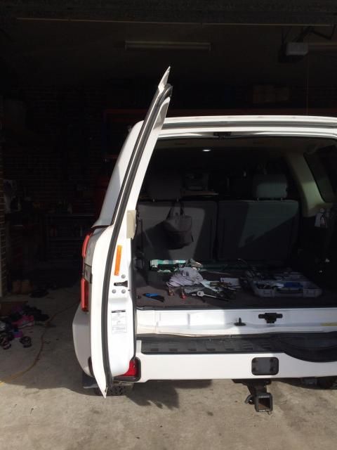

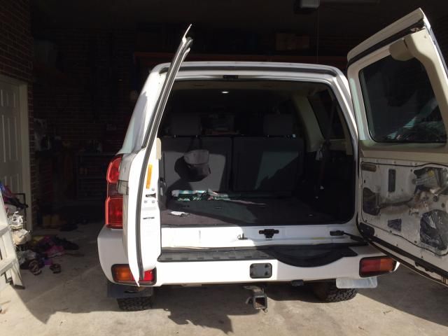

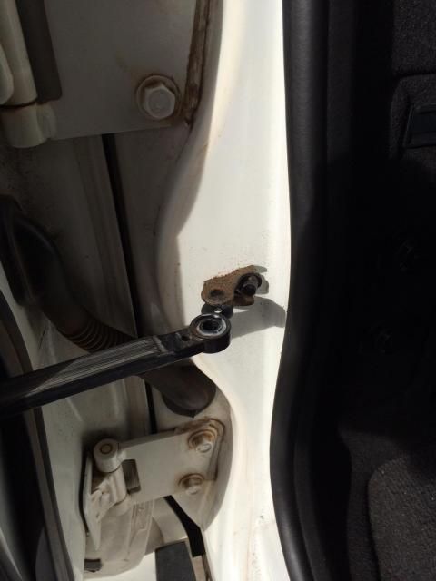

Also installed a little extension bracket so the small rear barn door opens up to 90 degrees
Before
http://i1083.photobucket.com/albums/...pse18ad5d1.jpg
During
http://i1083.photobucket.com/albums/...psd24e6785.jpg
and after
http://i1083.photobucket.com/albums/...ps55deccb6.jpg
It's not much, but you can see the extra opening amount where the door lines up against the tail light in the rear bumper, makes all the difference for the mounting position of the fridge.

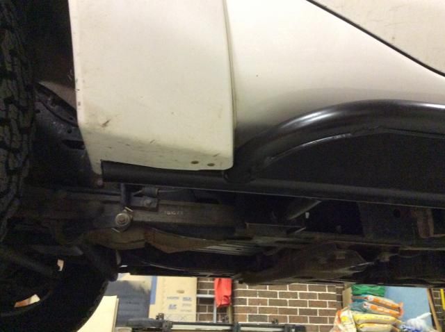

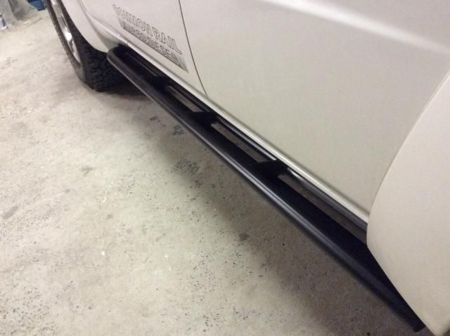

- Sliders

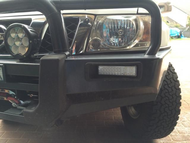

Been a big weekend for Rockets bus. First up I put a new set of lights on the front, these things seem to work pretty well :D
http://i1083.photobucket.com/albums/...psb7c38b45.jpg
http://i1083.photobucket.com/albums/...ps1985aded.jpg
They kinda draw heaps more amps than the other set so a whole new wiring install was required.

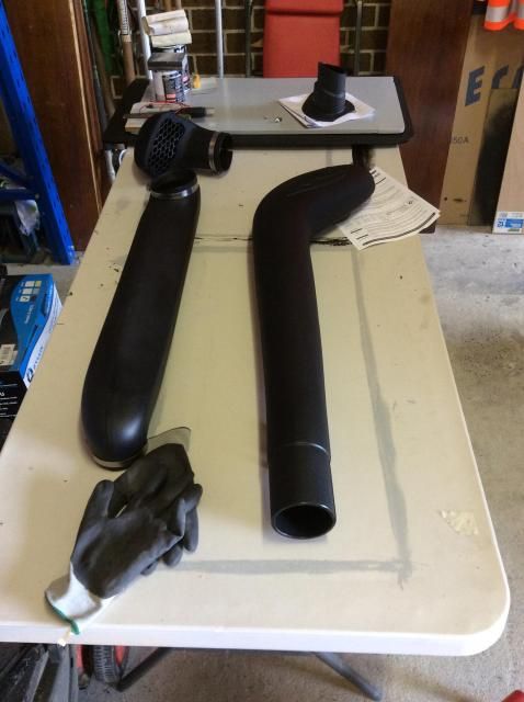

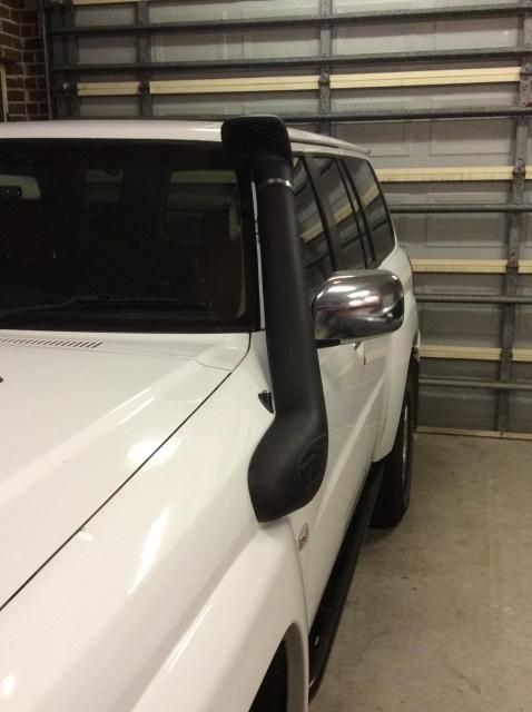

Now for the scary bit, time to mount up the snorkel. I opted for a TJM snorkel, well, because I like the look of them, nice and neat.
Laid out on the installation table, you can see my barn door table on the end of the table. This is just needing another coat of paint and then it goes on too.

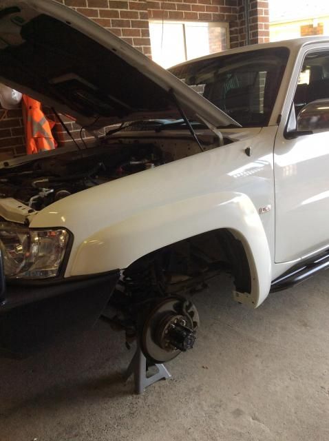

The clean up and guard preparation, I gave it a quick polish, easier to do it without a snorkel on. Jacked it up, put it on a stand and removed the wheel for access.
http://i1083.photobucket.com/albums/...ps9aaa3c61.jpg

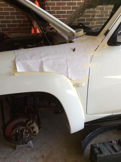

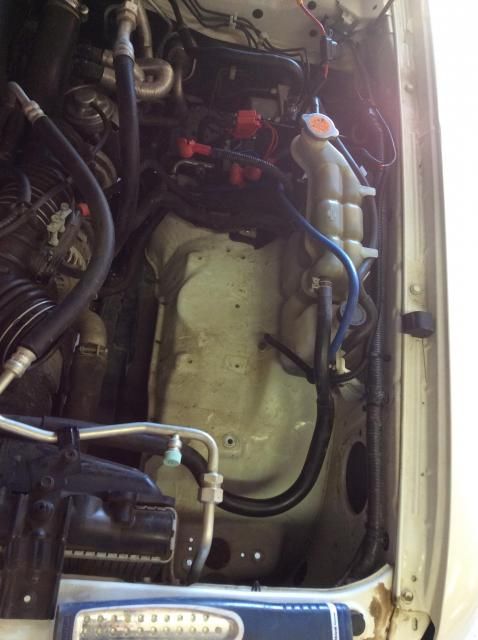

The strip out begins, airbox out, battery and tray out, inner guard out, arial out.
http://i1083.photobucket.com/albums/...ps05bddca3.jpg

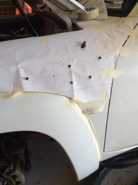

Stick on the template.
http://i1083.photobucket.com/albums/...psb1e727f8.jpg

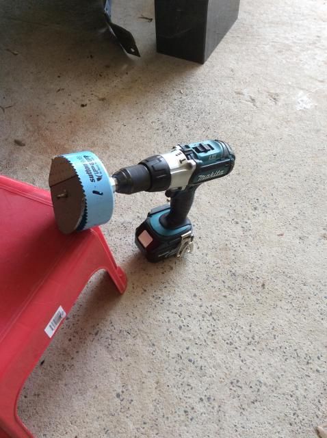

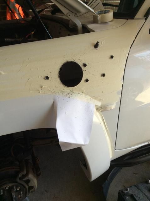

Centre punch, take some brave pills and drill some holes. Always feels better after the first one and nothing happened. I don't know what I was expecting to happen after all it's just sheet metal, but I had visions of the drill wandering around across the guard, the car falling off the stand, something blowing up... anyway it all went pretty smoothly :D
http://i1083.photobucket.com/albums/...ps6ae42c9d.jpg

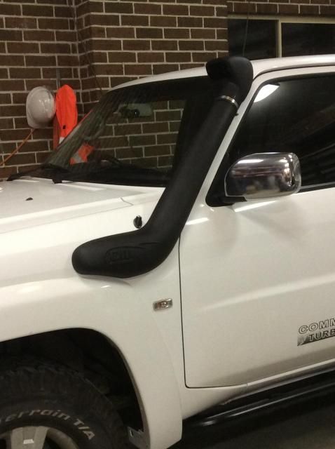

Now time for the big sucker, 111mm diameter. More brave pills, get a grip and just do it. Nice steady pressure, a good speed, not to fast and not too slow, although I did find that it worked better when spun faster that what I thought was a good speed. I found on my 3 speed drill, I was in 2nd gear at about 3/4 rpms. Remember to stop regularly as you can generate enough heat to burn the existing paint and cause it to bubble away from the guard, well at least that was the tip I was given by TJM when I picked up the snorkel.
TIP: mask over the rubber strip between the flare and the guard, as hot filings will burn into the rubber (again I was told this by my friendly TJM store).

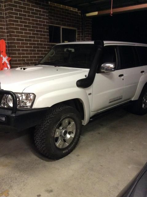

Phew All done 8-)
http://i1083.photobucket.com/albums/...ps45a2ddf5.jpg
http://i1083.photobucket.com/albums/...psaa22eab6.jpg
A bit of stuffing around, stacks of Sensor Safe Sikaflex 227, a few swear words, late for dinner and whollar its on :D
http://i1083.photobucket.com/albums/...ps77e32944.jpg
http://i1083.photobucket.com/albums/...ps446583b6.jpg
