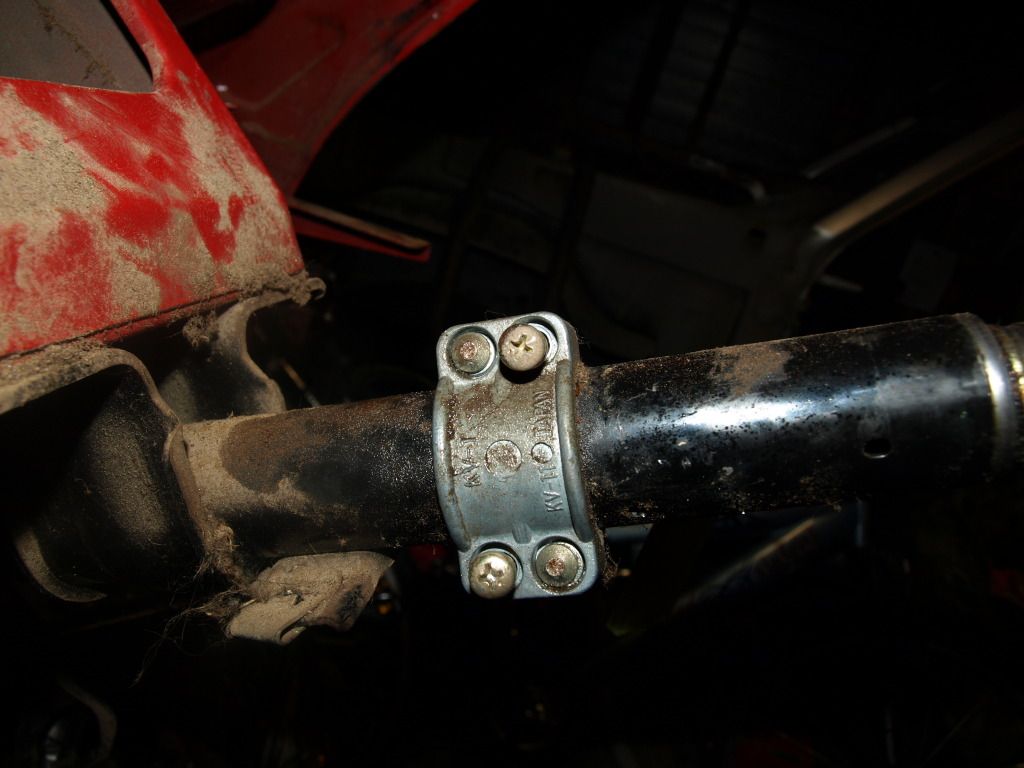

The steering colomn,undo at the steering coupler ,rubber thingy that bolts the steering colomn to the steer box,then undo the steering colomn under the dash,4 bolts from memory

The steering coloumn has a fixed bracket on it that attaches to the dash via 2 bolts, the bracket is fixed to the coloumn and will interchange between the 2 bodies
On the steering coloumn it has a cylindrical thingy that bolts to the firewall, that cylindrical thingy is fixed to the coloumn also,and this needs to be unbolted from the firewall for the steer coloumn to be removed
Personally, unbolt the steer coloumn at the steer box, and leave it all attached in the body youll be using, then when the body is refitted to your desired chassis,youll only have to rebolt the coloumn to the steer box,and its done, plus fitting the ignition lock and the light combo switch,wheel stuff like that

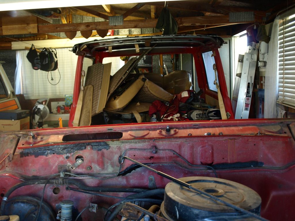

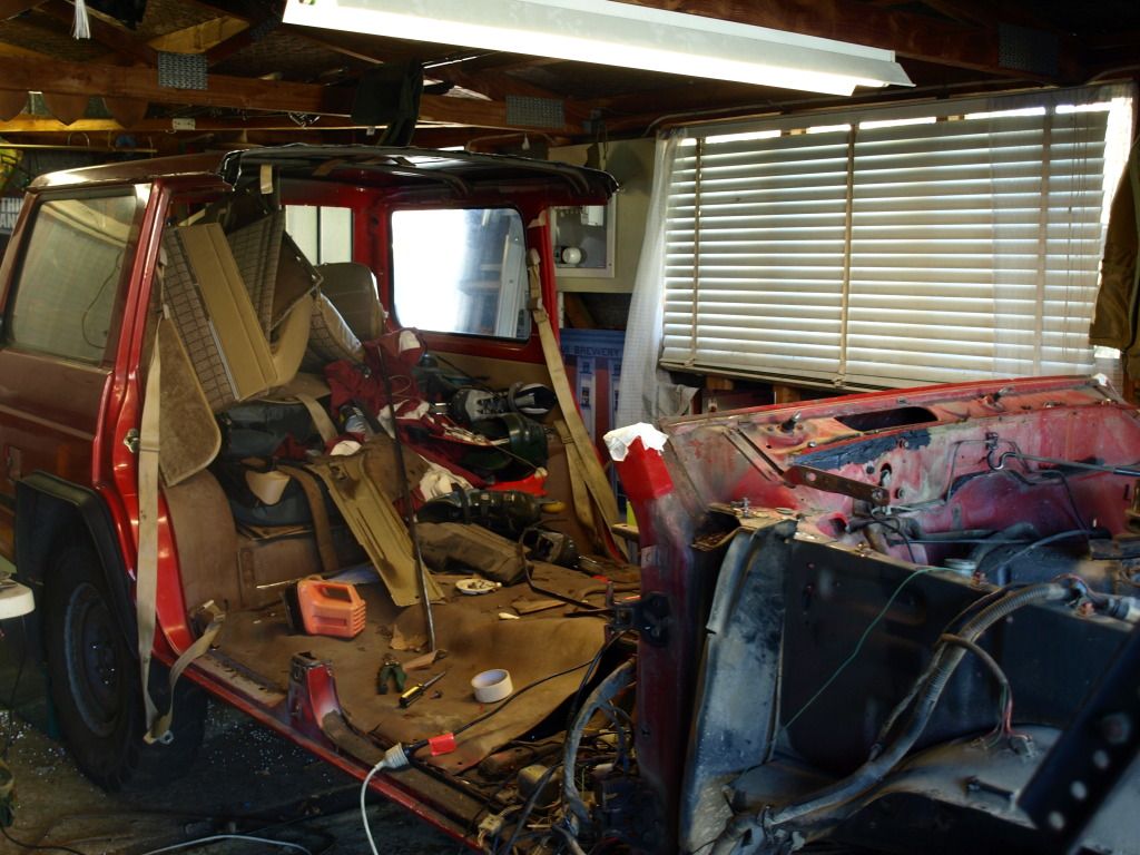

Removed the dashs from both Vehicles and pulled the wiring loom from the engine bay into the cab. Will post some pics tomorrow, wish I took some before and after shots though as have a few loose ends I've got no idea wtf they go LOL.
Found more differences between the MQ/MK but have posted those pics on the MQ/MK differences thread to prevent double ups.

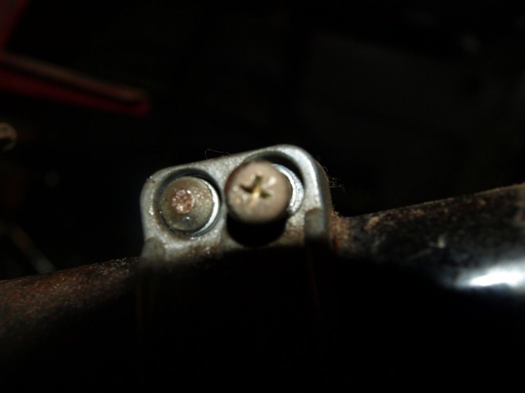

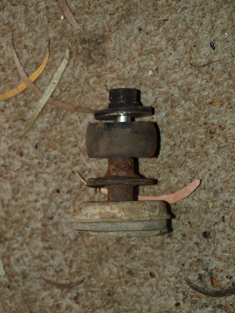

Went to remove the key barrel however found that I was only able to take out 2 of the four bolts
http://i1100.photobucket.com/albums/...u/00100373.jpg
http://i1100.photobucket.com/albums/...u/00100372.jpg
the other two seem to have been filled in with something, any ideas on how to undo them.?
