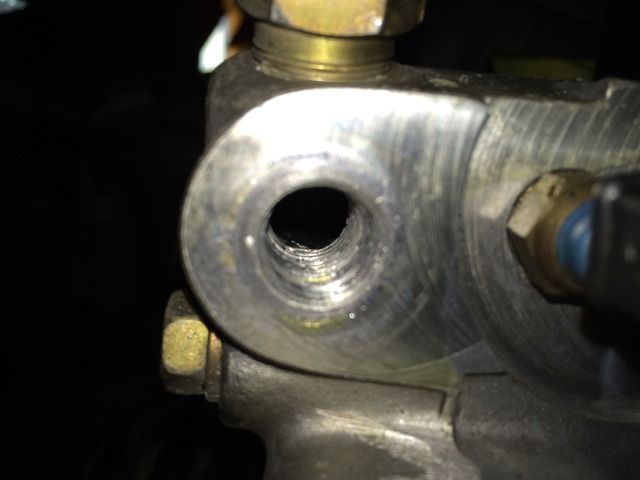

If your thermo sensor is still out, can you do me a favor and measure the thread depth in the hole ? As in how far in is the hole threaded.

The long bolt moved a tiny bit then sorta loaded up again, so I stopped and retightened it, lossened it, etc. a few times maybe on 1/8 of a turn each time, then I sprayed it with WD and went and had dinner,etc. A couple of hours later had another go at it and out it came. They ow have neversieze on them. The original thread is probably only 10mm deep as the 12mm plug only has about 3 threads on it. I ran the NPT tap as far in as I could, which was probably about 20mm.
It's a little blurry put this is probably the best pic I have of the newly threaded hole.
