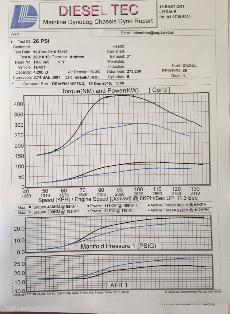

So here are the tell all sheets!
All reports show the Blue line as the Drive in Baseline measurement.

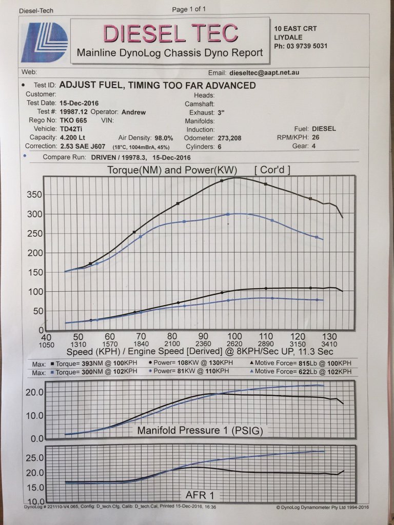

First report is tuned to 108kw and 393Nm of Torque. Note the steady climb in power peaking at 2620rpm. I was making about 60kw at cruising hwy speed of 2000rpm. Not ideal. I'd be forced to tow in 4th just to get into the power band
First Tuned Run. No pump timing check

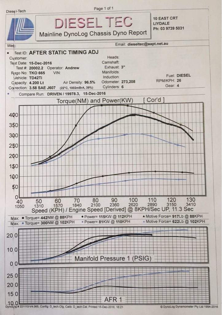

Bit the bullet and retarded the timing back into factory specs.
Ta Da!!

Quote "Takes a lot to Impress me..... I'm Impressed!" Completely moved the power curve back into position. Boost came on and stayed!
Epic!!
So by now the car was suffering from Heat Soak and every Dyno run was loosing so we had to rest it to cool.
Bloody happy though.
Here is my Mock Up of the 3 runs over each other. Sorry I did not get the 16g run but it's basically the same but earlier.
