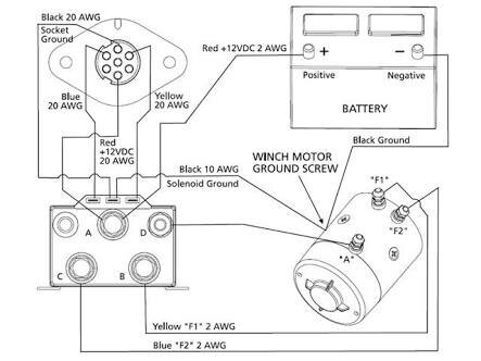

The temp wire is to get power for the switch? That's what I got from the pic.
You say that the earlier pic is incorrect re power in/out. How why?
What is the right way?
If it all worked I was going to slice that temp wire into the black wire.

Just noticed that you added a pic. I have seen this and will try to work it out using that.
