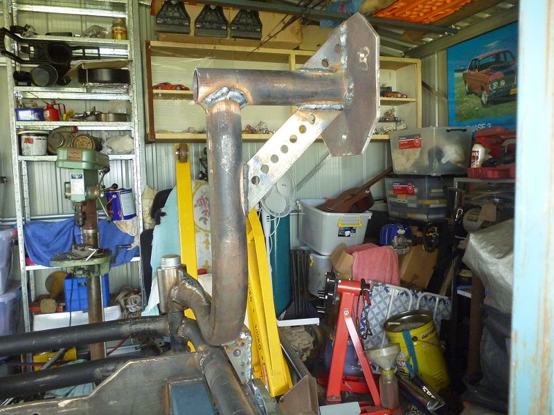

Well, had a good run this morning. Basically all I need to do now is to make the bracket for the lights.

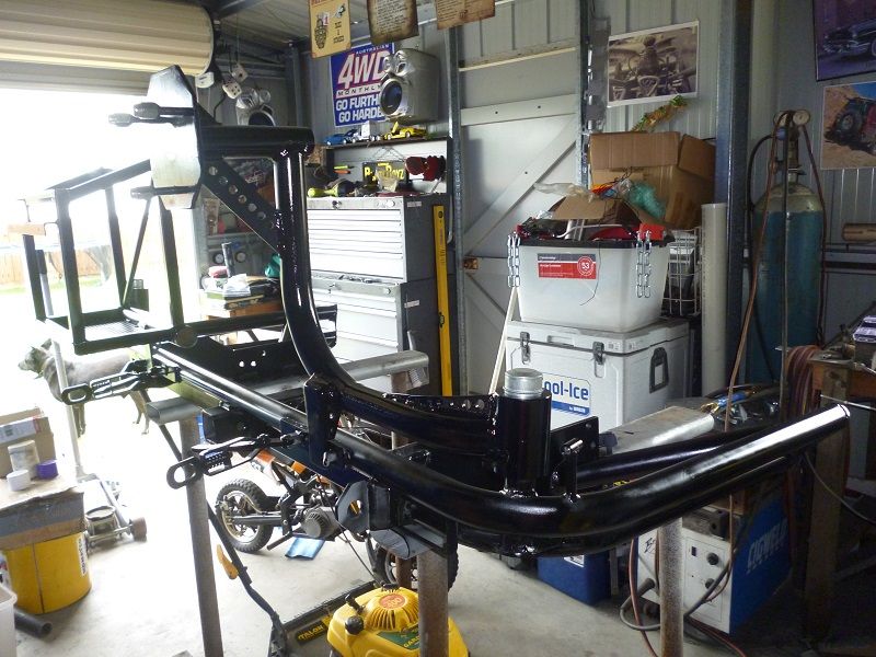

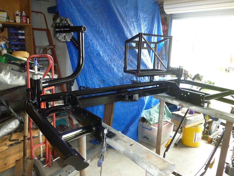

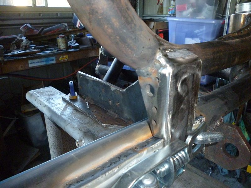

OK boys & girls, this bar is done & dusted. Ready to be fitted up next weekend.
http://i244.photobucket.com/albums/g...ps4d1765f4.jpg
http://i244.photobucket.com/albums/g...psdd6d9bef.jpg
http://i244.photobucket.com/albums/g...psbeeb7c12.jpg
http://i244.photobucket.com/albums/g...ps142fda10.jpg
http://i244.photobucket.com/albums/g...ps3af660a9.jpg

Is that a homemade jobbie or a refurbished one, either way looks Schmick. Well done if its a garage jobbie.
Thanks mate.
I made it from scratch mate. The complete build up of it is this thread :bigthumbup:
Me thinks you should use my GQ to build a prototype for the GQ's ( I get to keep when finished ) then go into mass production for both GQ and GU rear bars
Could be arranged :biggrin:
Hold up, paying customers first. Lol

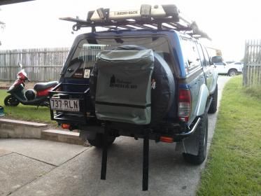

A couple of teaser shots of the rear bar fitted.
http://i244.photobucket.com/albums/g...ps418f8304.jpg
http://i244.photobucket.com/albums/g...ps697ff432.jpg
Was dark when we finished, will get some better daylight photo's soon.
Wholy Hell that's a bar... Don't run up your ass.. looks tough as
Same idea I had though with moving the hitch up inline with the chassis to increase the decent angle.
How does the fuel tank look? Will it need more protection without the tow bar there?

The fuel tanks on Nav's are in front of the rear diff, so no drama's there.
The over center latches (the ones that lock the carries closed) I got from Ovesco, the locks (the one's that hold the carriers open), I made myself.

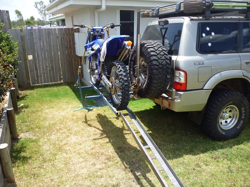

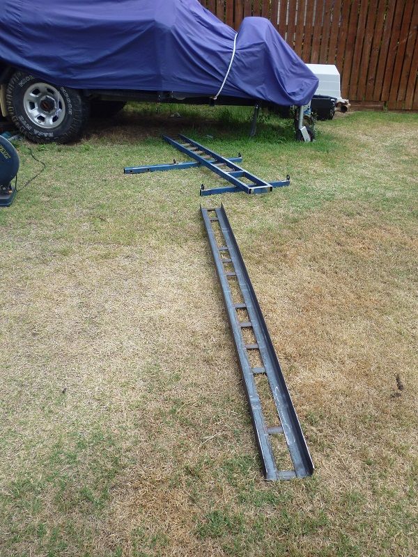

Built a motorbike carry rack for my mate's Patrol..........
http://i244.photobucket.com/albums/g...ps9bd4cf5d.jpg
...with ramp...
http://i244.photobucket.com/albums/g...ps15563be3.jpg
....fitted to the Patrol (Patrol has 35's & 6" lift).......
http://i244.photobucket.com/albums/g...psaac1d7aa.jpg
http://i244.photobucket.com/albums/g...ps321d2b8e.jpg

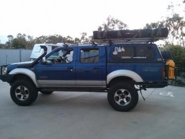

Latest edition to The 'Troll..................

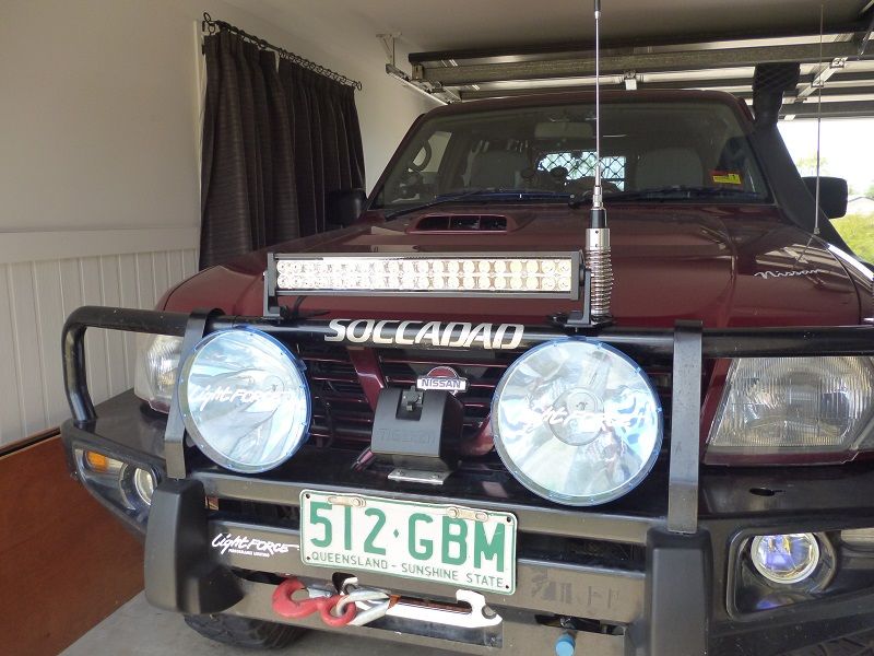

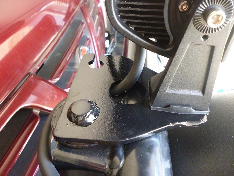

Made some new mounting brackets for my LED light bar...................
http://i244.photobucket.com/albums/g...psebb09927.jpg
http://i244.photobucket.com/albums/g...psfde7d0af.jpg

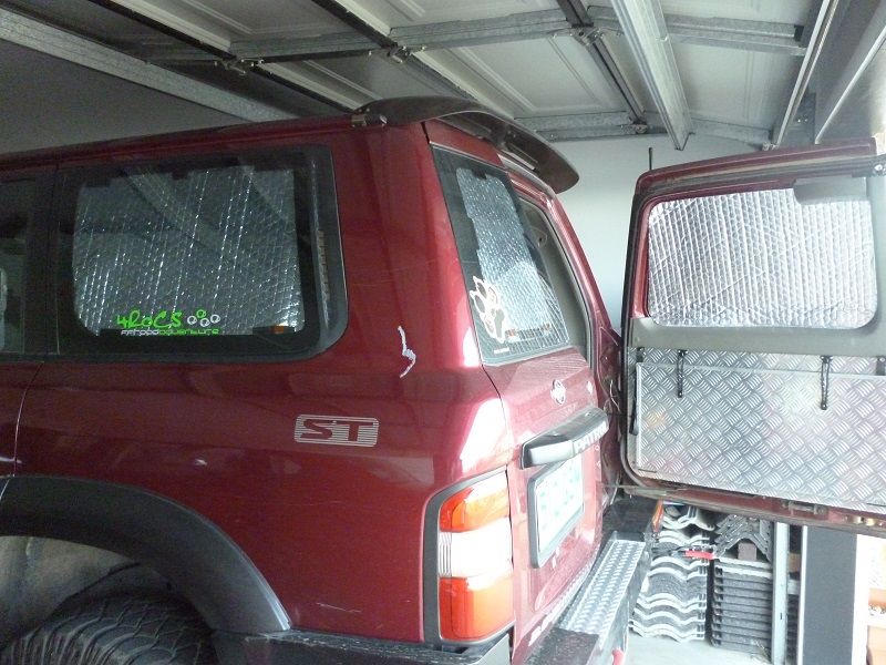

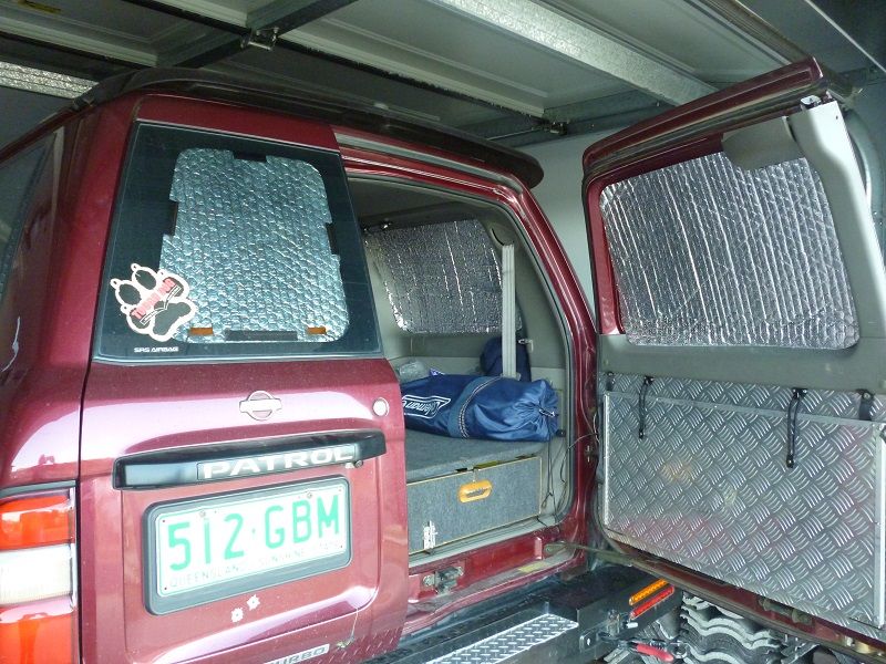

Also made some sun shades for the back ( couldn't justify the exorbitant price they where asking on the internet :i2: )
http://i244.photobucket.com/albums/g...ps7fe0be01.jpg
http://i244.photobucket.com/albums/g...ps78be54ed.jpg

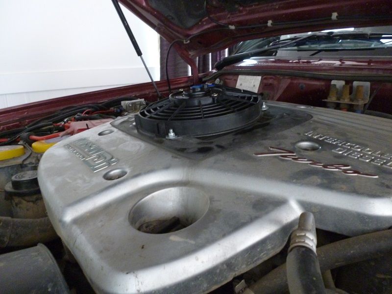

......and mounted a thermo fan onto the intercooler..................
http://i244.photobucket.com/albums/g...psc80bc17d.jpg

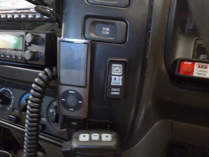

Installed my new Intervolt battery isolator & momentary switch to link the 2 together, just need to tidy up the wiring...........
http://i244.photobucket.com/albums/g...ps60af6353.jpg
http://i244.photobucket.com/albums/g...psa69be9b6.jpg

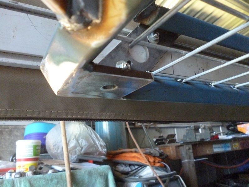

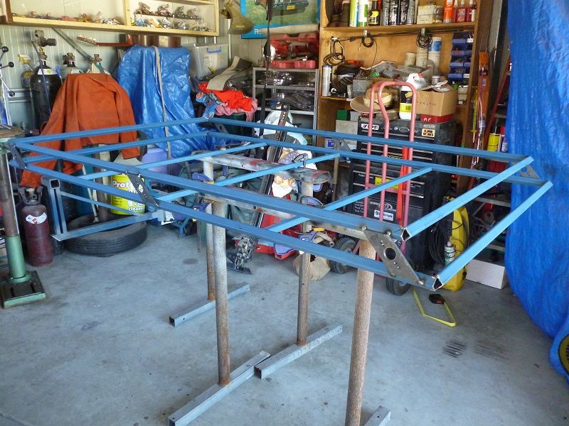

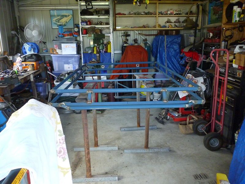

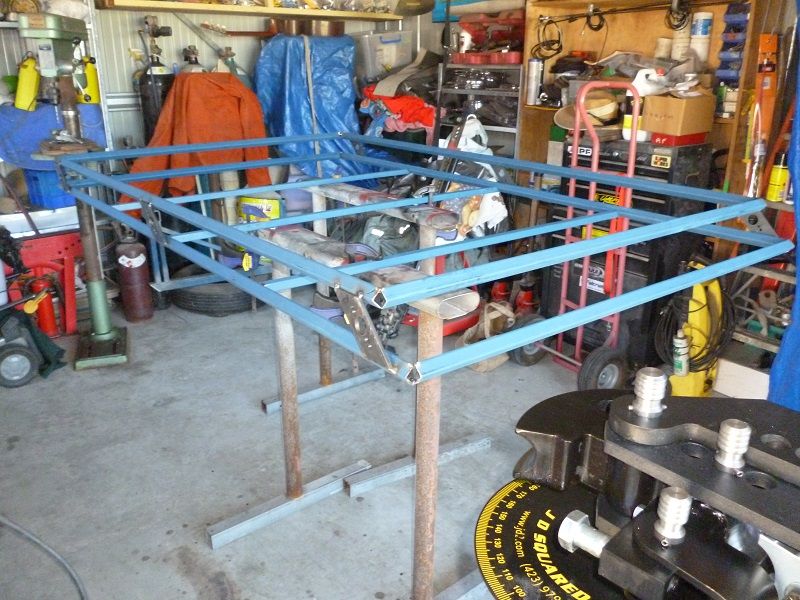

Started making my new roof rack for the 'Trol this afternoon.........................
http://i244.photobucket.com/albums/g...pse8a90f99.jpg
http://i244.photobucket.com/albums/g...ps4c989831.jpg
...............it's made from 25x25x1.6 mm RHS stood on it's edge for the main frame, & the cross braces are 20x20x1.6 mm RHS. I used 50x6 mm flat bar for the uprights.
Thanks mate :smiley_thumbs_up:

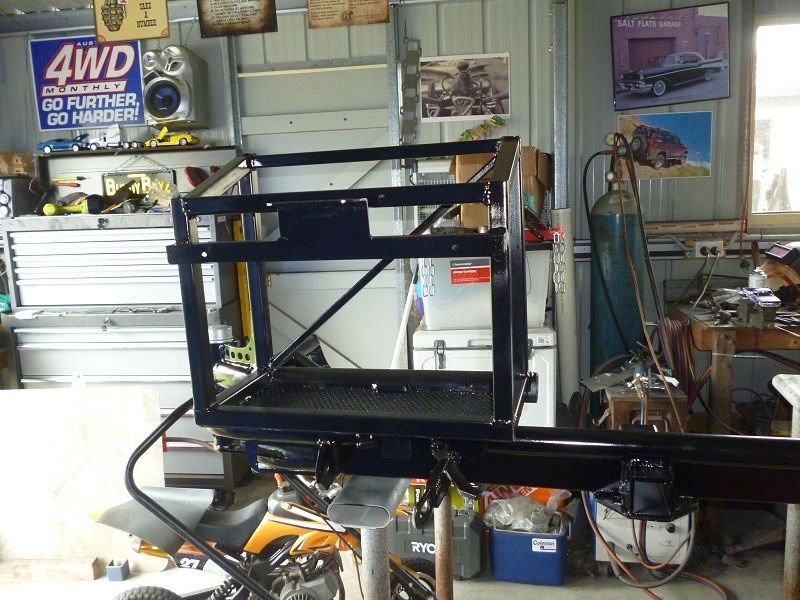

Got the rack almost finished this morning. Made a light rack out the front, just need to cut some 3mm plate & weld in. Then need to clean it up ready for painting.
http://i244.photobucket.com/albums/g...ps2b166d5b.jpg
http://i244.photobucket.com/albums/g...ps992a11e6.jpg

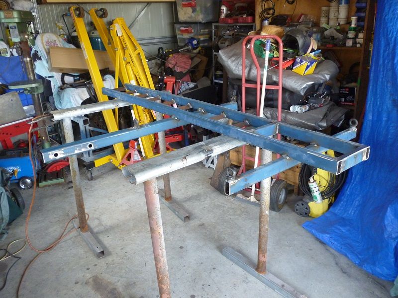

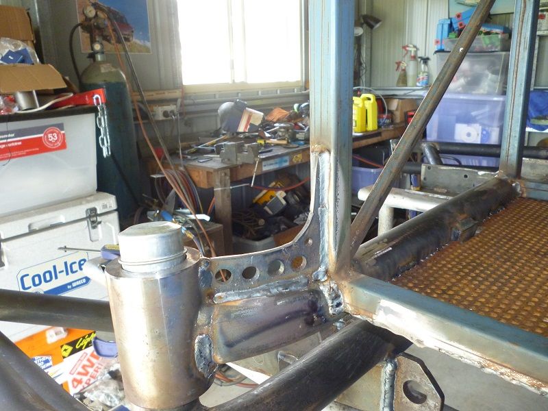

Spent a couple more hours today cleaning it up ready for paint. Welded in the mesh floor, & made the brackets to mount the rack to my Rhino racks.
http://i244.photobucket.com/albums/g...ps7857d04a.jpg
http://i244.photobucket.com/albums/g...ps7767149b.jpg
http://i244.photobucket.com/albums/g...ps71debc99.jpg
http://i244.photobucket.com/albums/g...ps092d0fa9.jpg
......tomorrow will have to go & buy a little bit of sheet for the light rack.
