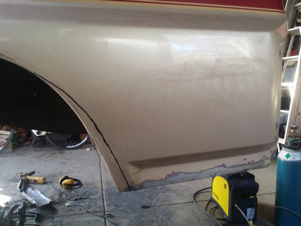

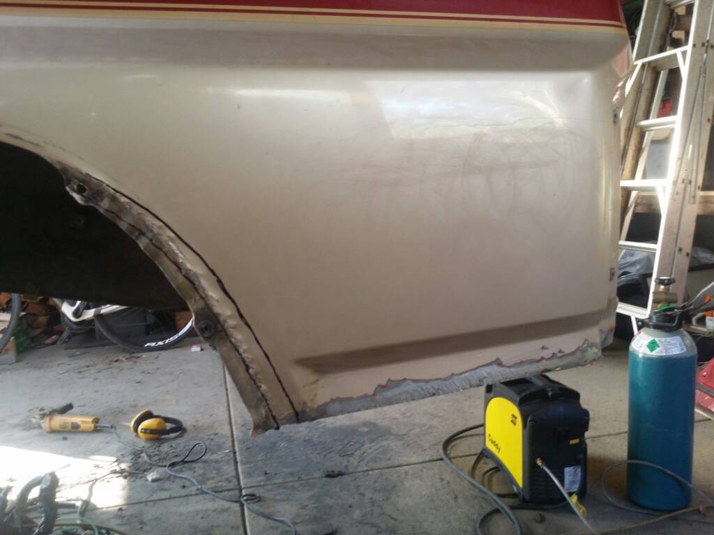

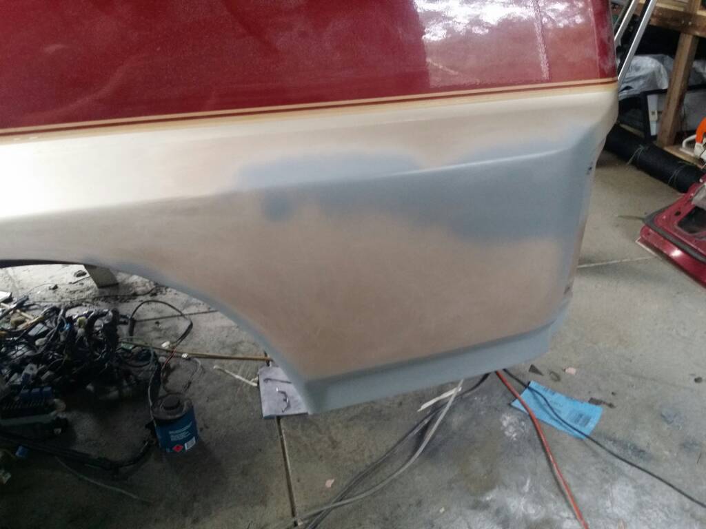

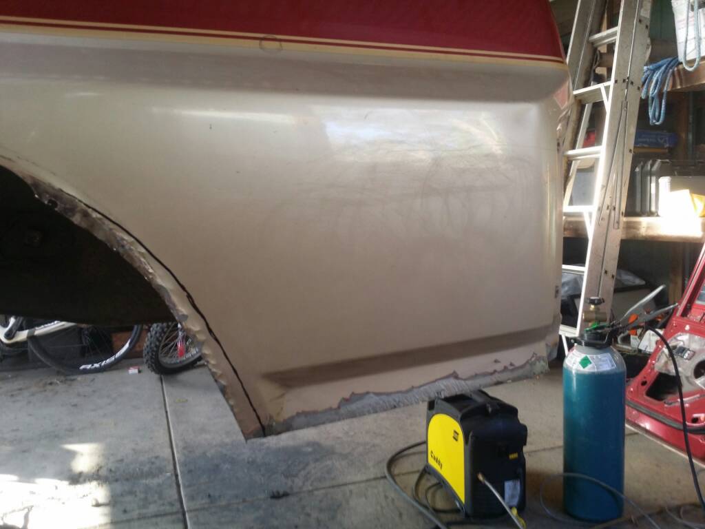

Made some more good progress in the shed. Quarter chop finished, bogged, sanded & primed, put some seam sealer on the inside too & painted. Fixed a couple of tiny dings the rest is pretty perfect.
Trimmed the rear guards a little. Was easier than i thought really, I've usually just bashed them back a little hack style, but did it a bit more properly this time.
Marked out new fold line, bent out old tab, flattened with some vice grips then marked cut line, cut, bent new crease slowly slowly then kinda bashed it square - came up pretty good. Just did the rear of the guards, looks like there's 15-20ml to be made at the front from trimming the plastic trim thingy so will just do that.

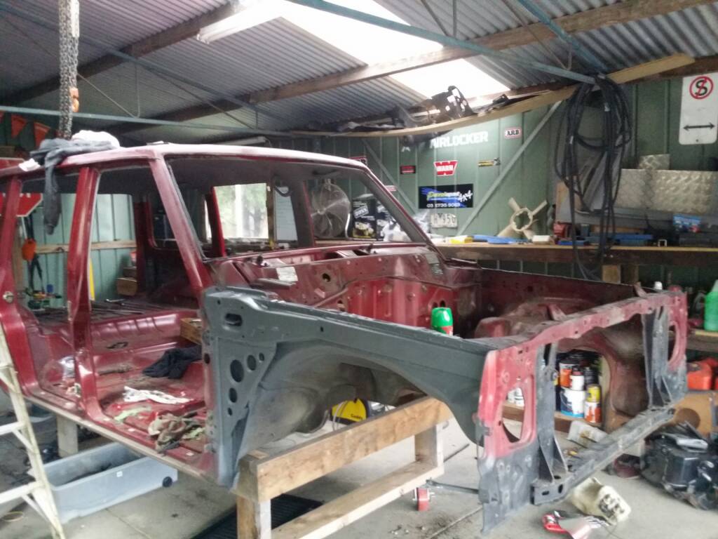

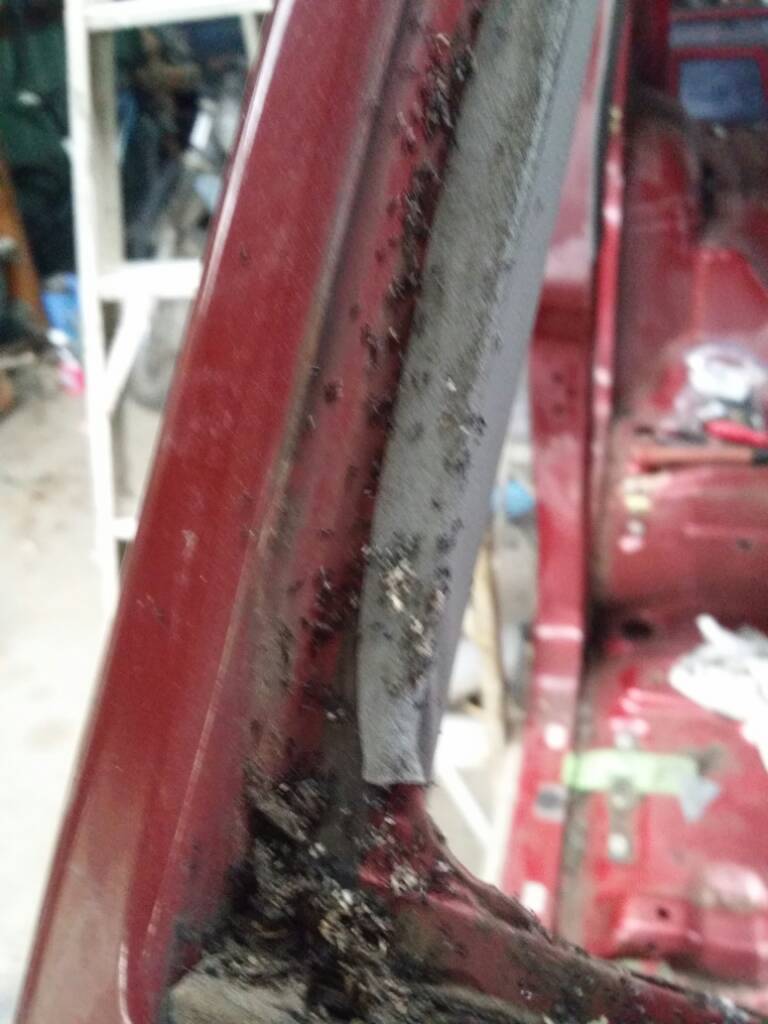

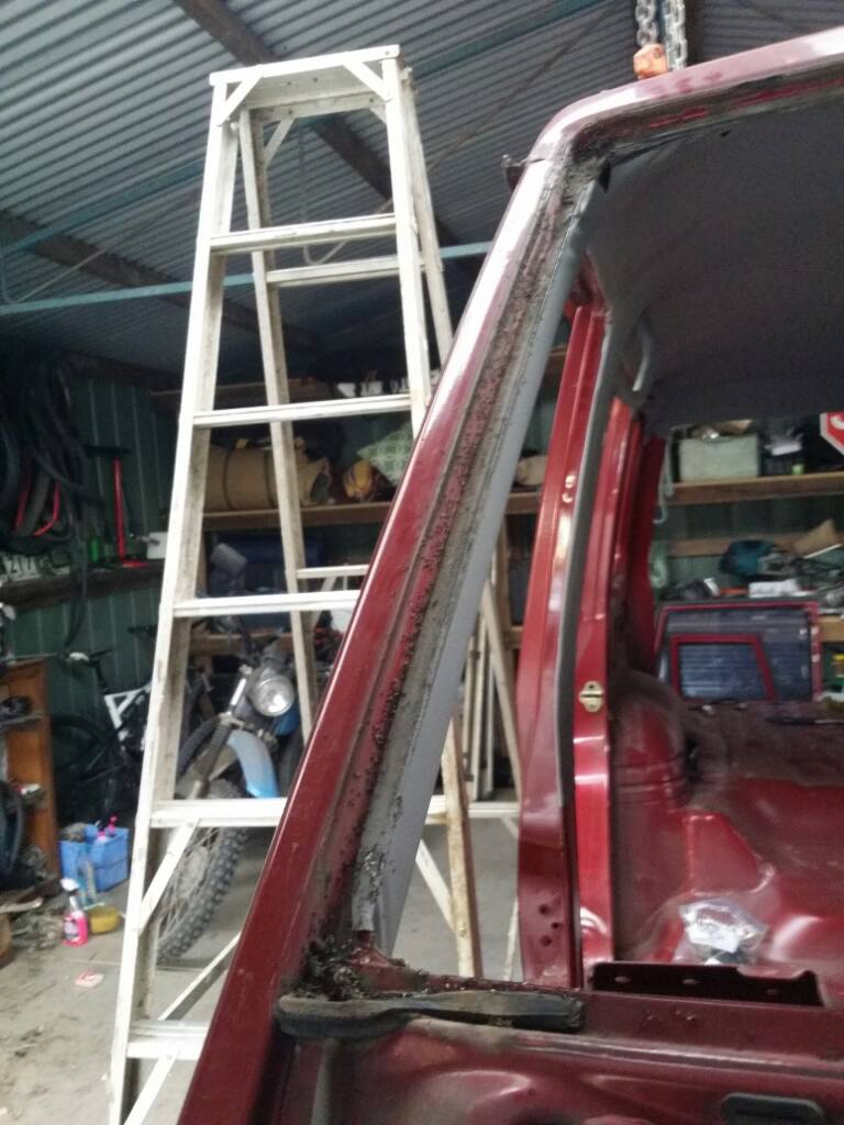

Pulled the windscreen out, found there was a big home for ants in the seal so had to get out the old mortein. . Sorry ants but glad their gone. 😕

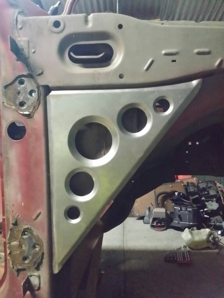

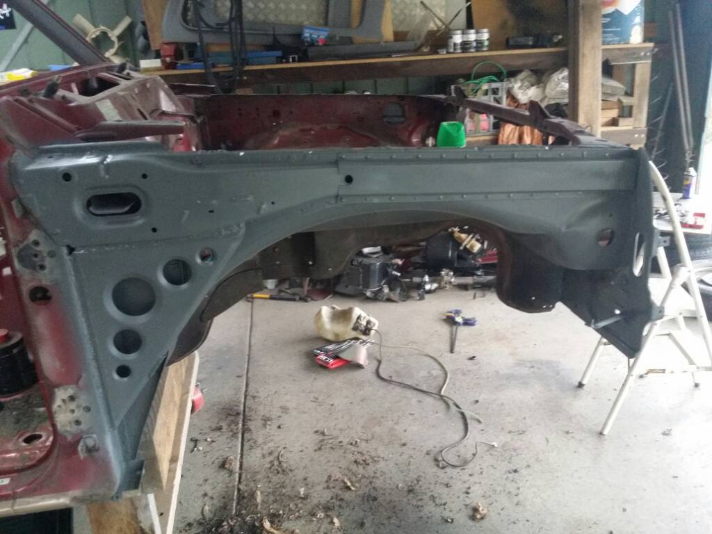

Got the brace kits installed too, look great. ☺

Rossco, are these braces installed to correct a weakness in the front guards or more a belts and braces approach since you had the guards off? If its a weakness, where does the vehicle crack and for what reason - is it hard driving or twisting or currugations etc?
Hey Phil, their made to correct a couple of weak spots really. Apparently they can come apart from the spot welds between the bottom of the A pillar and the front guard where they join. The long ones are to help with where they crack from the weight of the batteries, especially the aux side. Yeah my panel beater mate said GQs are weak as piss in that area. I think a combination of corrugations, hard hits and maybe older bodies & corrosion takes its toll. The guy that developed them is in SA (Pinaroo) and does a fair bit of outback touring so i guess corrugations would be a big one, they certainly seem to destroy a lot of things. . .

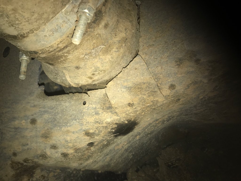

I might have a close look at this area on the weekend. Does the guard need to be off and where might I be looking specifically for cracks?
Have a look around the hole cut for a snorkel Phil, that's where they crack.

Andy, take a 6mm drillbit and drill a hole at the end of each of the cracks. This will stop the crack extending any further - it distributes the 'tear stress' around the circumference of the 6mm hole. From there I would make a rectangular splice plate and if you can only get to one side of the skin, drill and rivet it thru the two outer zones of the bodywork and also the torn flap. If you can get to both sides of the torn area, match drill two plates and drill and sandwich both the assy together. Keep your match drilled holes 'neat' with the bolts, say use M8 bolts and 8.5mm dia holes. I would use 4 bolts on the torn sections at both ends and 2 bolts on the flap section, so 10 holes in total. Its going to be a mission, but the tearing will then stop. You might need something like 40mm flat bar or whatever the flat zone is left for you to clamp thru, does not have to be thick, say 3mm would suffice and clamp if up tight. Stagger the holes on the end sections so they are not working thru the same line of action - helps with stress distribution.
