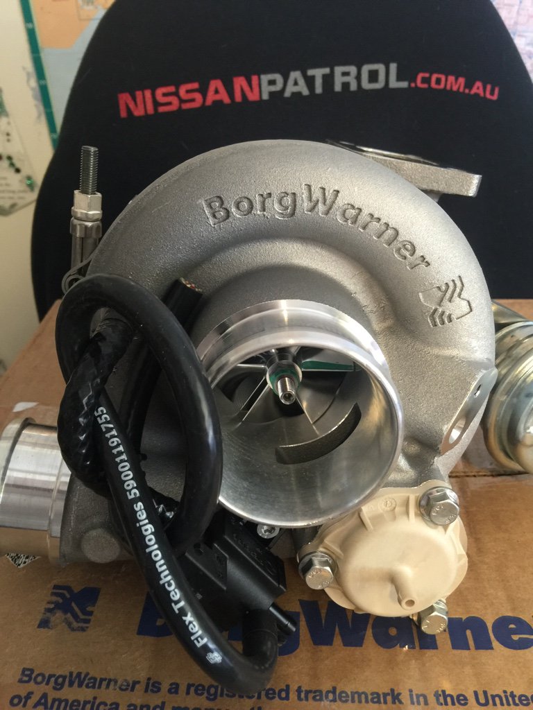

might have just bought a Borg Warner EFR6758...........
Thanks for your time Matty, legend mate. AB holy shit mate! lets do this!

Holy FARKEN Shit!!!!!

Whoah that was fast.
Nice one Darren! Your Mrs will be lifting wheels in the GU in no time!!!
Why did you get the 6458 rather than the 6758?
@nissannewby
Something I don't know about gents?????
So its a 6758?
@AB
http://www.nissanpatrol.com.au/forum...016/11/133.jpg
