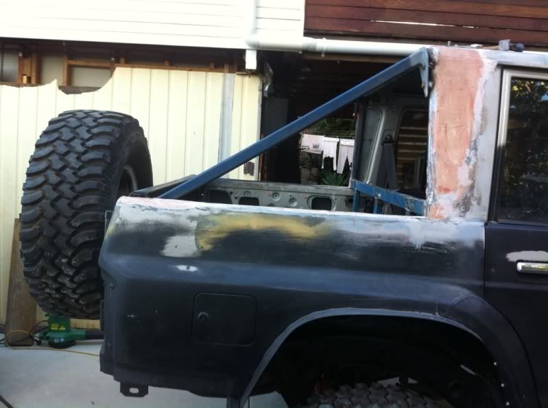

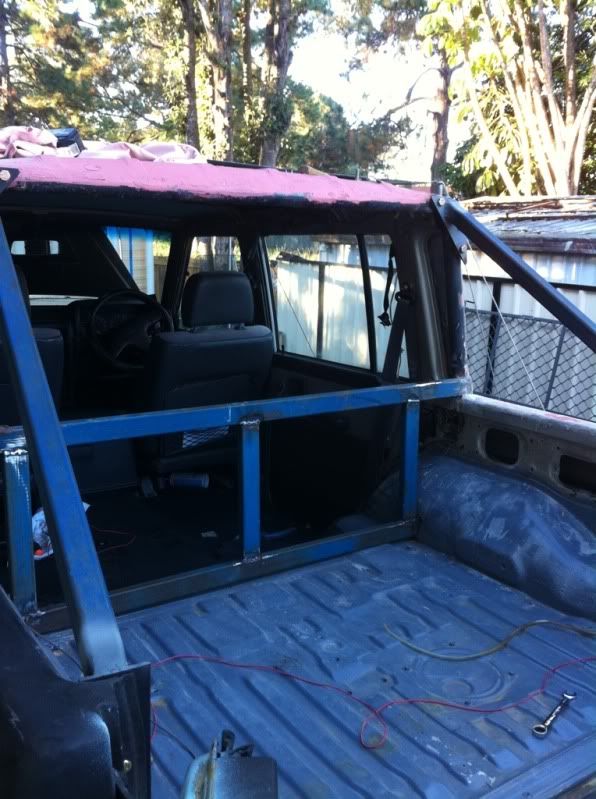

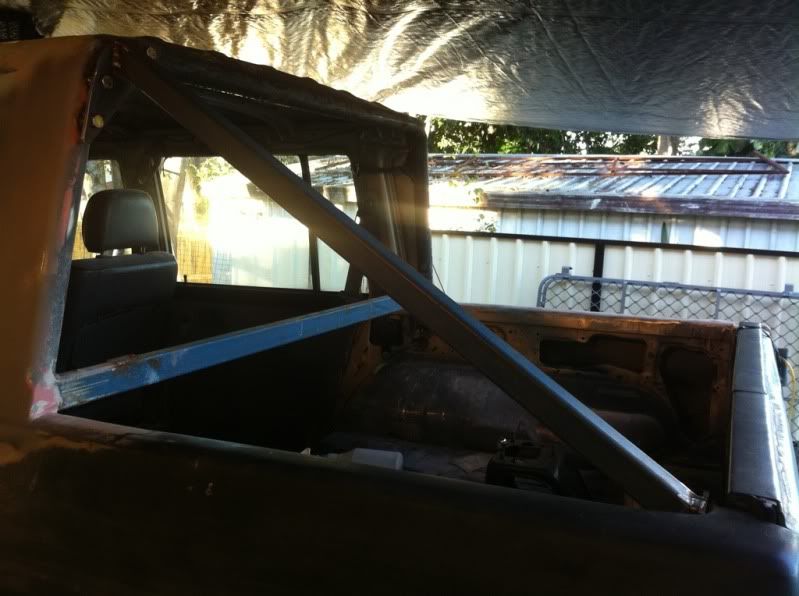

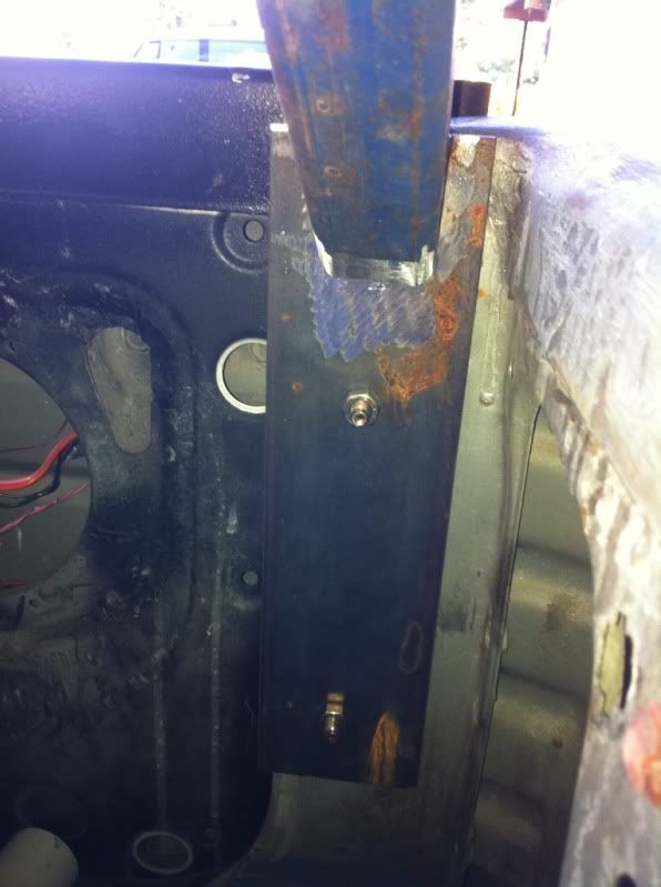

Started making up the rear bars today, got passenger side all welded up..

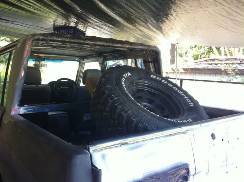

It's removable with 5mm plate, i used 40mm x 3mm square bar. Had it lying around the house so I thought I would used it up. Between the bars I will have the spare wheel ofset down into the tub....

Spare wheel will set up lime this.
http://i223.photobucket.com/albums/d...y/df46e9ba.jpg
Top effort mate!!!!
great stuff mate, definitley looking forward to seeing the end product
Looks awesome mate, can't wait to see how it turns out..
Make sure you keep us posted
Thanks guys, had a good day on the truck... Try and get the other side done tomorrow, then sand prime and pain again.
Getting closer and its feelin frigen good knowing that I can soon go for a wheel after so long.,,,
Mate shes lookin super super cool!!!!!!!!!!!!!!!
That will come up a treat mate once It's all painted up. Look forward to final shots mate!!!

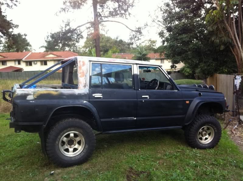

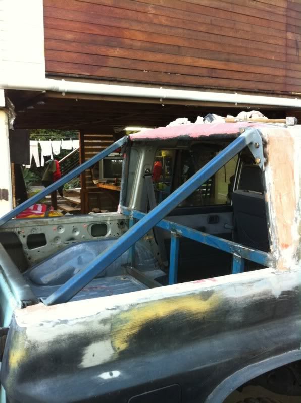

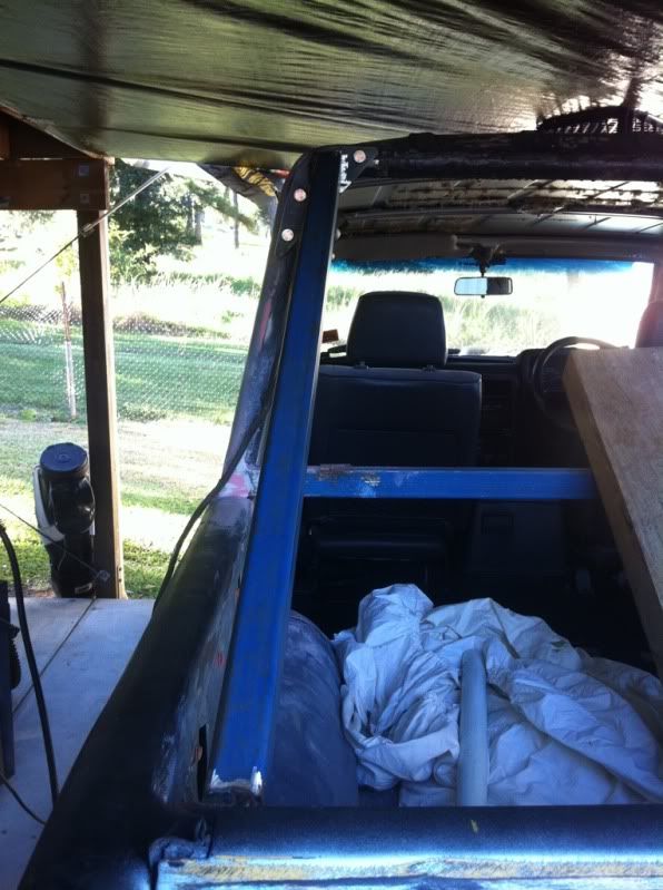

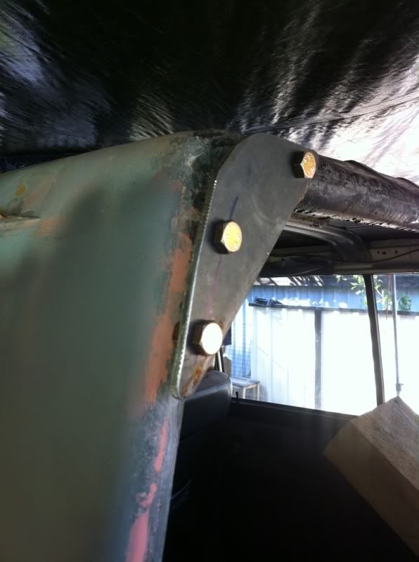

All welded up.. Rear bars done And frame. Now need some diabond sheeting for the back frame.
Putty and paint.
http://i223.photobucket.com/albums/d...y/3b766370.jpg
http://i223.photobucket.com/albums/d...y/b7b3ff79.jpg
http://i223.photobucket.com/albums/d...y/abfe45be.jpg
last pic shows only 1 rear bar but the passenger side is there and its spot on. Will be perfect for rear fast back tyre carrier
thats coming along nicely there mate
Shaping up boss!! Can't wait to see the progression!! Keep the happy snaps coming ....

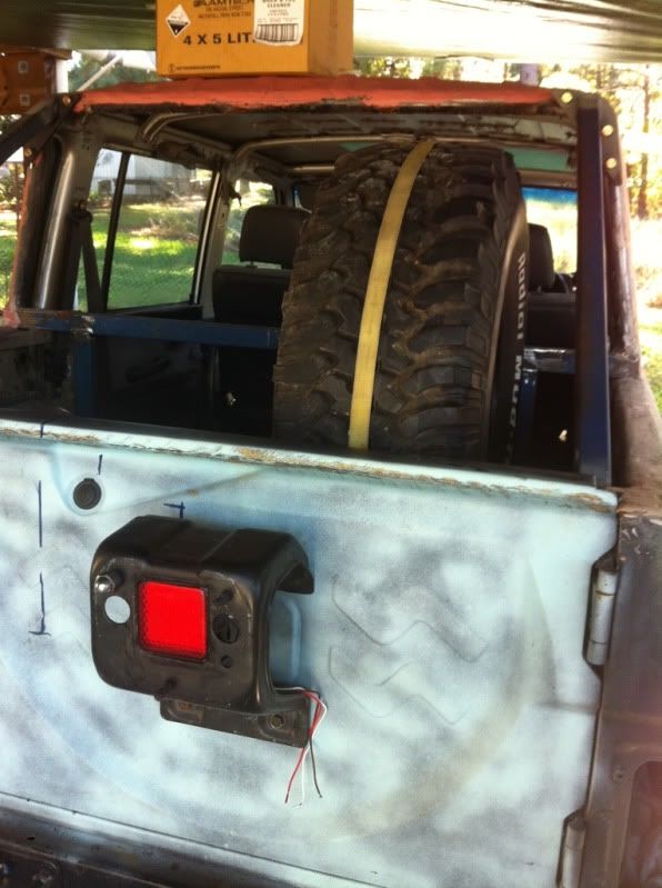

putting in a rear brake light......
Its painfully slow with work/house reno's... Battery is flat and pretty much dead... Good excuse to get a optima fully sealed big cranking battery

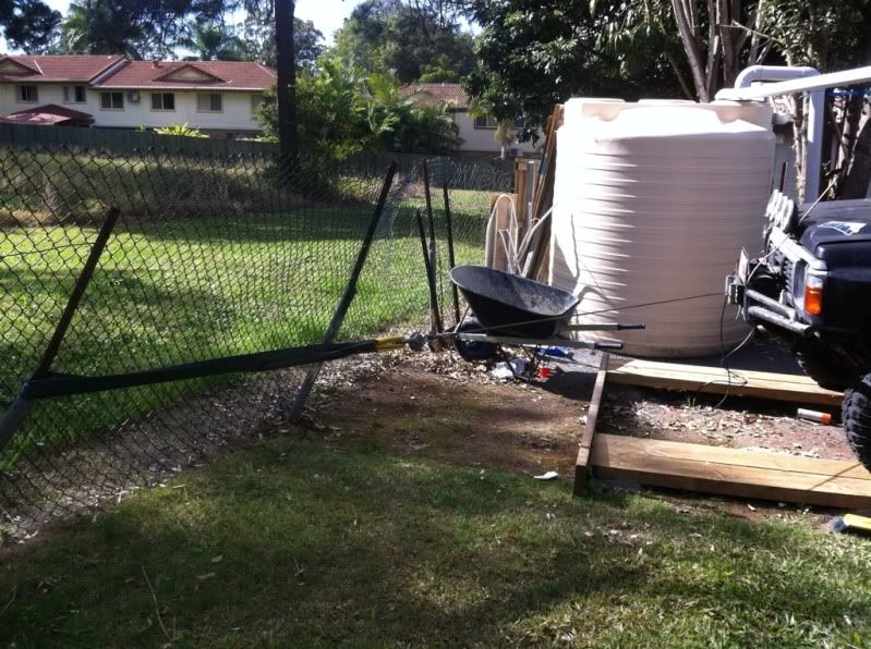

Thought I would post some pic's I just took of the car sort off road for the first time In ages. I was trying to winch and snatch the old fence post out. Not even budging, I was even wincing if them. The best cheapest fence going around.
