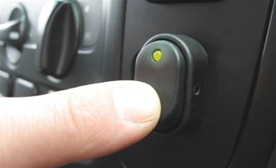

I'll have to take a pic, but I got a switch under my fuel cap opener lever. Pressed it didn't seem to do anything, looks like a black light switch but a bit rounder
Like this one http://www.nissanpatrol.com.au/forum...014/09/120.jpg

The mystery button. Any ideas? Yes I've pushed it :)
The Projecta 100amp
Annd what's this for???
Trace the wires from the switch and see where they go? Maybe the battery isolator override? Hear any relays when it is switched?
I think the 2nd switch is the engine idle up switch used to warm the motor up quicker? Have you pressed that one?

As Winnie said, the switch on the right is a fast idle switch, it is disabled as soon as you accelerate.
The switch under the fuel cap release could be for anything, usually a blank hole there.
Yeah I reckon it might be to link batteries. What Winnie said trace the wires should solve it.

Agree with shitbag, it's the override switch and the idle up switch:)
The idle up will disengage as soon as you put it into gear and then stop working when temp is up
Manual override(this is from their website, I'm not that cleva)
Manual override is activated by connecting the override
wire to 12V DC. This bypasses the automatic voltage sensor
allowing the relay to be engaged below the set voltages.
