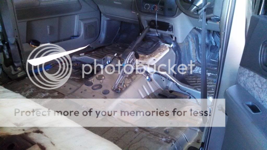

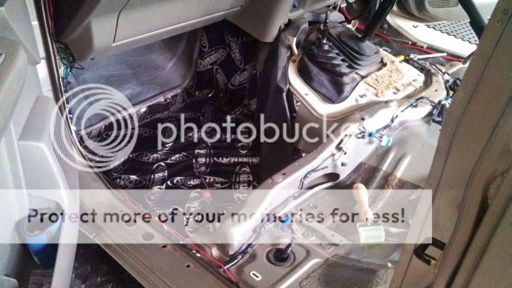

Starting with the floor in the front of the GU...
http://i935.photobucket.com/albums/a...psbjbms9oj.jpg
http://i935.photobucket.com/albums/a...psnimsmdz6.jpg
http://i935.photobucket.com/albums/a...psg5i0n3f7.jpg
http://i935.photobucket.com/albums/a...ps3gbumzr9.jpg
I actually did right through and under the seats but that is as far as I have gotten so far.

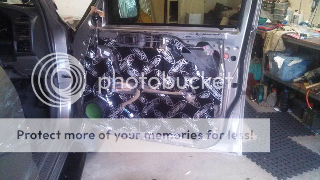

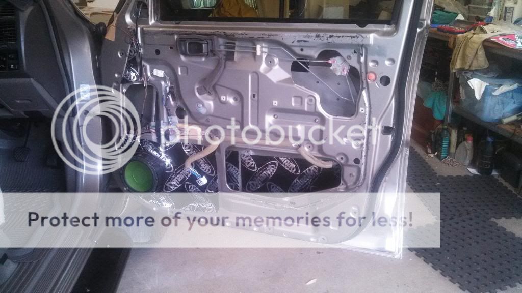

Drivers door.... basically covered probably 80% of the outside door skin wherever I could, and then most of the inner door. I would like to cover as much of the hole where the door lock rods go through but am out of dynamat at this point in time. Have also done the outer skin of the passengers side door but that is it.
http://i935.photobucket.com/albums/a...psjvfksiel.jpg
http://i935.photobucket.com/albums/a...ps1b6qlaxh.jpg
http://i935.photobucket.com/albums/a...psektppvld.jpg
Hopefully I can finish the doors and the floor in the middle seat area sometime soon.
Put the door trims back on and took it for a drive this arvo. Fantastic improvement in sound from the drivers door, and in general from the install so far. I didn't go ballistic on the firewall as I decided not to take the dash out yet like you blokes did. All the same, very happy with it, so thanks for the tips to start with from yourself and Parksy that gave me the motivation in the first place.
